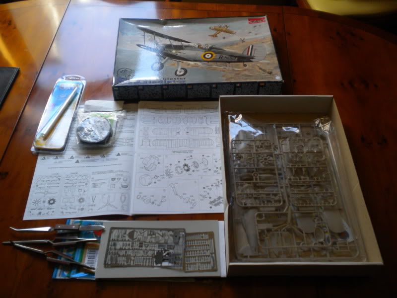

delta7 Posted May 22, 2011 Posted May 22, 2011 (edited) this will be my next project .... should be interesting , and slow , as Iv never rigged a biplane before and the parts are really small I have bought the eduards etch, which is also tiny and some tools to help Edited July 28, 2011 by delta7

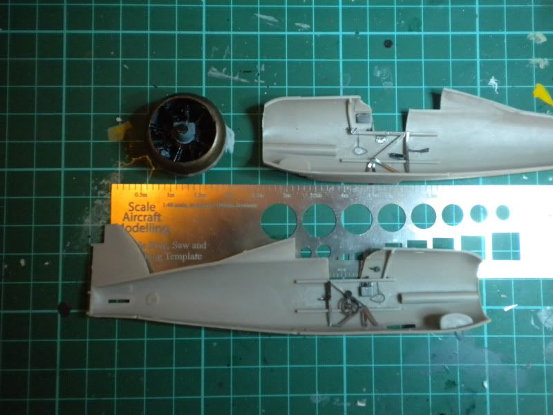

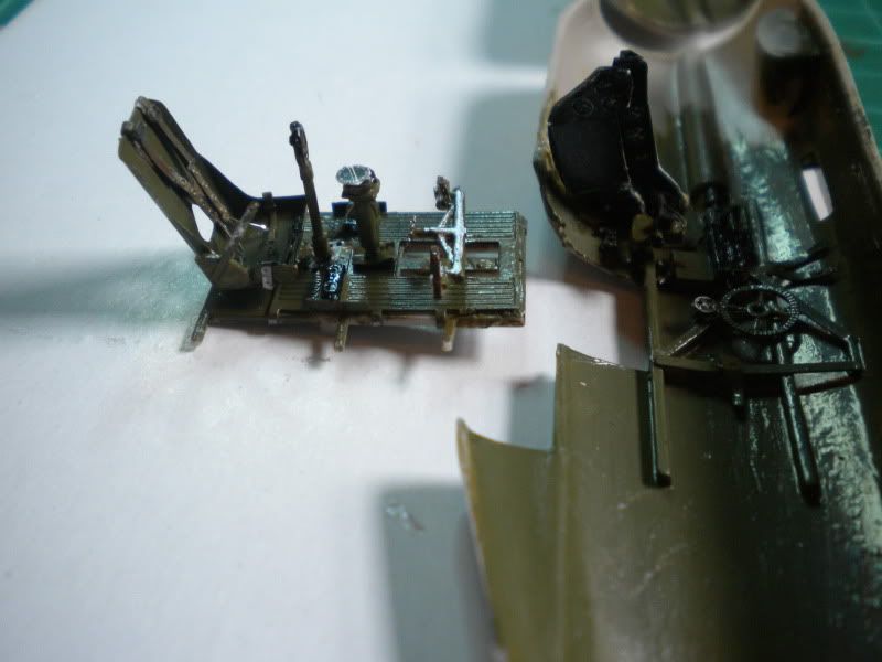

delta7 Posted June 10, 2011 Author Posted June 10, 2011 (edited) small update I have built the engine and cowels, but had major problems with the exhausts onto the cowel, these are individual pieces, 2 per cylinder and happily ping apart when you try to inset the engine into the cowel- Im going to feed them in from the front and glue them in place that way the cockpit walls have had the eduard etch added - to show how small everything is Iv added in the ruler Edited June 10, 2011 by delta7

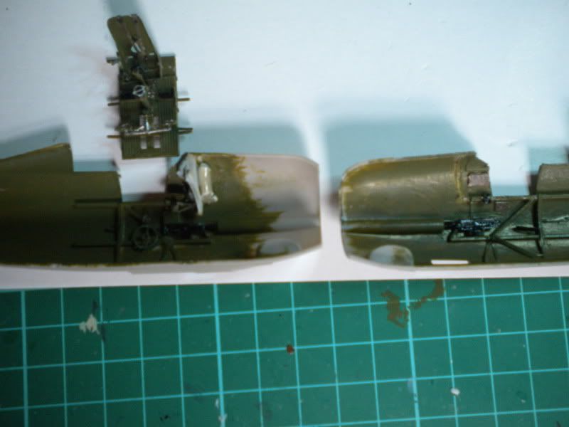

delta7 Posted June 15, 2011 Author Posted June 15, 2011 (edited) cockpit completed- had to do a lot of fettling to get the instrument panel to fit, added a bit of spare spuce at the back to give it some strength Edited June 15, 2011 by delta7

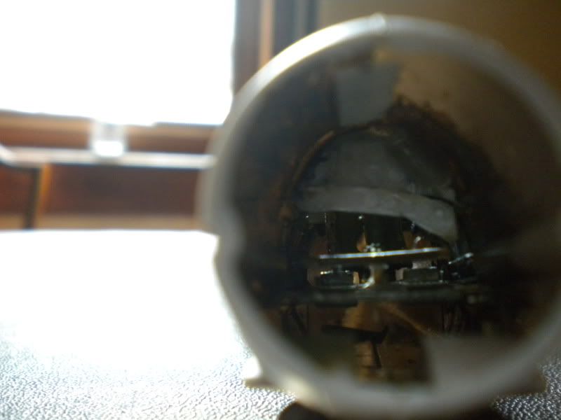

delta7 Posted June 15, 2011 Author Posted June 15, 2011 (edited) Thank you guys- I am trying to follow the advice given here http://modelingmadness.com/reviews/allies/gb/cleaverglad.htm http://www.kitreview.com/kitreviews/gladia...ireviewbg_1.htm The major problem with the kit os lack of location points so fitting is tricky, a case of dry fitting repeatidly until happy I would say that the eduard etch is a worth while investment as some kit parts are poor and some are oversize In order to get the cockpit floor to fit I glued the etch to the reverse side of the kit part, it was meant to replace, and this gave better fixing points- one tip- the floor fits above the horizontal spar and care has to be taken with the etch parts on the side walls so that they dont interfere with the locating points. you can see in the pics above that I had to cut one leg off the left hand side as it interfered with the wheel I have joined the halves together and to help I made locating tabs from scrap plastic sheet, the white one is more visable in the picture , there were 2 on the lower fuselague, one at the rear and one in the front, these were painted green to match the pit but arnt visable anyway Edited June 15, 2011 by delta7

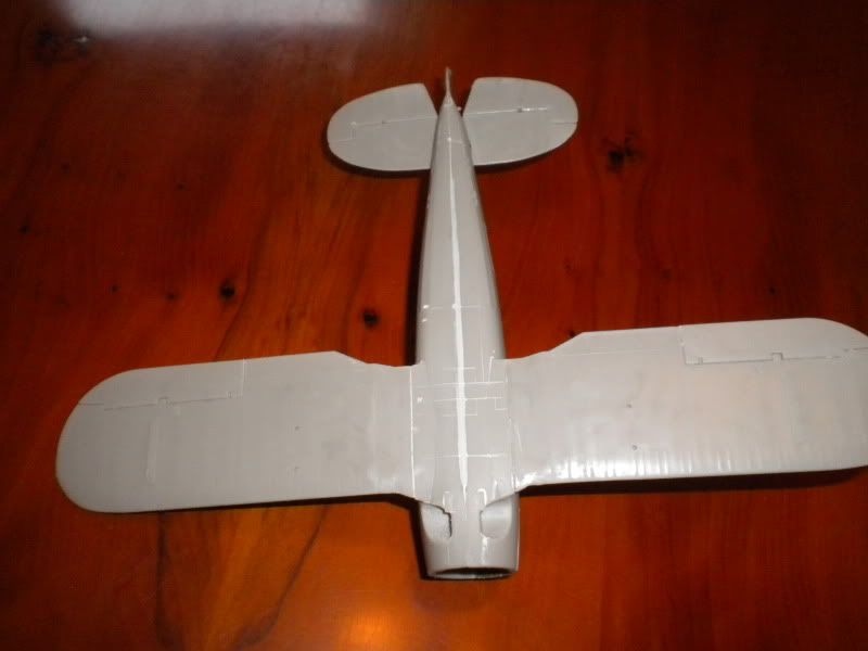

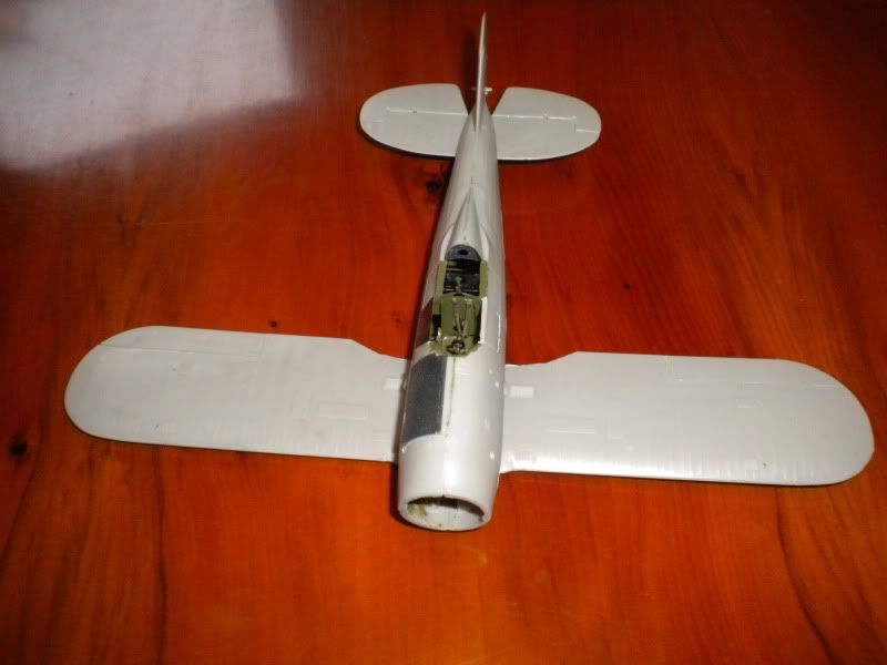

delta7 Posted June 16, 2011 Author Posted June 16, 2011 some more today, filled and sanded the bottom join ( I use halfords filler) added some external etch and the lower wings and tail section, opened up some holes for struts main asemblies were a nice fit with very little gap I have futured the canopy and will mask and add that soon then give everything a undercoat of halfords finest grey @tonyot - that is a great plane you have done and something I hope to be able to do sometime, my skills are still a bit basic and Im going to take easy options, so I wont bother too much about the tail hook, the eduard etch set has parts to spruce it up but it will sit external. There are sink marks, I hadnt spotted them until you pointed them out and some mold marks but I hope the paint will cover these
bigbadbadge Posted June 16, 2011 Posted June 16, 2011 Looking good, built a Mk1 Gladiator some time ago with the eduard bits, very enjoyable build and went together well Rigging not too bad either, keep up the good work. All the best Chris
tonyot Posted June 16, 2011 Posted June 16, 2011 To be honest you would be better off filling in the sunken mould lines on the fuselage as they show up through the paint and I wish I had done that on mine! Why not brush on some paint now to see if you can live with the sink marks if you are not sure about filling them first? Glad you liked my model too by the way but I`m sure yours will be just as good if not better, All the best Tony O

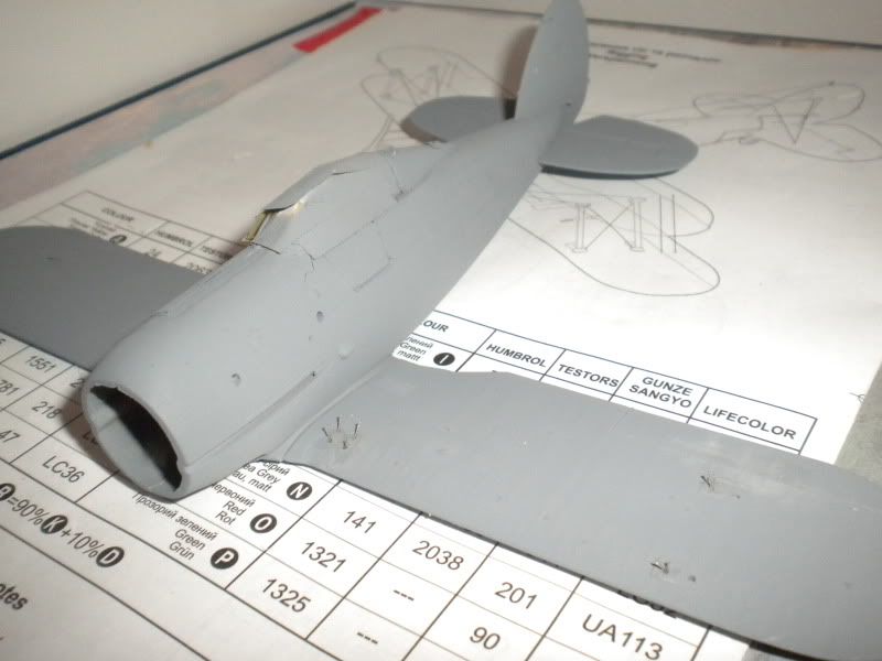

delta7 Posted June 25, 2011 Author Posted June 25, 2011 (edited) After looking at various options for rigging I orderd up some " Bobs buckles" so after priming the kit I have been drilling and fitting these The rigging line will be superglued to these, excellent service by Bob !!! it is slow going as my eyes can only take so long working with such small parts before I need to take a break The lines on the fuselague caused by the mold arnt so noticable after the primer so Im going to leave filling these, I think I would do more harm to the fine detail than I would gain Edited June 25, 2011 by delta7

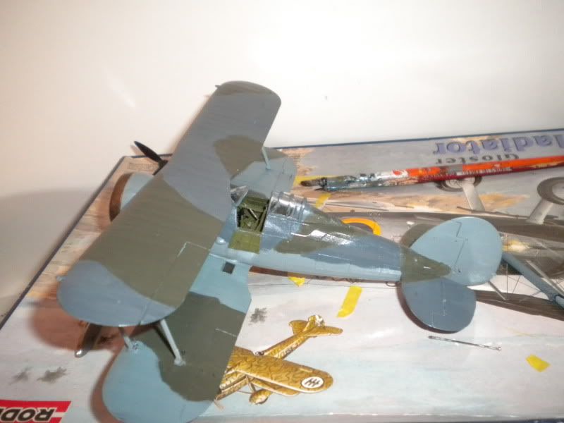

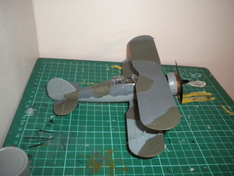

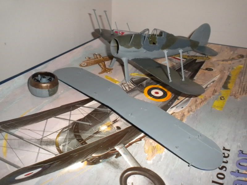

delta7 Posted July 6, 2011 Author Posted July 6, 2011 (edited) The struts are on and paint done top wing on to show how she will look, not glued yet I need to varnish it and do some minor touches then Ill fit the top wing , I plan to tape the top wing , upsidedown to my cutting board and then lower the kit onto it to help with alignment. All the location holes have been widened to help. Then rigging. Edited July 6, 2011 by delta7
Killingholme Posted July 6, 2011 Posted July 6, 2011 Looks good especially the cockpit with all the etch. Is the 'shadow' scheme 'upside down' though? I thought the darker colours went on the upper wing the lighter on the lower? Will
delta7 Posted July 7, 2011 Author Posted July 7, 2011 DOH you are right - it should be extra dark sea grey on top ( which it is ) and dark sea grey on the bottom , I have checked and I used the wrong bottle for the base. I will redo this in a lighter shade thanks for spotting this
Killingholme Posted July 7, 2011 Posted July 7, 2011 DOH you are right - it should be extra dark sea grey on top ( which it is ) and dark sea grey on the bottom , I have checked and I used the wrong bottle for the base. I will redo this in a lighter shade thanks for spotting this No probs. I work mainly in artificial light, and I find the swatches on the tops of pots of EDSG, DSG, etc etc all look exactly the same... Will

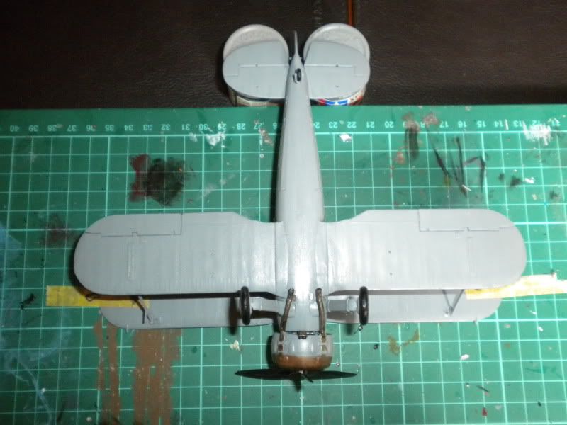

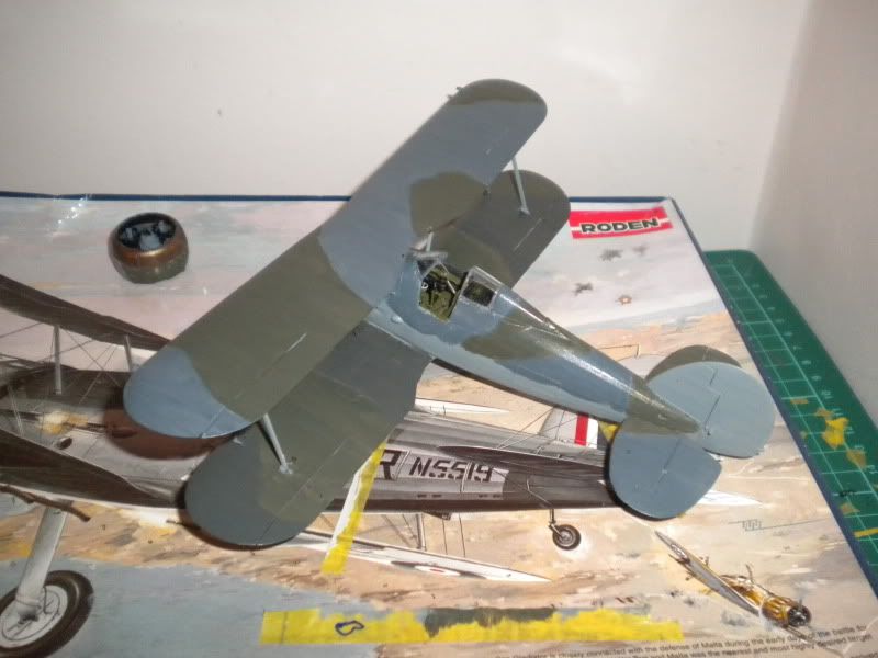

delta7 Posted July 13, 2011 Author Posted July 13, 2011 (edited) decals have been sourced and should be here next week, in the meantime I driled out the exhaust ports on the cylinders and fitted the pipes, fitted various other pieces and repainted the lower wing the upper wing isnt glued on yet its just placed for show Edited July 13, 2011 by delta7
delta7 Posted July 18, 2011 Author Posted July 18, 2011 (edited) back on track - top wing fixed and decals arived today only problem is that the colour scheme calls for black/white on undersides but I think Im just going to ignore this and stick with the light grey Edited July 18, 2011 by delta7

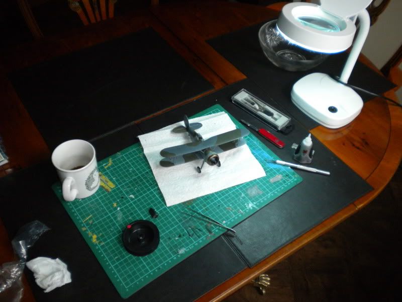

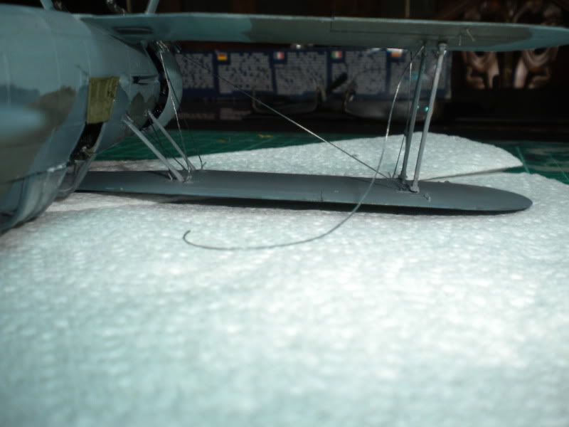

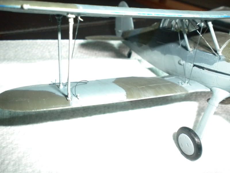

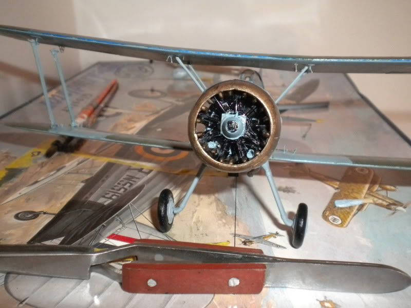

delta7 Posted July 21, 2011 Author Posted July 21, 2011 (edited) rigging my setup = coffee is a necessity put a touch of glue on a buckle and attatch one end of the line turn upside down and repeat on opposite end, let to set then trim ends involves much tweezering and footering and shouting but it works Edited July 21, 2011 by delta7
