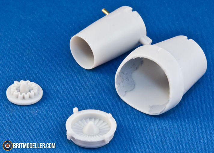

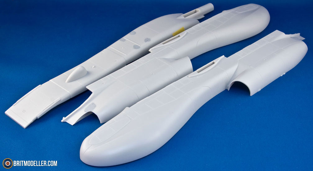

Mike Posted October 31, 2010 Share Posted October 31, 2010 While writing the review for this one, here, I didn't think it'd be long before I succumbed and built my second UAV following an enjoyable build of the Bronco Predator back in April this year. I cut the fuselage halves from their sprues and test fitted them and the underside "tray" in place, which revealed a couple of places where some fettling will be needed behind the wing. There's an area of rough tooling where the underside bulges out to meet the fuselage sides. I fitted the engine bay inspection covers, which can go in either way, but from photos, I found that the smaller rivets go toward the back of the airframe. I scraped the mating surface to ensure a good level fit, as there's not much in the way of raised panels on the real thing, and flooded the joint with liquid glue from behind, applying pressure to help with the fit. I slapped a bit of putty on the sink marks under the fuselage, at the rear of the exhaust area, and finally around the thick upper edge of the intake lip. Again, those will be sanded smooth tomorrow (all being well). The intake/exhaust parts are very usefully made, and construction and painting will be a doddle because of this. I will paint the engine faces separately, the intake trunking will have a rough coat of Lifecolor dark grey (FS36118), which will be blended into the outer coat when final painting takes place. The exhaust sits within a shroud for most of its length, with only a little poking out at the rear. That will be painted, then masked over to protect it from the main paintjob. The brass rod you can see on the exhaust is a replacement for the plastic rod that fell off when I cut the part from the sprue. I must remember to be more careful Next I broke out one of the wings, and test fitted that together. There's a little gap under the wing root where the lower is slightly shorter than the upper, so I bonded a strip of styrene sheet with a good dose of liquid glue and some pressure. I'll sand those down in the morning once the glue has cured. The attachment tabs were attacked with a Dremel, making the holes into slots, and it sanded so that they were a snug friction fit. A test installation showed that they fit nicely, and without any droop, other than that engineered into them by the Skunkmodels people. Looks like it'll be easier to store than I initially thought Link to comment Share on other sites More sharing options...

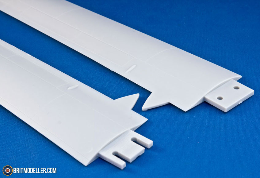

Mike Posted November 1, 2010 Author Share Posted November 1, 2010 What's the wingspan on this Mike? 83cm! The cutting of the slots in the wings makes the job so much easier though - you could even display it with one wing off to save a bit of space Link to comment Share on other sites More sharing options...

Mike Posted November 3, 2010 Author Share Posted November 3, 2010 I've been looking at the fuselage parts and comparing them with the pics available on t'internet. Although the gross outline seems to have been captured pretty well, there seem to be a few panel lines that are either missing or in the wrong place. The red squiggles are where a line needs removing, and the green ones are where I need to add a line. The raised area on the underside behind the wingroot also extends too far aft, so in an ideal world could do with adjusting, but as it's a complex shape and intersects with a large sensor blister, I think I might have to leave it Link to comment Share on other sites More sharing options...

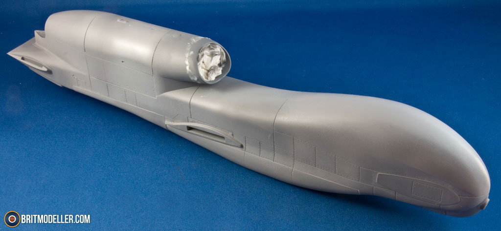

Mike Posted November 10, 2010 Author Share Posted November 10, 2010 The fuselage has been built and the panel lines removed and adapted as per the above (although I've yet to rescribe one - see if you can spot it ). I've been working on the seams, as the smooth finish will really show them up once painting begins. I've also painted the intake & exhaust, protecting it all with screwed up tissue and tape until the painting is over. The pic shows a layer of putty along the seam between the intake lip and the intake trunking, as this part is seamless too - I guess it must be made from carbon-composite with a fancy shape like that Link to comment Share on other sites More sharing options...
