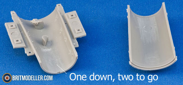

Mike Posted April 18, 2010 Author Posted April 18, 2010 I installed the pit today holding it in place while applying some low viscosity Filla-glu CA that wicked itself into the gaps. The intake halves were left overnight with some Milliput sausages pressed into the seams, then smoothed with sculpting tools and wet cotton buds. This morning I applied my collection of Heath Robinson home-made sanding tools to the joints, spending a good hour smoothing things down & polishing out as much of the scratching as possible. A quick squirt of Mr Surfacer followed, and once that's dry I'll inspect my work & get on with sanding stage 2 as required.

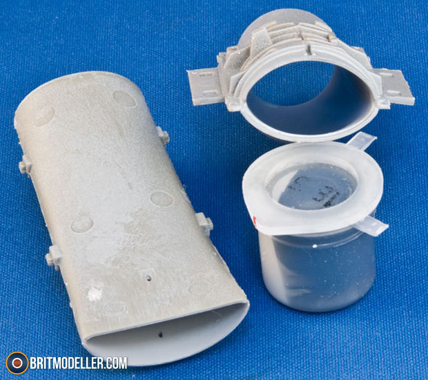

Mike Posted April 28, 2010 Author Posted April 28, 2010 After a bit of a hiatus, some white paint for the interior of the two sections of trunking, I added in the detail parts for the MLG bay, scraping away the original squirt of white paint where necessary. I glued the rear stage into place last night leaving it to set up with the aid of a couple of Berna clamps applying downward pressure to the mounting lugs. I also added the skin to the front section, which took a bit of trimming to get the joints neat before I could glue them together. Don't waste any time cleaning up the upper joint, as it gets hidden when you install it, so that leaves you with about 1cm of joint for the whole section... a bit of CA and some careful sanding, and I'm left with one oblong panel that needs the detail reinstating. Next job will be to secure the front intake trunk out of the instruction sequence, as I think it would be easier to do before I close up the fuselage. We shall see

Mike Posted April 28, 2010 Author Posted April 28, 2010 Cheers Pete... almost OOB. I just added a small strip of brass to that oval "tank" in the gear bay, as it was easier to sand off the original while removing the seamline & replace it later

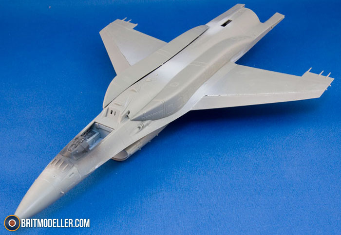

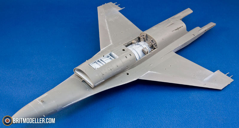

Mike Posted May 4, 2010 Author Posted May 4, 2010 I thought it was about time I updated this one. Sprue U arrived from LuckyModel this morning, so big for some great service I decided that attaching the front intake section before joining the fuselage halves would be a good idea, and it was. I needed to fettle it a bit to get a snug fit without distorting other parts - I think I also left the front gear bay bulkhead a fraction of a degree out of perpendicular, which required a quick drift with a sanding stick to sort. Being able to use several clamps to hold it in place while it set up was very handy too, so I'd encourage any builders to break step with the instructions at this point. Joining the fuselage halves wasn't too tricky, but I always have a faff with my Berna clamps, which like to ping off if you don't get both jaws 100% square to eachother. Once that had set up I added the wing leading edges, which revealed a slight gotcha on the wing root leading edge. They seem a little "deep", and that's left a slight gap where the leading edge parts fit. Nothing too annoying, and a bit of Vallejo filler should cure it, but one to check when you're building yours I'd previously filled the nose cone with some left-over Milliput and lead(free) shot, so that little package was added, together with the two side panels that help hide the most prominent part of the seamline. These bits didn't even need any filler, they're such a snug fit The rest of the seam is on the underside of the sharp demarkation between top & bottom, and of that only the first inch or so needed any putty, and only a small quantity at that. A touch more filler was used behind the wing root, but I'm not sure that will be seen once the flappy parts are added, so it's precautionary at the moment. I've started work on the exhaust, and you'll need to take care here, as the instructions mention a sprue that's not included in the kit, and the numbering is off too I ended up choosing the parts that looked like they should be used, but there's a chance I got it wrong - hope not, as there weren't any other alternatives! I sprayed the rear of the turbine face and afterburner ring with Alclad Pale Burnt Metal, which I then tinted with Alclad's Hot Metal Sepia, and a brush with some Mig pigments to dirty it down. The interior of the exhaust trunking is made of 2 halves, leaving a prominent seam down the ribbed "tube". I applied a bead of Vallejo putty to the joints with the long applicator you get on the tube, let it dry for 24 hours, then trimmed the majority of the excess away. I ran my scribing tool laterally to remove the putty from the grooves and sanded things smooth. Not perfect, but under a coat of Lifecolor white and some Mig pigments, it looks ok I googled up an image looking up the pipe as I've not had to weather a modern jet yet in my short modelling career, and applied some Black Smoke and Tracks Brown pigments as close to that as I could, and fixed them with a coat of Vallejo matt varnish. Here's the resulting job:

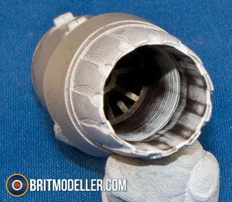

daz greenwood Posted May 4, 2010 Posted May 4, 2010 Looking good Mike! And from what I've seen of modern Jets, that engine looks spot on!
Mike Posted May 4, 2010 Author Posted May 4, 2010 Cheers fellows.... I'm on shaky ground here, as this is my first modern jet if you exclude the Hawk I did a few years back
