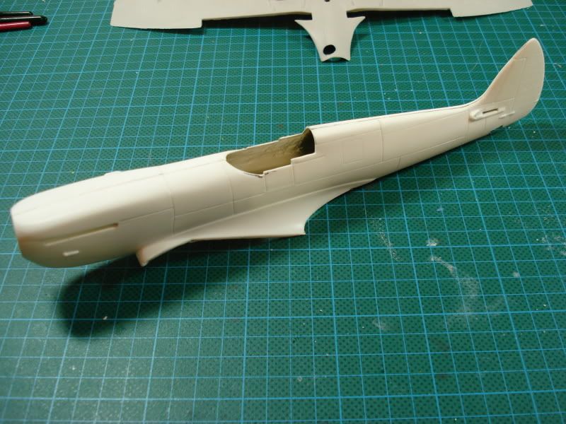

Notdoneyet Posted May 6, 2009 Posted May 6, 2009 (edited) Hello all! Here is my (first?) entry in this GB - the Falcon PRXI conversion from their 3-in-one Spitfire conversion sheet. I'll be using the Airfix MkIX as the donor for the wings and tailplane and perhaps some aftermarket stuff if I don't make a hash of the vacform bits ..... Speaking of which, this is my second attempt at a vacform, the first being a 1/72 scale Bucker Jungmeister that I attempted in the early 70's. The abandoned banana shaped remains of my attempt to build the kit languish to this day in my Mum's loft in the U.K. Using John Adams' excellent guide as my "bible" I've hacked out the fuselage halves and sanded them down. Amazingly everything fits together rather well :- I've started work on the wings - these have required far more work than the vacform fuselage so far. Here's where I'm at with them after the first round of thinning, sanding and filling. More progress(?) soon I hope. Ian Edited September 4, 2009 by Notdoneyet
