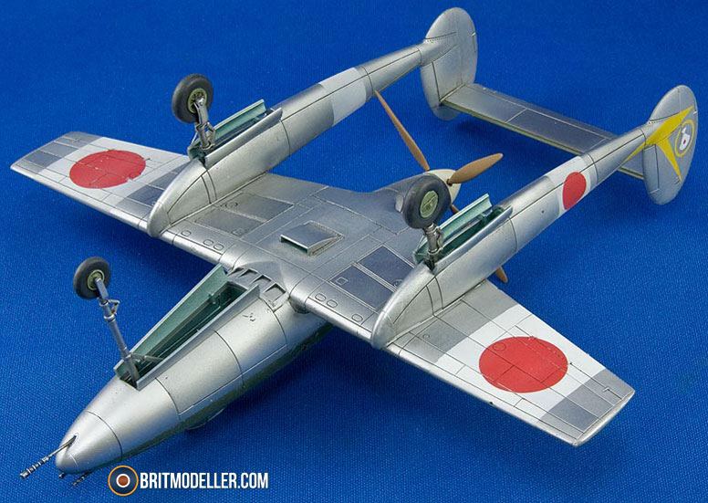

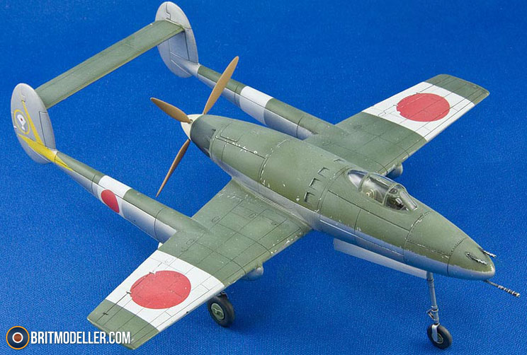

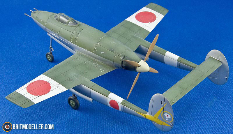

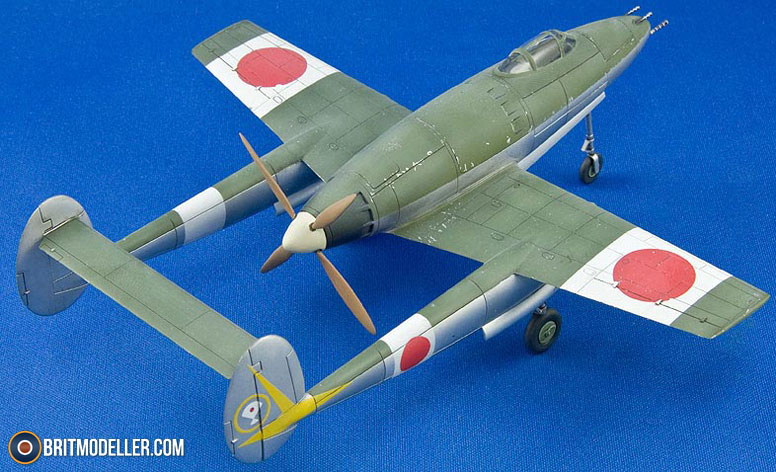

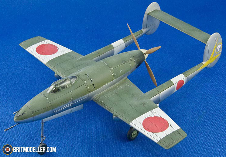

Following my review here and my build here, I'm pleased to present this new kit from Meng in its finished form. It was built from the box with the exception of some Tamiya tape seatbelts and lead wire for the brake lines on the main gear. It was painted in Alclad metallic shades, and Lifecolor RLM82 (UA054), which does a creditable job of Nakajima Green. The white ID bands are Alclad White Primer (I seldom use anything else for white these days), and the decals are from the kit, going down very well with a little Mr Mark Setter. Chipping was done with a toothpick on the freshly painted Lifecolor green, and exhaust staining was done with Alclad Transparent Smoke, flatted down with Alclad's excellent Klear Kote Flat varnish.
The kit is a lovely little thing, and builds up quite quickly with only a few areas to watch out for. The nose cone needs careful fitting and fettling, as does the prop boss and the underside wing joint. Other than that, I think I only used CA as filler on the underside wing joint, the rest going together without the need of filler. The transparency is very thin, so be gentle with it. The same can be said of the nose gear leg, although I managed to resist breaking mine so far (famous last words).
Overall, a thoroughly enjoyable project and a highly recommended kit ^_^

Thanks fellas... I forgot to add the pitot probe! :doh: I cut a short length of scale calibre from my stock and used that, leaving it bare metal. The model is now in my cabinet :)

Very strange, but there's something I like about it. Done a cracking job there Mike, love the faded look on the top surfaces. That nose wheel looks like it could of been problematic in real life !!
