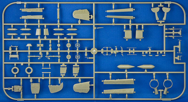

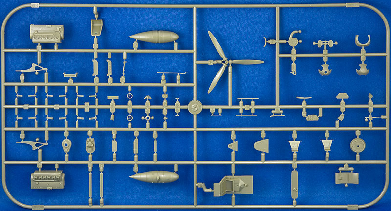

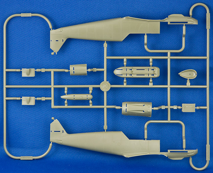

The Profipack edition arrives in a substantial top opening box with a handsome painting of an Emil stalking a British Blenheim amongst broken cloud. Inside are four sprues of olive styrene, bagged in pairs in re-sealable bags. The clear parts are bagged in a ziplok type bag, as are the Photo-etch (PE) parts, and the kabuki tape masks. The decals consist of two smallish sheets, and the large instruction booklet is in full colour, although there is a small errata sheet included for the engine to correct the omission of a part during construction of the horse-shoe shaped oil reservoir.

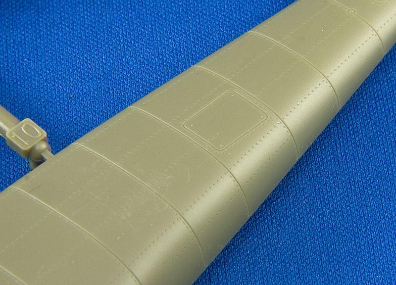

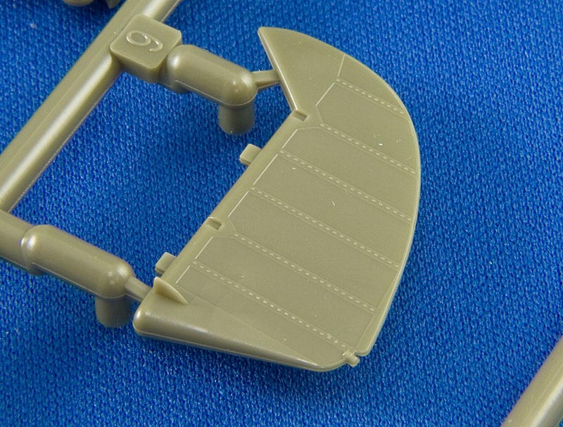

First impressions are very good. The detailing of the airframe is exceptional, and a huge number of the tiniest rivets cover the outer skin, which will please (or disappoint) a friend of mine that is currently obsessed with riveting his builds. Their finesse is superb, and couldn’t be equalled by mere mortals with a pounce wheel or similar – in fact, my fingertip barely registers their presence, they are that fine. This detail extends to every part of the outer skin, from the tail planes to the finely detailed rudder, and this will all look stunning under a few coats of paint, which I suspect will render the rivet marks as tiny sink marks on the surface, very similar to a flush-rivet at full scale.

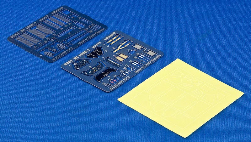

The build should be simple, although the cockpit has a large part count, with plenty of PE parts to detail it up. The instrument panels are provided as either a PE lamination on a blank background, or as styrene parts with raised instrument panel detail. If PE isn’t for you, there is a fall-back position. Seatbelts, pulleys and various knobs and levers are supplied in PE, as well as a pair of PE rudder pedals to replace the (very nicely moulded) styrene parts. The majority of the cockpit PE is pre-painted, so after a squirt of RLM02, the cockpit should literally fall together. The upper portion of the instrument panel is installed later in the build, along with the upper gun bay, and gets the same treatment.

Forward of the cockpit, the oil cooler assembly has a full trunk, separating it from the engine compartment, and here the radiator fronts are supplied as PE parts, with a styrene core and rear spoiler. Above all this installs a rather well detailed DB601 engine, with exceptionally well detailed styrene parts, augmented by PE parts from the unpainted fret. Individual exhaust stacks are provided, and these have a recessed opening, which will give the impression of being hollow with careful painting. The engine bearers are well done, and attach to the bulkhead, with ancillary struts helping support this large block. Some element of hose-work is supplied, as well as the ignition harness for the 12 cylinders, but if you’re planning of leaving the engine exposed, some additional wiring would improve the look further.

Next are the tail feathers, with the elevators supplied as single parts, requiring the modeller to mobilise them in order to depict them offset. The rudder is a separate part, so can be posed at a more candid angle if you so wish, and the assembly is completed with a pair of slim struts to brace the elevators, which have sturdy and well moulded sockets in the form of the end fairings, and a PE actuator wire for the rudder.

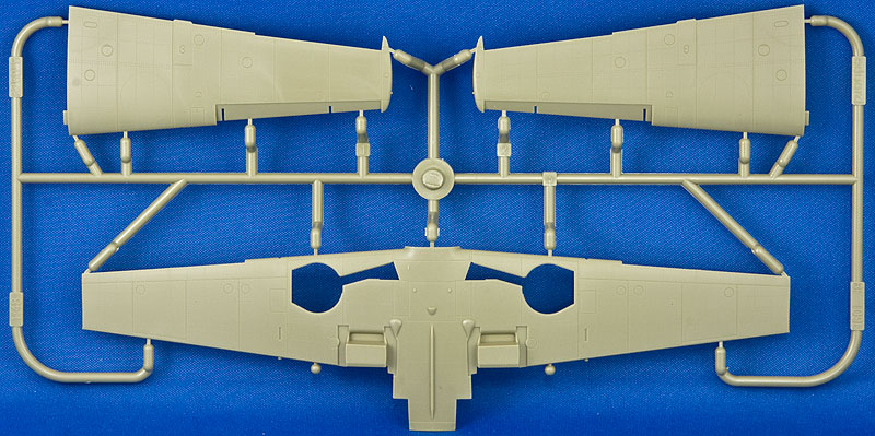

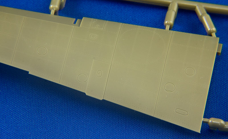

As expected, the lower wing is a single part, with a pair of inserts making up the wheel bay sidewalls, and the two-part upper wings having fine raised detail on their underside to portray the roof, and very nicely done they are too. Eduard suggest that the wings are built up as a unit, and offered up to the underside of the fuselage, but test fitting might be advisable here, to ensure that the important wing root joint is good. The ailerons and flaps are supplied separately, so can be posed at any sensible angle, with their attachment tabs supplying some strength to the joint. The leading edge slats are also separate parts, and are posed open (due to gravity) on the ground, or closed in flight. There is no detail on the slat bays, but very little would be seen anyway, so this shouldn’t be an issue.
As mentioned earlier, if the engine is to be exposed, slight differences in the build will be necessary so that everything gels together. A little care and planning will be needed here to avoid mistakes. The cowling parts are necessarily thick to facilitate their use in the build if the model is being portrayed “buttoned up”, but if they are to be left in the vicinity in a diorama setting for example, some of the panels or at least their edges will need thinning to a more realistic thickness for extra realism.

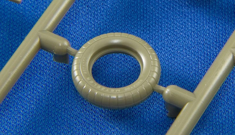

The main landing gear is nicely detailed, although the oleo struts are moulded in situ, and the seams will need some attention before painting. The wheels and hubs are separate parts, and the level of detail on the tyres is impressive, showing the maker’s mark in incredibly fine raised markings. The hub has a spoked front part and a flat rear with further detail etched into it that will show through the spokes. There are no flats moulded into the tyres, but that can quickly be remedied by a few swipes with an aggressive sanding stick.
A small louver is added to the intake on the oil cooler, and the underwing radiator housings are nicely detailed with rivets, with the tear-drop profile outlet ramp attached to the underside of the flaps. The horn-balances on the ailerons are added late in the build, as is the wing-mounted pitot probe, all of which are very crisply moulded, showing great attention to detail.

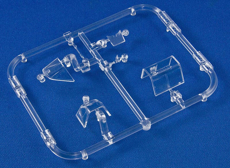

The clear parts are up to Eduard’s usual standards, and the usual three glazing parts of windscreen, canopy and fixed rear portion are included, plus a piece of armour for the windscreen. The flat panels aren’t quite as good as the curved parts for clarity, so a dip in Klear or Alclad Aqua Gloss would be advisable. The head armour part affixes to the canopy, and thankfully, a PE retaining strap is supplied to stop the canopy and add a little realism. Well done Eduard!
