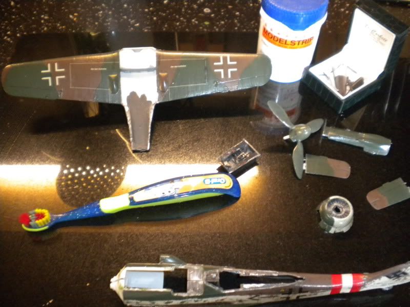

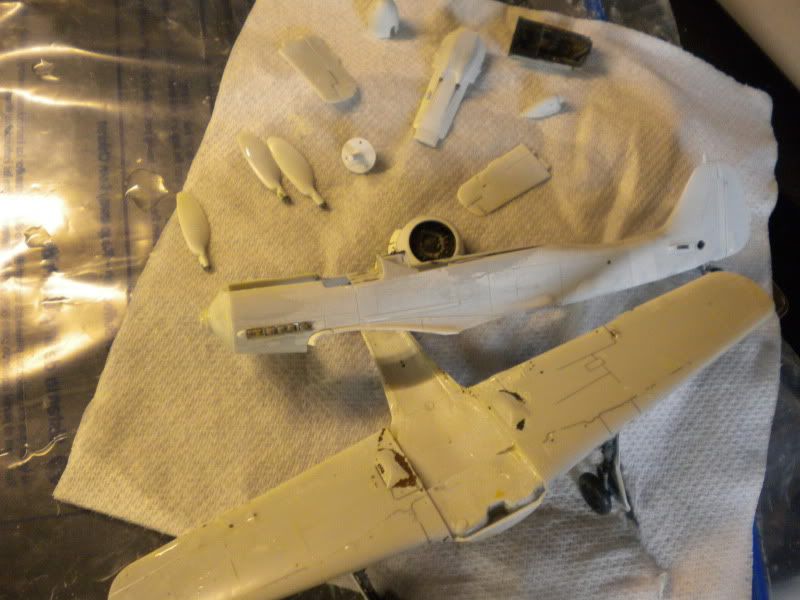

delta7 Posted August 5, 2011 Posted August 5, 2011 (edited) A while ago I made a trimaster 1/48 190 dora however I was never happy with the paint job, especialy on the wings so when I picked up another one I decided to redo the old one at the same time progress so far the parts came away easily and after 24hrs soaked in modelstrip The kit comes with metal parts and photoetch so all I will need to add are some decals I picked up an aeromaster set to use on the last one but didnt use them so one will be a JV44 flown by huptman Waldemar Wubke and one will be II/ JG 54 as flown by Gefr. Werner Merz For reference I have the superlative Green Hearts: First in Combat with the Dora 9. which my wife kindly bought me for my 50th The only thing I am lacking is the jv44 squadron badge decal which isnt on my sheets so if anyone has one spare Id be grateful Edited September 29, 2011 by delta7

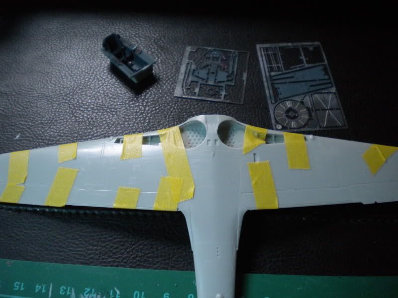

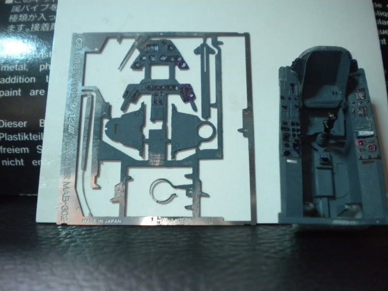

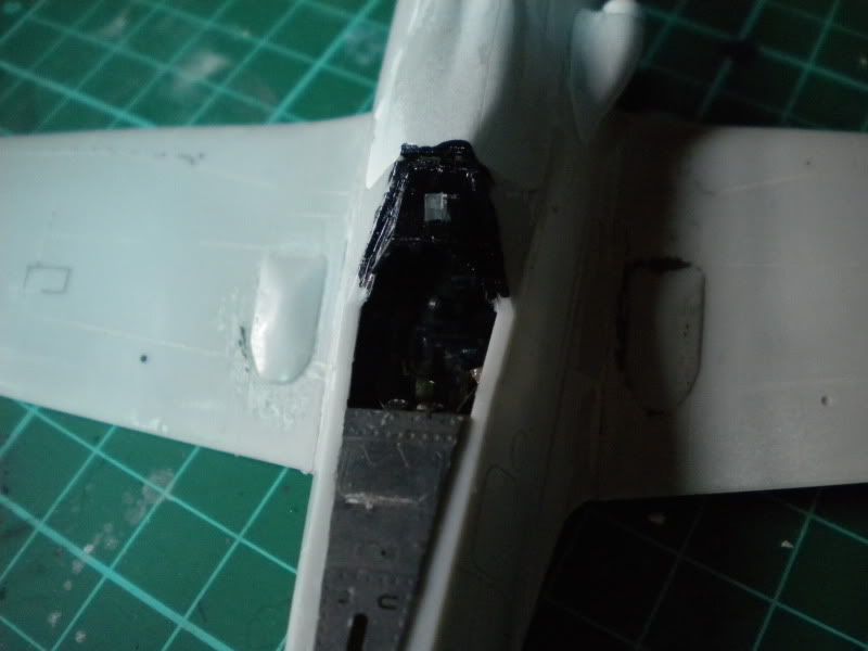

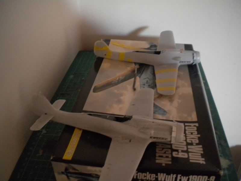

delta7 Posted August 26, 2011 Author Posted August 26, 2011 (edited) YAAH kids back to school and so Iv some spare time again A quick update- all parts were cleaned, I rescribed the lines on the one I stripped, and I have reassembled the origonal and made up the new one This is a nice kit and the parts fit well, all it took was a little piece of spare spruce inserted at the rear of the pit to spread out the fuselague and it was a snap tight fir of wings to fuselage some photos- subassemblies pit I made up some homebuilt seatbelts using wine bottle foil and spares from etch but cant see anything anyway waiting for glue to dry then filling, sanding and undercoat Edited August 26, 2011 by delta7

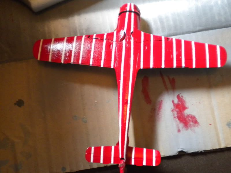

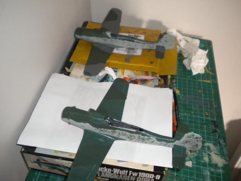

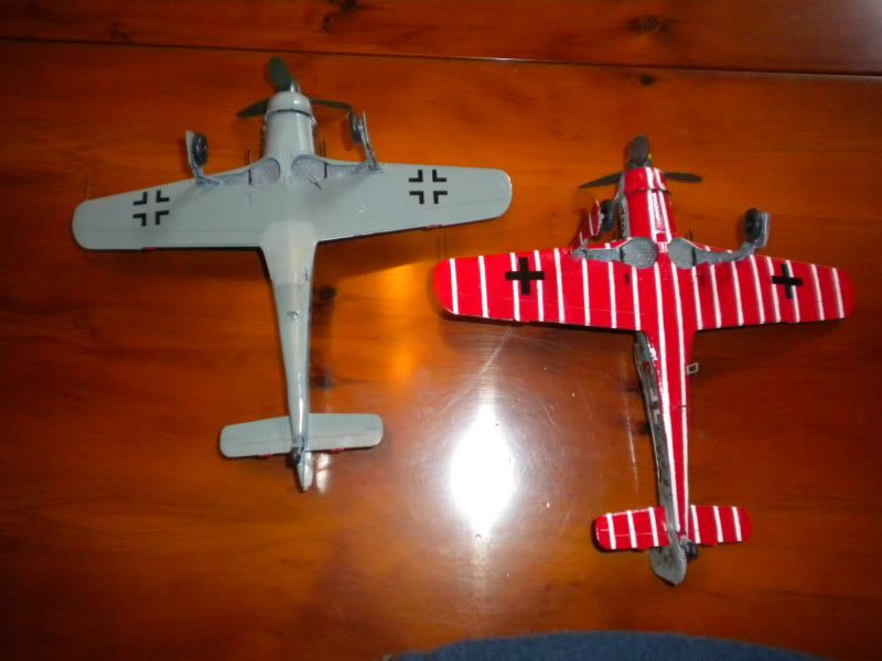

delta7 Posted September 18, 2011 Author Posted September 18, 2011 (edited) well things are progressing but not smoothly. I decided on reflection to go with plan B and mask the stripes, so I sprayed the bottom appliance white, masked then sprayed the red with my airbrush - now I havnt really got much practice with this and the results were a bit dissapointing. The red came out a bit orange peel and the masking tape was a POS and allowed the red to bleed under it. note to self - ALWAYS use Tamiya tape @NEVER EVER go for a cheap substitute again !!!!! One good thing was at least I got the spray paint to flow - added 2 drops of fairy liquid to the mix and it worked well, previous I had all sorts of problems with paint clogging up. Some more practice with pressure and distance and I might get round to retiring the hairy sticks but not yet, I still prefer them. anyway after this I hand painted over the worst of the red bleed and sandided it all over with 2000 grit and it looks better now I brush painted the top camo, the mottling is done by a sponge giving us this wheels and undercarraige next Edited September 18, 2011 by delta7

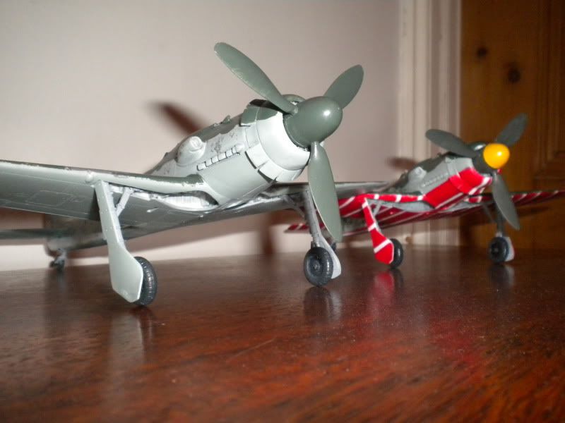

delta7 Posted September 21, 2011 Author Posted September 21, 2011 up on their feet, attempt 2 as I didnt get the angles right first time canopies next then varnish and decallling

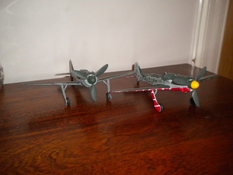

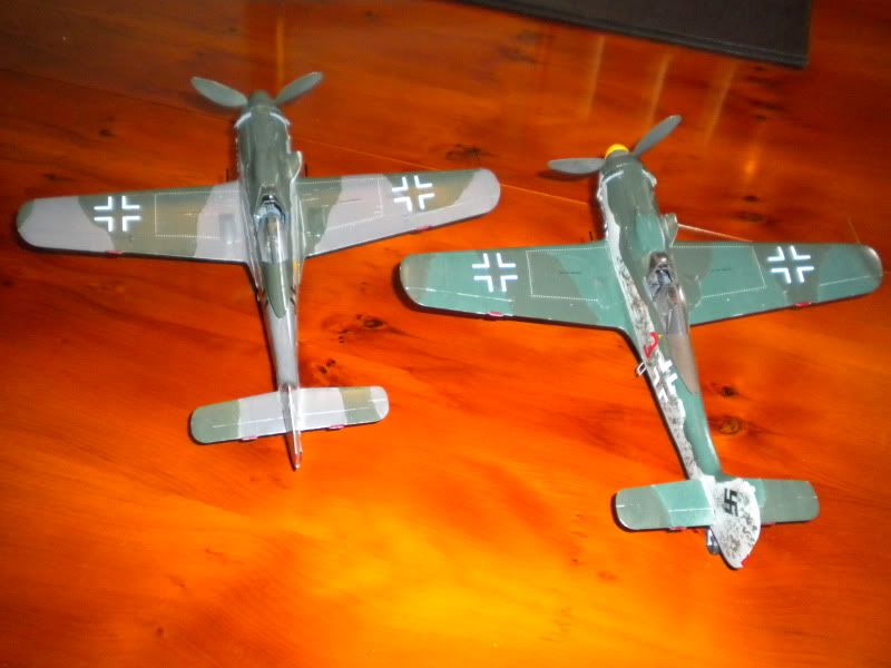

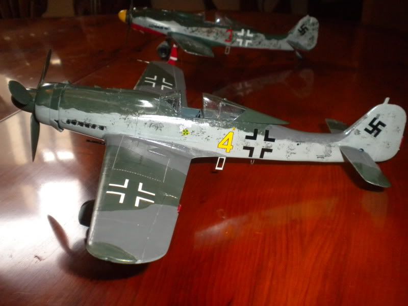

delta7 Posted September 29, 2011 Author Posted September 29, 2011 Finished - Im pretty happy with these
