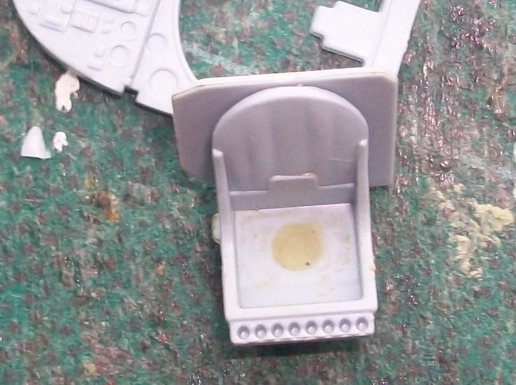

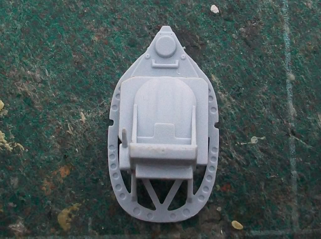

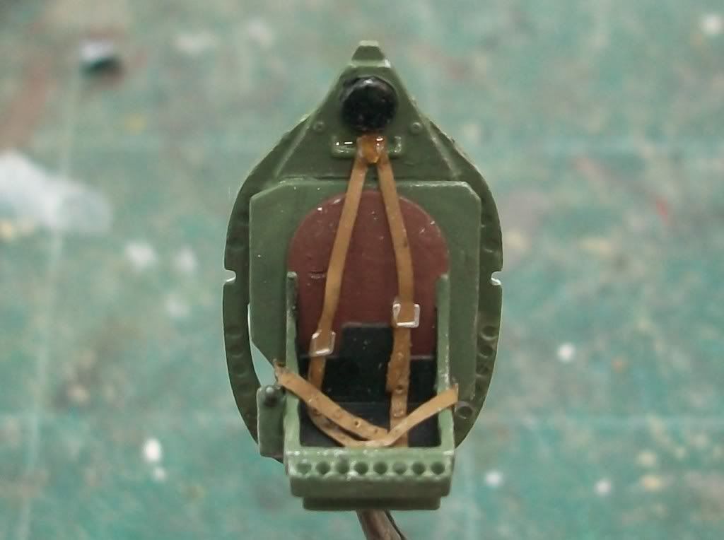

andy hood Posted June 16, 2011 Posted June 16, 2011 Started the build last night Filled the ejector pin mark on the base of the seat with milliput Seat , armour and bulkhead painted up Added an etched harness from the spares box

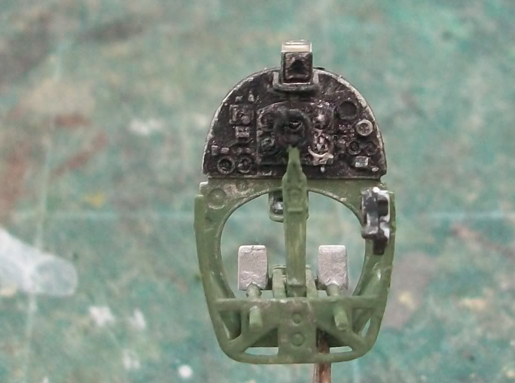

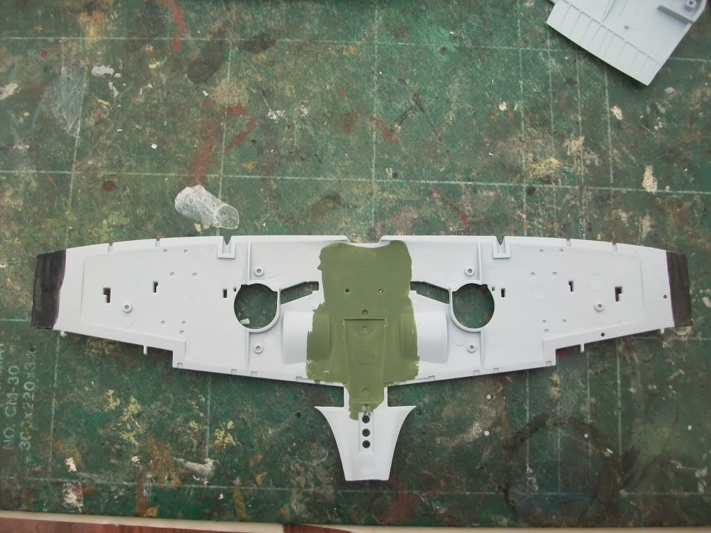

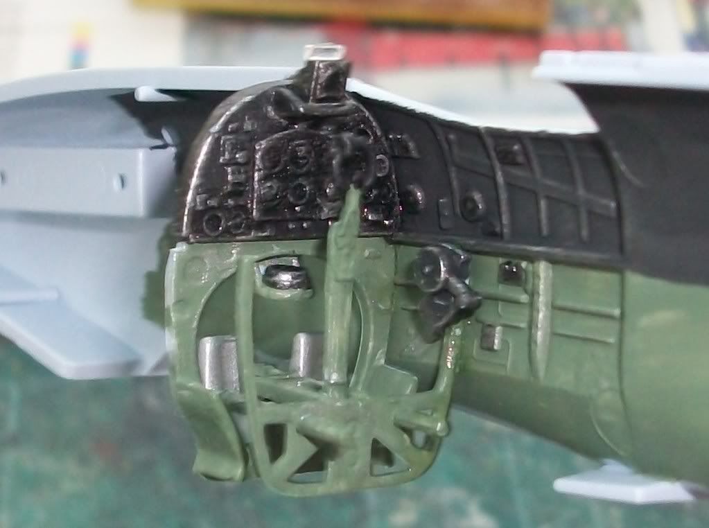

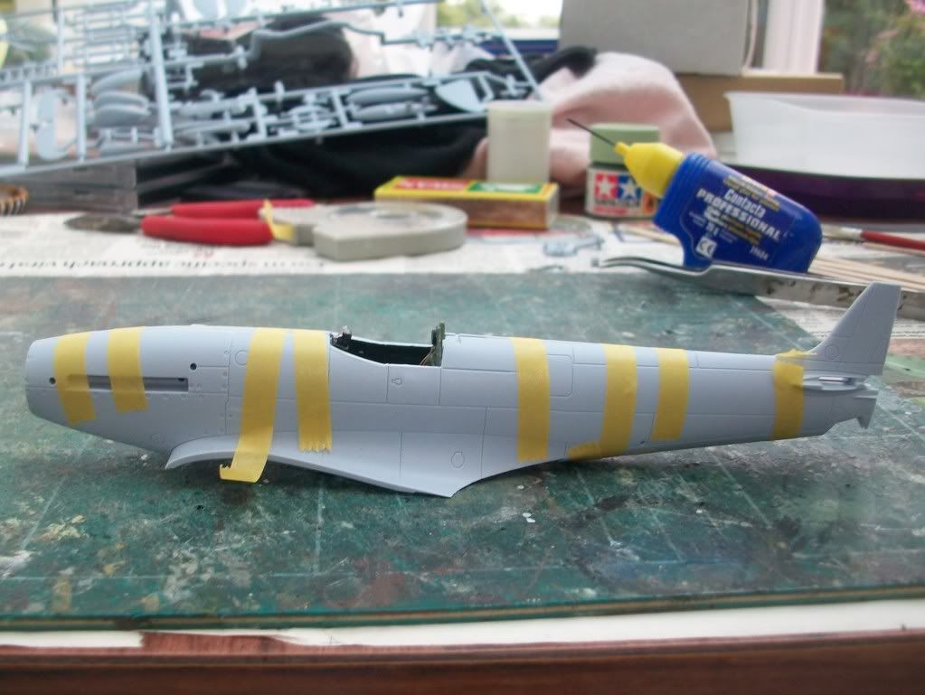

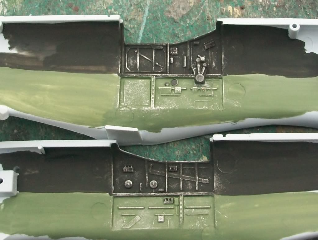

andy hood Posted June 16, 2011 Author Posted June 16, 2011 Rudder peddals ,control column and instrument panel painted and glued together Fuselage halves painted and weathered Fuselage halves glued together The areas shaded black on the wing edges need thinning down a bit to ensure a good fit with the upper wings

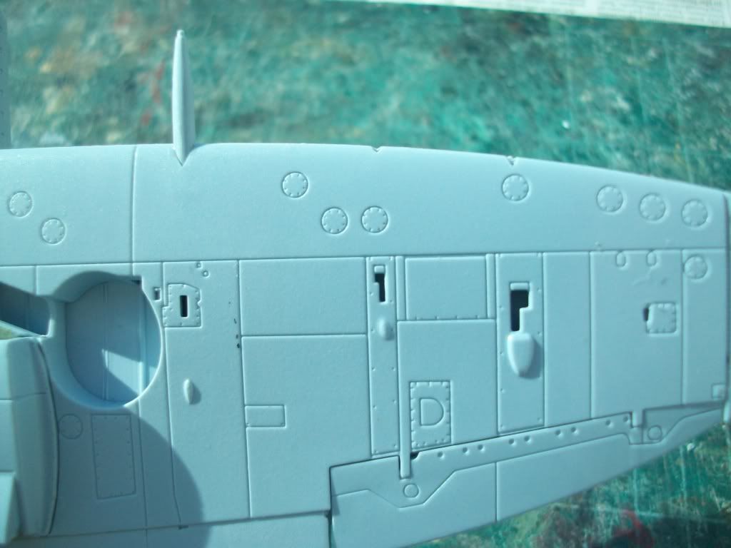

andy hood Posted June 16, 2011 Author Posted June 16, 2011 On the upper wing pieces there are two raised ejection pin marks (marked in black ) that need scraping away, thats as far as i have got so far, so far so good, hehe

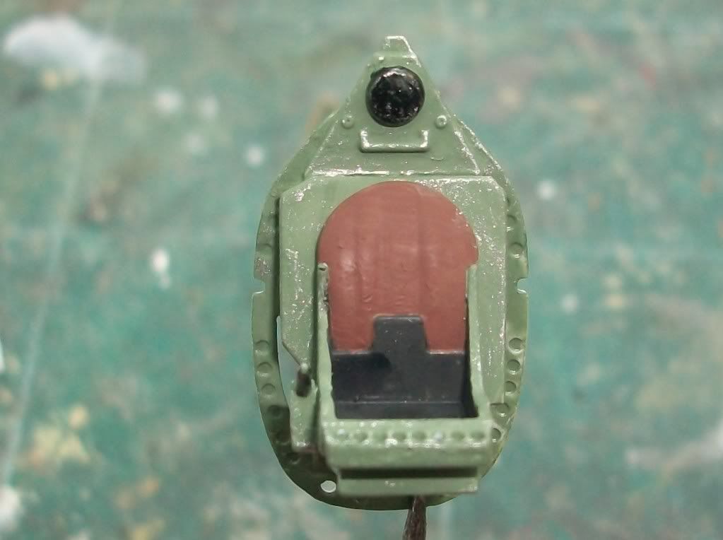

Miggers Posted June 18, 2011 Posted June 18, 2011 (edited) Watching this as I have one meself. It seems(looking at my own kit)that the 'pit is pretty good but those "rudder pedals" are pretty duff and they missed the back of the fuel tank that can be seen behind the pedals. Easy to rectify,but it would have been nice if they'd have been there. One point with yours though Andy,shouldn't the interior be Humbrol 90 i.e "Sky" rather 78 Interior Green below the black? I'll be interested to see Edgar and gingerbob's take on Airfix's colour calls for the cockpit colours. Mark Edited June 18, 2011 by Miggers
davidelvy Posted June 18, 2011 Posted June 18, 2011 Watching this as I have one meself.It seems(looking at my own kit)that the 'pit is pretty good but those "rudder pedals" are pretty duff and they missed the back of the fuel tank that can be seen behind the pedals. Easy to rectify,but it would have been nice if they'd have been there. Mark I thought that, then peered into the cockpit of one of my 1/48 Spits. I couldn't see the pedals.
Seahawk Posted June 18, 2011 Posted June 18, 2011 I thought that, then peered into the cockpit of one of my 1/48 Spits. I couldn't see the pedals. Heresy, I know, to utter anything other than unqualified praise for Airfix products but take a look at the ejection slots. The two MG slots appear to be in different scales and the cannon slot is smaller than either of them. Solution: build with wings unfolded and do not mount on mirror. Turkish carpet makers used reputedly to introduce a mistake into every carpet they made as a reminder that only God is perfect: Airfix patternmakers currently seem to have adopted the same practice. Don't get me wrong, it's still a lovely kit which I look forward to building. Nice to see continued progress on the vexed issue of engraved panel lines.
davidelvy Posted June 19, 2011 Posted June 19, 2011 (edited) Heresy, I know, to utter anything other than unqualified praise for Airfix products but... I wasn't defending Airfix on this one. I find the the representation of the pedals odd, given the detail of the parts to which they connect. However, if I can't see it in the finished model I'm not that fussed. Your observation on the ejector chutes does trouble me as although it's not a difficult fix, but an annoying one. Edit. I've just looked at the lower wing on my Mk XII kit. Unsurprisingly it is the same. Bizarre, but also annoying. Edited June 19, 2011 by davidelvy
Seahawk Posted June 19, 2011 Posted June 19, 2011 I find the the representation of the pedals odd, given the detail of the parts to which they connect. Check However, if I can't see it in the finished model I'm not that fussed. And check.
Moofles Posted June 19, 2011 Posted June 19, 2011 while the rudder pedals and a bit clunky, and the ejector ports are...poor, the scope for improvement is massive, you could drill out the holes in the rear bulkhead behinds the pilots seat, do some serious scracth building in the cockpit, the kit has a fantastic base, and with some modellers madness can really turn into a winner, now if only they would do a MK V i would be very very happy.
Miggers Posted June 19, 2011 Posted June 19, 2011 while the rudder pedals and a bit clunky, and the ejector ports are...poor, the scope for improvement is massive, you could drill out the holes in the rear bulkhead behinds the pilots seat, do some serious scracth building in the cockpit, the kit has a fantastic base, and with some modellers madness can really turn into a winner, now if only they would do a MK V i would be very very happy. Agree completely Moofles. All the lightening holes are earmarked to be drilled out in mine,new rudder pedals and the back of the fuel tank fabbed. Vic Schuerman did a first rate series of articles on building and detailing the Hobbycraft Seafire XV some years ago in SAM. I shall be digging them out of the loft methinks. Mark
Andrew Jones Posted June 19, 2011 Posted June 19, 2011 Look at the ejector ports on the Spitfire XII in the first photo in the previous post on Britmodeller http://www.britmodeller.com/forums/index.p...t=0&start=0 , they appear exactly as on the Airfix kit.
c.smith10 Posted June 19, 2011 Posted June 19, 2011 although the ports are different sizes as seen here i do think airfix have over done it!
andy hood Posted June 20, 2011 Author Posted June 20, 2011 Watching this as I have one meself.It seems(looking at my own kit)that the 'pit is pretty good but those "rudder pedals" are pretty duff and they missed the back of the fuel tank that can be seen behind the pedals. Easy to rectify,but it would have been nice if they'd have been there. One point with yours though Andy,shouldn't the interior be Humbrol 90 i.e "Sky" rather 78 Interior Green below the black? I'll be interested to see Edgar and gingerbob's take on Airfix's colour calls for the cockpit colours. Mark Opps my mistake, the interior should indeed be sky and not interior green, i did a quick repaint of the cockpit yesterday hehe,

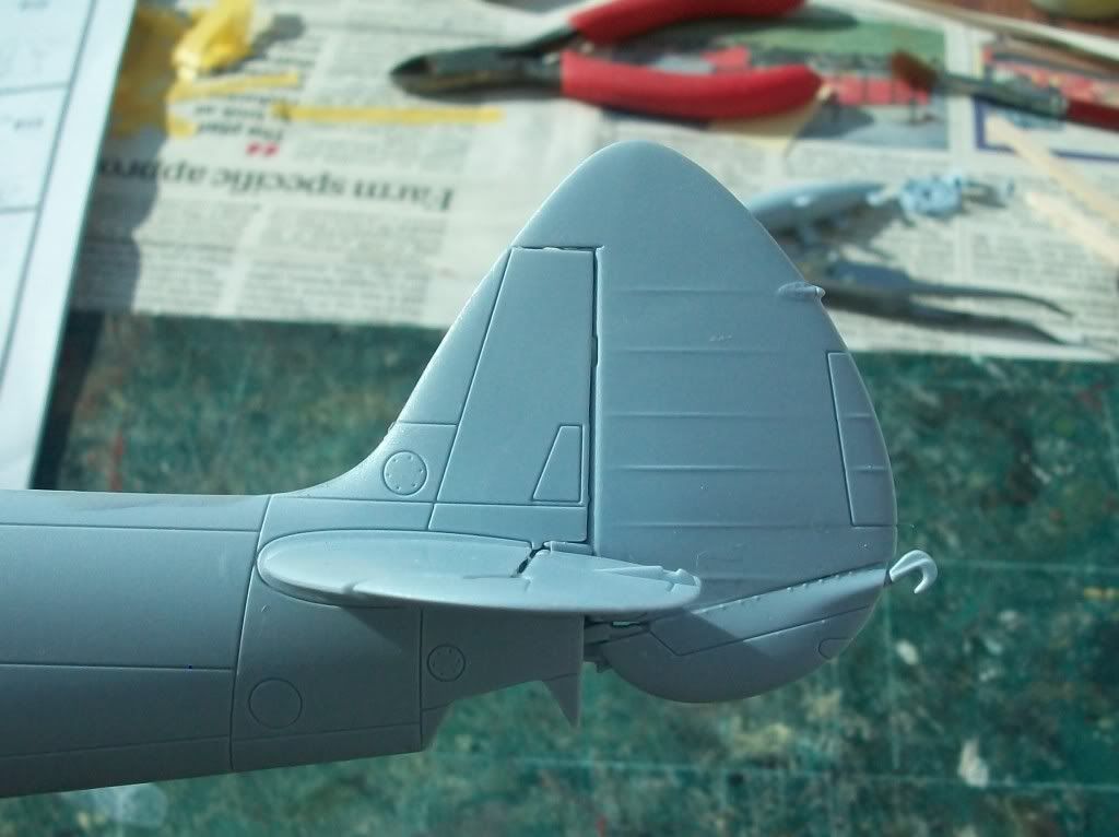

andy hood Posted June 20, 2011 Author Posted June 20, 2011 Got a bit more construction done over the weekend, the build is going good, there are a few gaps here and there on some of the joins, but nothing a bit of filler wont cure, i have found the plastic to be soft with this kit and have taken care removing pieces from the sprues, (some parts are attatched to thick sprue gates too) Rudder, horizontal stabilizers and catapult hook fitted to fuselage Wings glued together and added to fuselage Underside, radiators built up and glued on

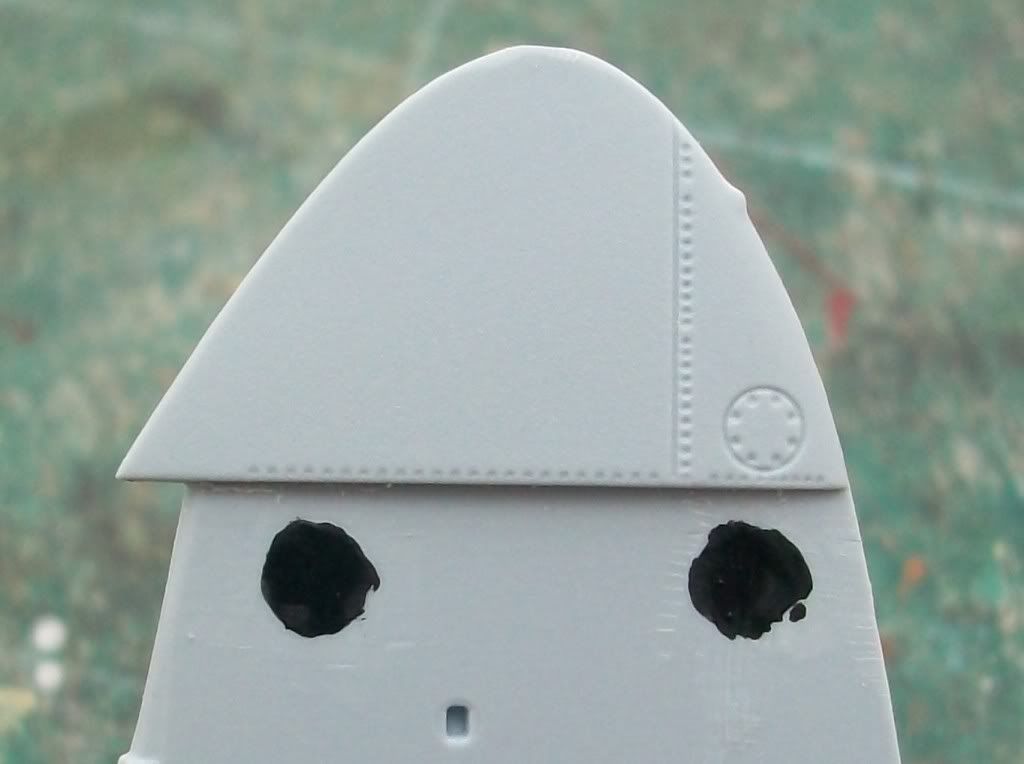

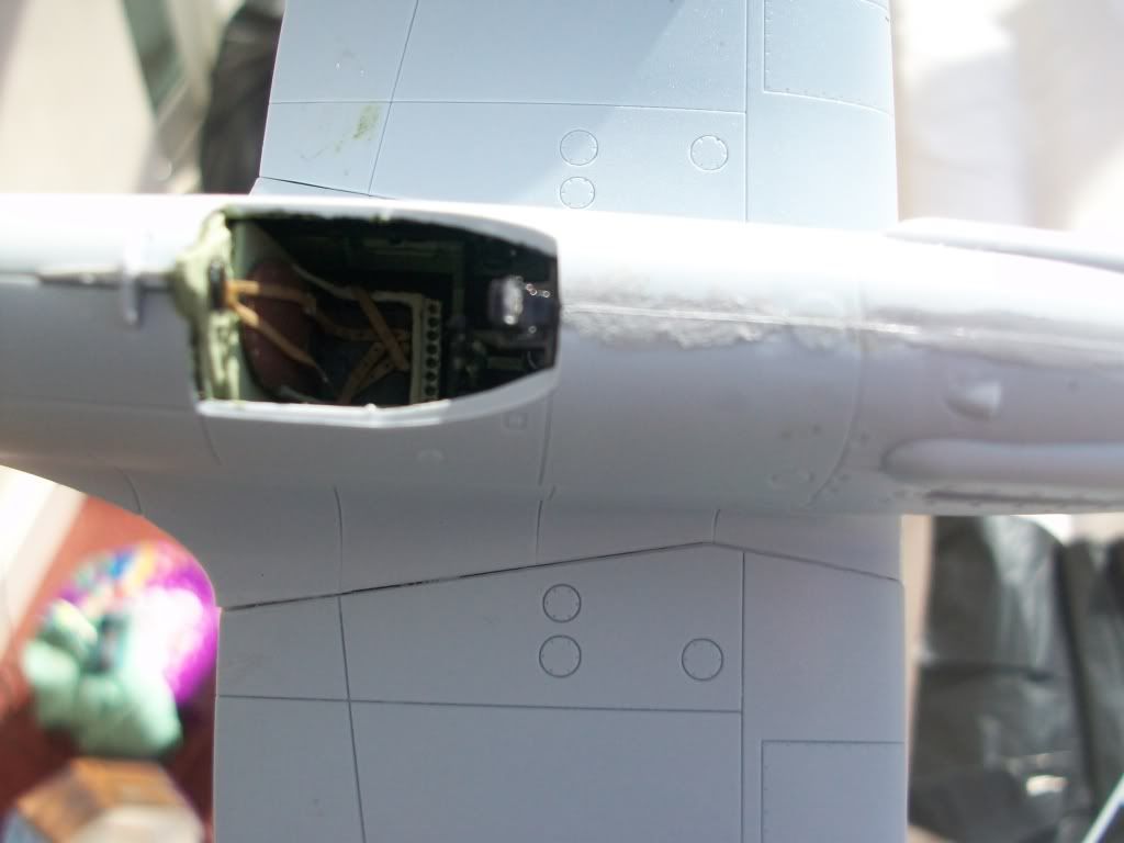

andy hood Posted June 20, 2011 Author Posted June 20, 2011 I added a plasticard shim to the under wing to fuselage joint, as i thought the gap was a bit wide for milliput or the like to fill it Bit of a gap on both sides of the main wing to fuselage join to fill Bit of a gap to fill on the tailwheel compartment too Dodgy? shell ejection ports on the underwings
Killingholme Posted June 20, 2011 Posted June 20, 2011 That lower wing-to-fuselage joint looks a very poor fit indeed. Not something I expected to see. I model 1/72, but I am still really tempted with one of these... thanks for the build thread. I bet you'll get a lot of nosey people like me dropping by! Will

Miggers Posted June 20, 2011 Posted June 20, 2011 That lower wing-to-fuselage joint looks a very poor fit indeed. Not something I expected to see.I model 1/72, but I am still really tempted with one of these... thanks for the build thread. I bet you'll get a lot of nosey people like me dropping by! Will I do 1/72nd too Will,but this screamed "Buy me Miggers,you know you want to"....... So I did. I'll do my usual trick with fighters Andy,fit the upper wing panels first to get a perfect root joint and then fettle the lower panel to fit. I'm going to modify mine to have the port wing down and the starboard folded,a bit of careful cutting on the lower main panel at a convienient panel line and fit the folded stub should sort it. The line is right by the starboard rad. Mark
gingerbob Posted June 21, 2011 Posted June 21, 2011 It seems(looking at my own kit)that the 'pit is pretty good but those "rudder pedals" are pretty duffand they missed the back of the fuel tank that can be seen behind the pedals. One point with yours though Andy,shouldn't the interior be Humbrol 90 i.e "Sky" rather 78 Interior Green below the black? I'll be interested to see Edgar and gingerbob's take on Airfix's colour calls for the cockpit colours. Sorry, a bit late to the party. Oh no, not me- I'm deferring to Edgar on the subject of cockpit colours. I haven't run across any recipes in my research, as far as I can recall, and I haven't had the opportunity to examine Spitfire/Seafire private areas to the degree that I would like (all in the name of enlightenment, of course!) I shouldn't think that you can see the back of the fuel tank, as a bulkhead was added early on during Mk.V production, thanks to all the burn injuries during the Battle of Britain. I haven't got one of these yet (did get the XII) but I have to say perfection or no the Sea XVII kit is one I'm very excited about! bob
Hepster Posted June 21, 2011 Posted June 21, 2011 I bought one of these at Kemble on Sunday, so I'm keen to see how the build goes. Seahawks quip about Turkish carpets notwithstanding, the ammo ejector ports do look bit weird. But it does look good, and there aren't any issues that the average modeller can't cope with. Besides, I've built an Airfix TSR.2, so I should be able to cope with any minor fit problems. So far as I am concerned, the Seafire XVII is another great Airfix kit that deserves every success (even if I got it cheap).
