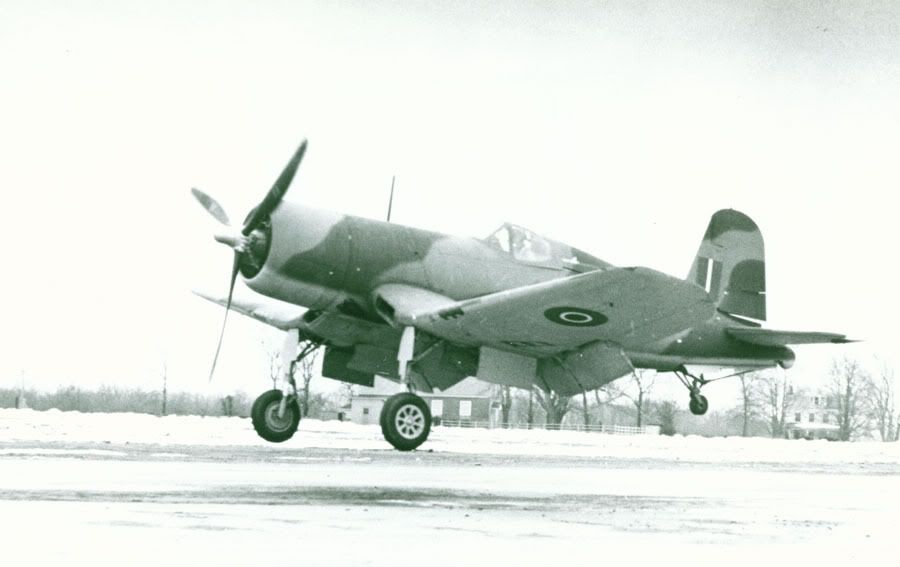

RelativeBrit Posted November 14, 2007 Share Posted November 14, 2007 Except perhaps for this Corsair II (Color) and the fresh out of the plant Corsair III (Photographed at Brewster's PA plant) Link to comment Share on other sites More sharing options...

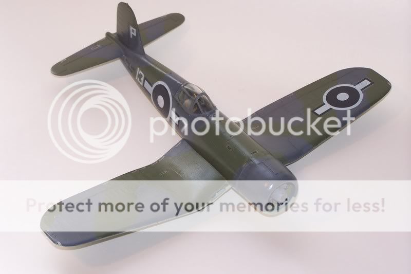

ancient mariner Posted December 3, 2007 Share Posted December 3, 2007 Made this years ago out of the old Otaki kit ( pre Tamiya et al). Im pretty sure I had to clip the wings and Im not at all sure now if it is the correct type for a FAA machine. Looks like you have plenty of good advice above ,from those that do know. Link to comment Share on other sites More sharing options...

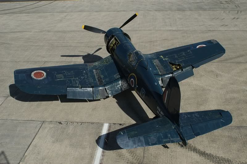

Bruce Archer Posted April 20, 2010 Share Posted April 20, 2010 (edited) So to get one of these in quarter scale would I just hack off the wing tips of a Tamiya F4U-1A.Has anybody done this and how hard is it to make good the wings once butchered Hi! So you wish to do a FAA Corsair, and I gather a -1A ( IE F4U-1A, F3A-1 or FG-1). So you will need the larger , narrow prop, the semi-blown canopy, the larger , fatter drop tank, and a pair of vents on the fuselage sides (look at the FAA Museums FG-1, and the vents are just behind the fuselage roundels). Some detail need to be altered in the cockpit, but keep the canopy closed and who cares. And of course clip the wing tips. It appears that a compny ( the name escapes me now, but I think it was "Bliss") provided tips for Blackburn (who did the mods for the C orsair to FAA Specs). Later, Briggs started to supply wings to Brewster , then Goodyear with the tips already clipped. It also appears that Brewster did NOT build ANY F3A-1D airframes prior to being shut down. So colors..... Corsair I and II (all): US Olive Drab, US Sea Grey and USN Non-Specular Light Grey Corsair III: Initially in USN Tri-Color, then as Corsair I and II, and finally in colors which appear to be close to the TSS. This is very hard to verify, as the Brewster records are gone, and this info is from parts diverted from Brewster to Goodyear, and a couple of color images . Corsair IV: Glossy Sea Blue There you have the basics. I am researching an article on the FAA's Corsairs and one bit of info ( when Goodyear started to install the clear vision hood) is what need to complete the article. I hope this helps! Bruce Edited April 20, 2010 by Bruce Archer Link to comment Share on other sites More sharing options...

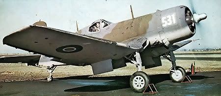

AnonymousFO98 Posted April 20, 2010 Share Posted April 20, 2010 (edited) There is also an anti-stall widget on the starboard leading edge you can make it out on this pic: not sure if that is on the US Corsairs or not, is absent on the Airfix 1/48 kit Edited April 20, 2010 by walrus Link to comment Share on other sites More sharing options...
