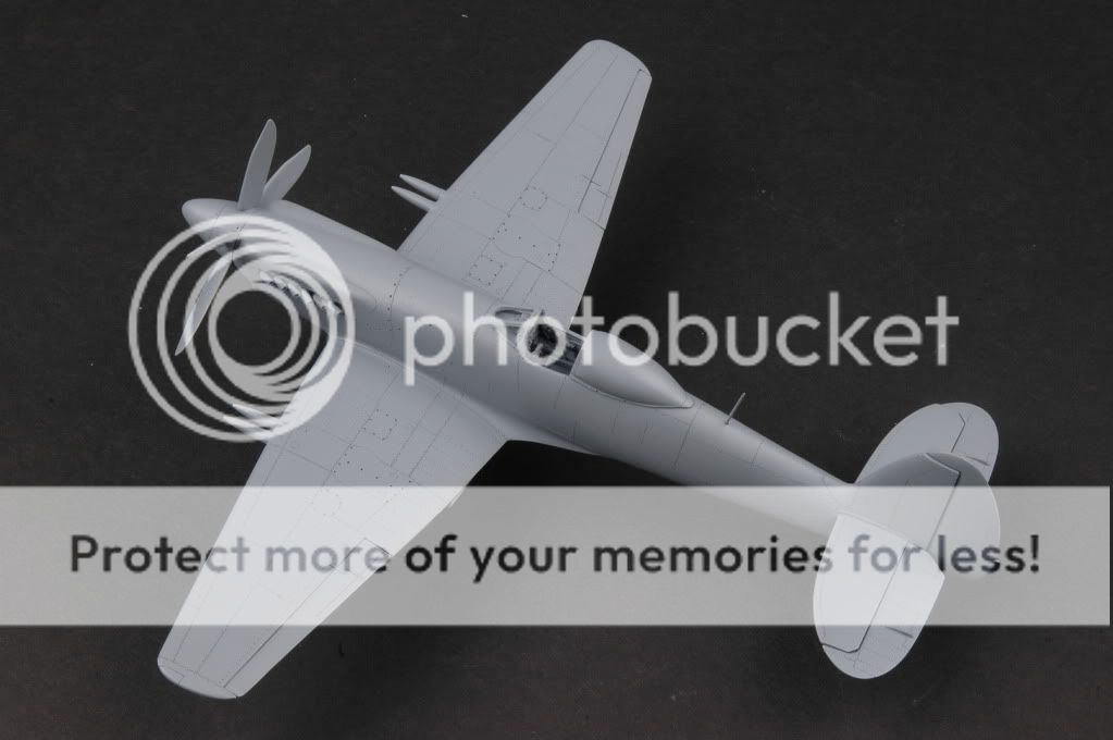

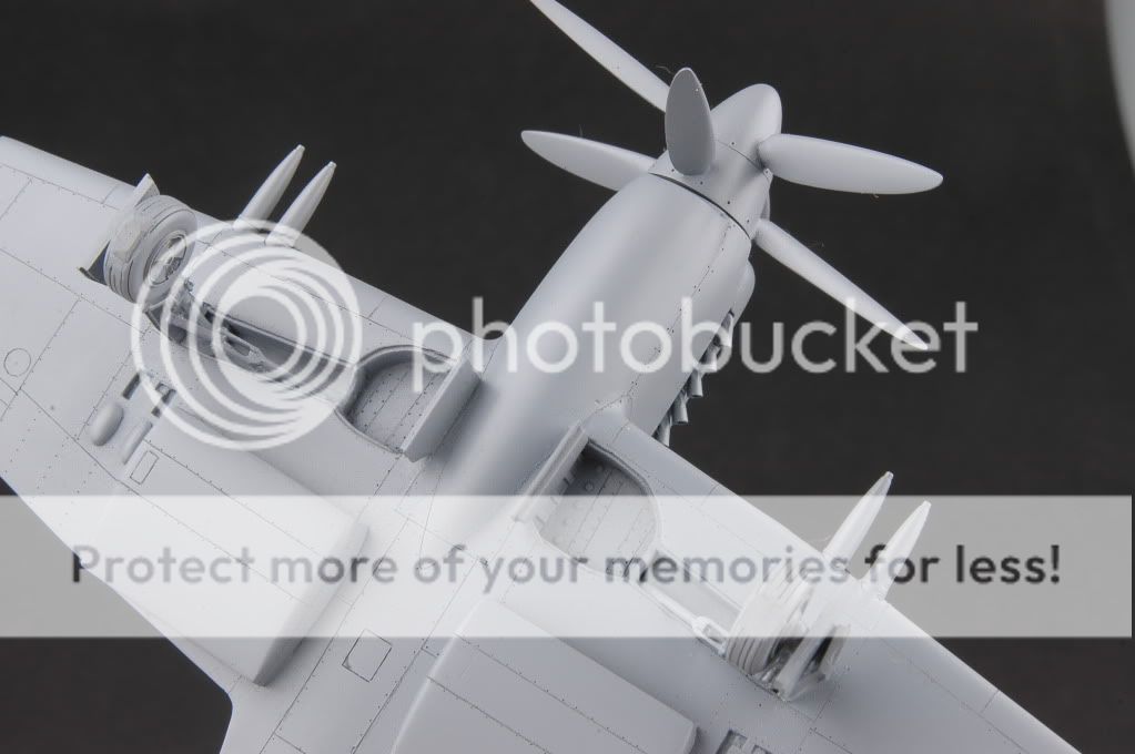

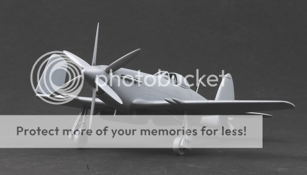

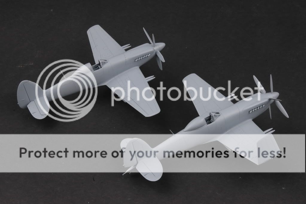

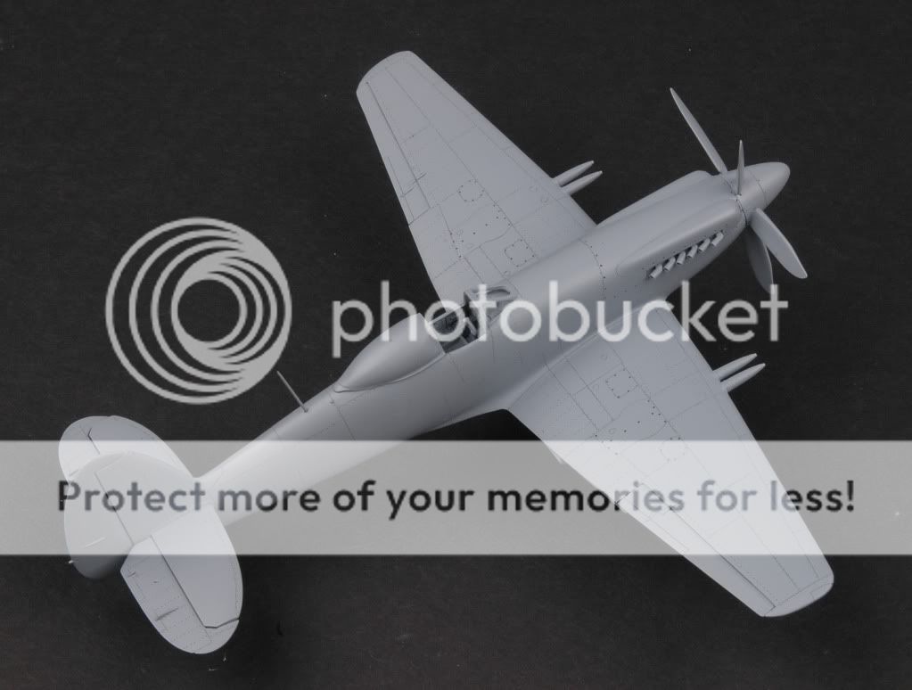

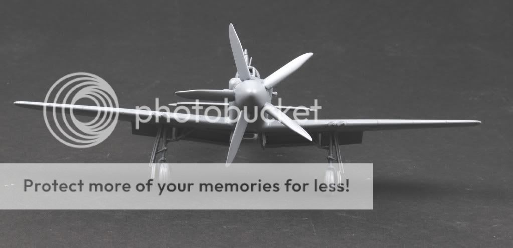

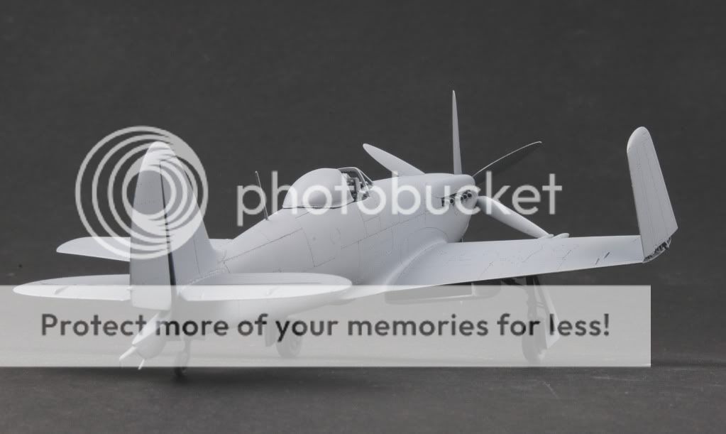

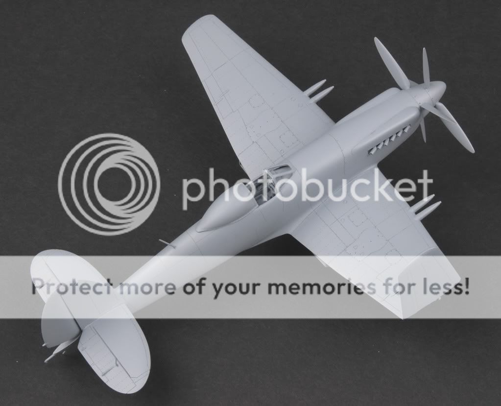

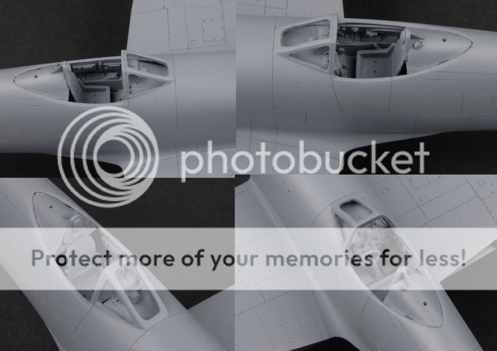

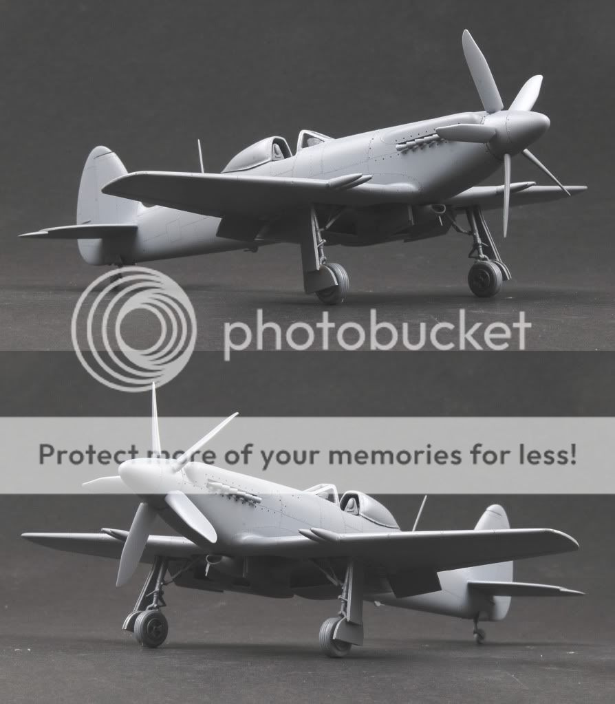

song Posted September 14, 2010 Posted September 14, 2010 (edited) Hi all we are just finish the Seaful family master, share his photo to here, please lend your eyes to check it . and give me more opinions before it get into metal mould making process. Saefang Seaful Best regard Song Edited September 14, 2010 by song

TonyT Posted September 14, 2010 Posted September 14, 2010 (edited) Mr Song, Looking very good, I would say you are missing the main fuel tank filling point off the top cowl, behind the engine, you have the oil tank access panel on the side, but the top fuel one isn't there as far as I can see, This is on the 19 to show it on the tank as you can see the filler is quite deep http://i536.photobucket.com/albums/ff321/t...sRRGNmedium.jpg and this shows the tanks there on the Spitful and the same layout http://i536.photobucket.com/albums/ff321/t...Spiteful012.jpg http://i536.photobucket.com/albums/ff321/t...Spiteful013.jpg Also as the drawings show the header tank for the coolant being at the front as per the 19, I would suspect you are missing this filler panel, though it does not show well in the photos I have. http://i536.photobucket.com/albums/ff321/t...y/portfront.jpg also the gearbox dipstick one again off the 19, but the big curve piece is a repair http://i536.photobucket.com/albums/ff321/t...ony/rearstb.jpg on a side note, I notice you are doing the MK V? this is one of the original Spitfire paint scheme drawings produced during the war. http://s536.photobucket.com/albums/ff321/t...fireDrawing.jpg Edited September 14, 2010 by TonyT

The wooksta V2.0 Posted September 14, 2010 Posted September 14, 2010 (edited) The AZ kit is too slim, the prop spinner is overscale for the fuselage (despite being the same size as those for other Griffon Spits), the canopy is the wrong shape and woefully undersize, the cockpit interior is bogus. Frankly, horrible. I had four and sold three on as soon as I could. The only one left I'll be using as a source of bits to cobble together a decent Spiteful prototype with a Spitfire F14 fuselage. I'm probably going to get shot down here, but I've a feeling that the u/c legs are wrong. The master has ones similar to a Mustang but I'm not so sure that's correct. The snag is, none of the available photos on t'interweb have enough detail or are from the wrong angle. I'll check with the Morgan/Shacklady bible when I get home. However, in the meantime, this may shed some light on the problem. Edited September 14, 2010 by The wooksta V2.0

jenshb Posted September 14, 2010 Posted September 14, 2010 (edited) An interesting choice. Thankfully, the surface details are clean, with just enough rivets on the main detachable panels to be of interest - as you have seen, the real airframes were very smooth. Shapewise the only think I would question so far is the shape of the spinner on the Spiteful. It looks too rounded in the front and too flat on the sides. I'm pretty certain there should be a subtle "discontinuity, or a "break" if you like, in the curvature between the spinner and the upper nose contours. The wheel wells do look rather naked and boxed in whereas the real ones are quite open with only the main spar forming the rear wall. AFAIK, the Attacker used the same wing, so I would assume that the wheelwells would be very similar. I have taken some pics at the FAA Museum and I can post them later. Jens Edited September 14, 2010 by jenshb
