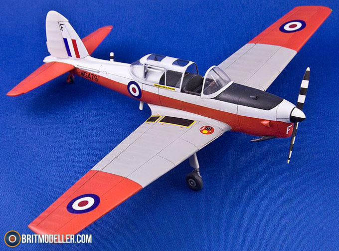

Mike Posted October 3, 2011 Author Posted October 3, 2011 But back to the serious stuff. Does anyone have any experience of using Alclad primers as a top coat? Specifically, how does it behave when sprayed over enamel or acrylic? It's a lacquer/cellulose based paint, so as long as your base coat is well & truly dry, and you don't whack it on in dollops, you'll be fine. I use the white primer as my white paint now, as it's so dense that it covers VERY quickly and well. My Chippie's white bits are white primer 2
Enzo the Magnificent Posted October 3, 2011 Posted October 3, 2011 (edited) It's a lacquer/cellulose based paint, so as long as your base coat is well & truly dry, and you don't whack it on in dollops, you'll be fine. I use the white primer as my white paint now, as it's so dense that it covers VERY quickly and well. My Chippie's white bits are white primer Thanks, Mike. That's just what I wanted to hear. And it's any excuse to show off that superb Chipmunk, innit? Now... I have always been put off doing models in the anti-flash white scheme simply because of the difficult in spraying white acrylic. I could use a rattle can of appliance white, but I'm always concerned that the finished result will look bland and toylike. So... I assume that Alclad white primer has a different appearance to appliance white spray paint. It might be interesting to try a base coat of Alclad with various panels masked off and sprayed with appliance white to give a very slight contrast. Must try that sometime. Edited October 3, 2011 by Enzo Matrix
bootneck Posted October 3, 2011 Posted October 3, 2011 .......................... I use the white primer as my white paint now, as it's so dense that it covers VERY quickly and well. Stop it Mike! at this rate (buying all this fantastic new Alclad stuff) I'm going to be well and truly broke REALLY like the chipmunk! cheers Mike
