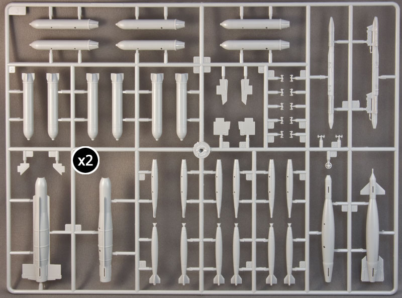

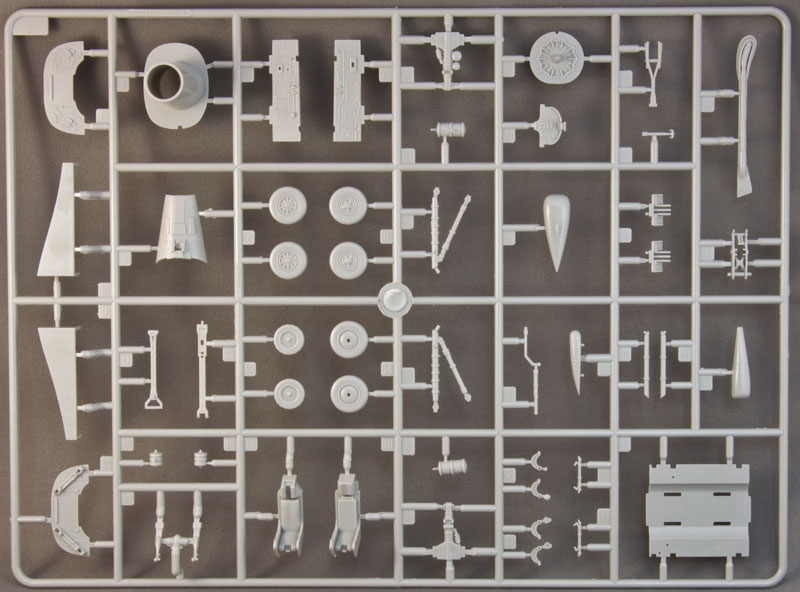

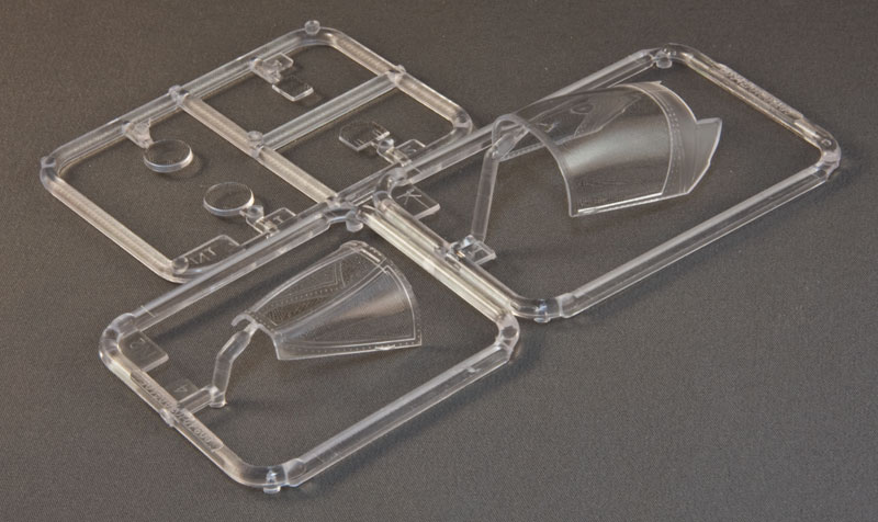

The kit arrives in HobbyBoss' usual top-loader box, with quite a selection of sprues, although not rammed to the gunwales. There are 4 sprues of grey styrene for the airframe itself and a further 5 for the wide range of ordnance that the SLUF could carry. The clear parts are on three small sprues, presumably to allow for the two-seater canopy to utilise the windscreen parts. There is a seam down the middle of the canopy that will need removing, and at first you wonder why, as the sides of the canopy seem fairly straight. On closer inspection however, there is a small amount of bulge at the top of the front of the canopy, necessitating a multi-part mould.
The intake lip is separate from the fuselage, and doesn't have quite the correct profile, instead being a little flattened at the bottom, and consequentially either too wide, or appearing too wide due to the changed proportions. A certain amount of adjustment could be made by judicious sanding, but it would be best fixed by a replacement intake lip. The two gun trough lip is also included in the box to confuse matters, due to the modular breakdown of the kit.
Each fuselage half is a one-piece moulding (ignoring the intake lip), which has two open avionics bays on the sides, which are sometimes seen open during periods of inactivity. The cockpit tub is well detailed for all but the most demanding, although the ejector seat is a little simple due to its one-piece design - another slightly different seat is supplied, so be careful which one you choose. Decals are provided for the instrument panel and side consoles should you wish to apply them over the raised detail already provided.

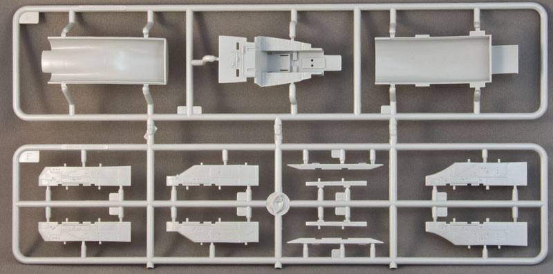

The nosegear bay is built as part of the intake trunking, which it should be noted does not provide full depth. It simply finishes at the front of the main wheel bays. It may be sensible to blank this off, as although it's unlikely anyone will see the lack of turbine face, there could be a little light to illuminate the interior if you've not closed every join 100%. At the rear is an inch long section of exhaust trunking, which is blanked off with a part engraved with a simulation of the afterburner ring - again, only the nosey would venture there.
Before closing up the fuselage, the interior around the exhaust will need a lick of interior green paint, as there's quite a gap around the exhaust.

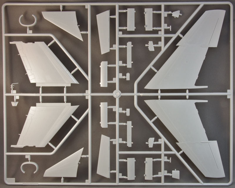

The wings are provided without the possibility of folding them from the box, which is an odd choice, given the aircraft's use. The wing underside parts only extend as far as the hinge-line, and it will be necessary to punch through 6 flashed off location holes if you intend to add the nicely detailed pylons and their separate sway braces. Flaps are separate, so could be dropped, but the stabilators are moulded in place on the single thickness outer panel, so would have to be mobilised if you wish to portray the aircraft with flying surfaces deployed.
The landing gear provided is functional, but would benefit from the addition of some brake-lines to busy them up. The tyres are moulded without weighed flats, and be careful to choose the rather bumpy looking nose-gear tyres, as you have a choice of smooth or - from the looks of it, cross-country!

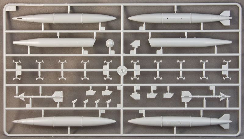

It's rare that a kit's armament sprues outnumber the airframe sprues, but as usual HobbyBoss provide plenty.
2x Fuel Tanks
1 x FLIR pod
12 x Mk.82 Bombs
12 x Mk.20 Cluster Bombs
6 x AGM-65 Mavericks (single or triple mounting)
2 x AIM-9L Sidewinders
2 x GBU-10 Paveway II Bombs
Do however check your references to decide whether the weapons were used, and if so, typically on which pylons.

Also if you are wanting accurate tanks for the SLUF, take a look at your Hobbycraft and Hasegawa A-4 kits, those are Aero 300 gal tanks, the same as those used on the SLUF - except that the A-7 ones had a third fin that was on the bottom of the tank's tail end. Since the kit does have that part you can add it to the Scooter tanks. I figure those looking at the A-7s will probably have A-4s in thier stash or spares in thier weapons locker somewhere. I think I have 12 tanks I have accumulated over the years.
