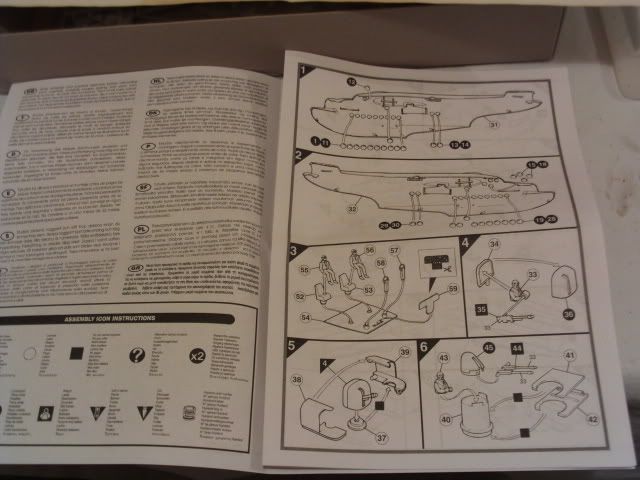

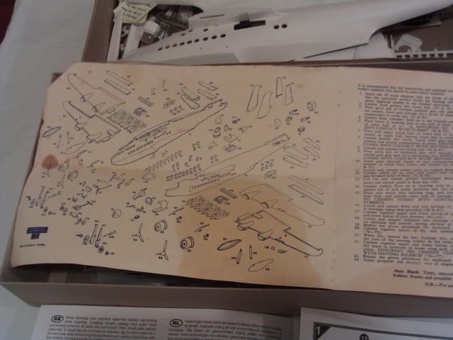

Ok have an Airfix kit ready to build as these photos show, there is a difference in the old and new boxing
building instructions
Old
recent

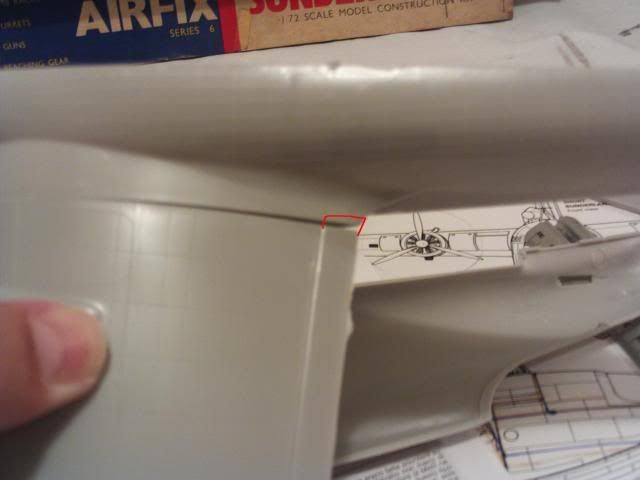

To build an accurate Sunderland Mk III there are some issues that need to be addressed.

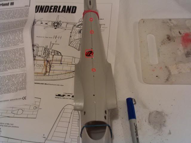

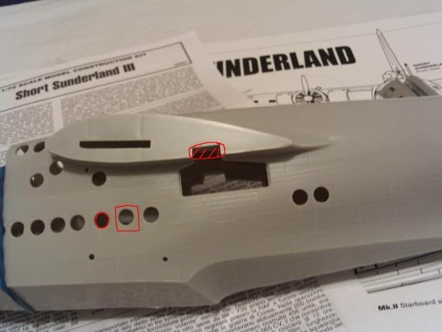

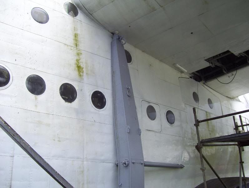

1) in the folowing photos the issues are:

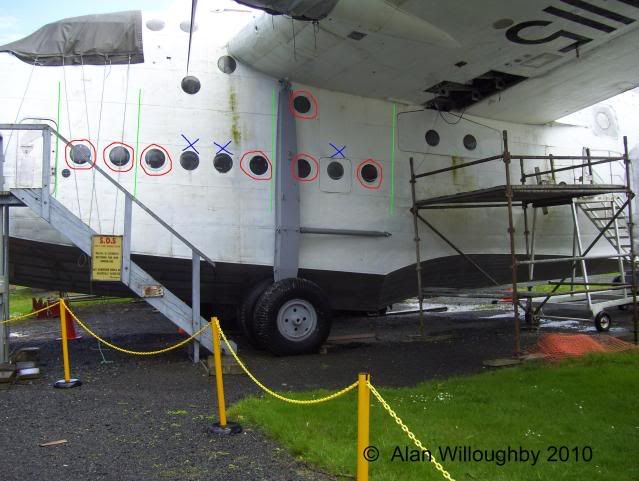

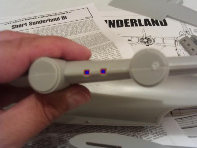

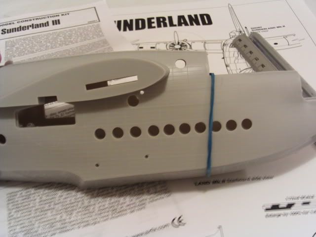

A) Port Holes need to be addressed as they are All the diameter of the opening porthole
which in 1:1 scale is 37.5cm, in 1/72 scale is close to 5.2mm
In reality there are only some portholes that open on the lower deck and one under the wing (more later), the rest do not open and the
diameter in 1:1 scale is 30.5cm (note this is the transparency diameter for the opening porthole also), which in 1/72 scale is 4.2mm
Interestingly enough Airfix got the right number of porthole (especially on the starboard side) on the lower deck-forward of bomb bay
there should be 10 (9 on Portside)
B) The Sunderland has a galley hatch that is quite prominant and missed out on the Airfix kit, this can either be scribed in or cut out
if doing a diorama like me

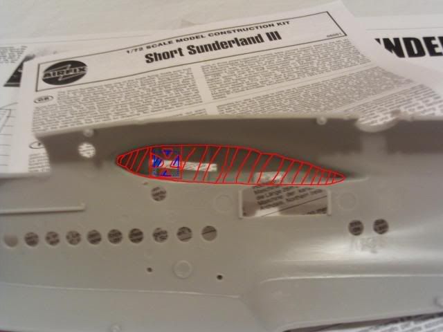

C) The trench under the wing needs to be filled in as it's bogus, as the real bomb rack slots are nothing like that.

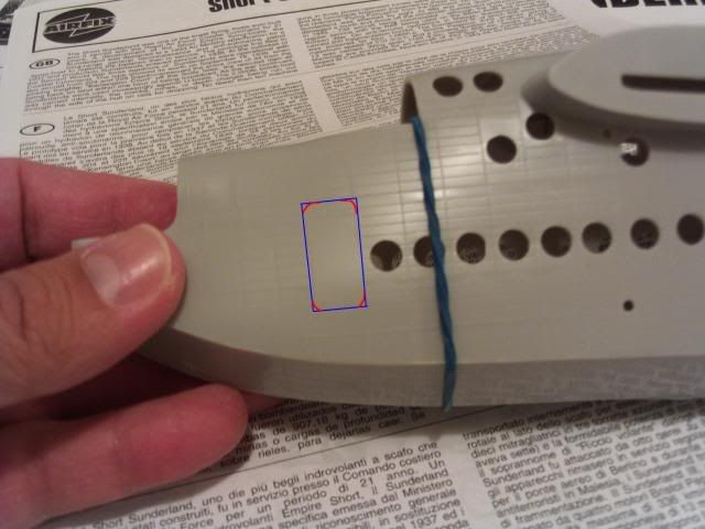

The main forward and rear hatches will need to be rescribed to have a less retangular shape (I'm cutting mine out)

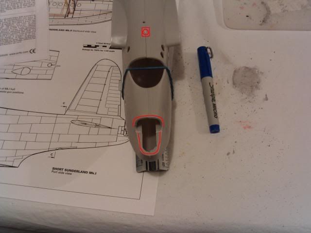

A) The bow turret area needs attention as it has the slide area for the toy turret
B) The Sunderland (all marks) had an escape/exit hatch/astro dome upper. which needs to be either scribed in and transparent
dome added or removed if doing a on water diorama scene with crew on wing etc. If doing a takeoff/landing scene this would be
open as an escape (standard ops requirement)

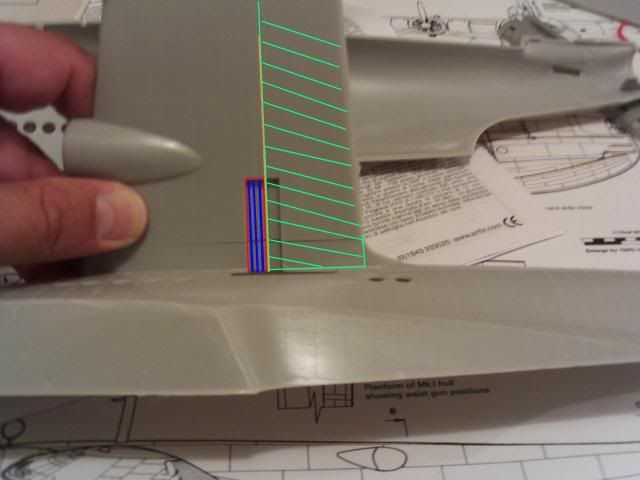

Lower wing
The green area shows the Gouge flap extended right up to fuselage which included part of previously mentioned bogus trench
The Blue represents the track for the bomb racks
Slight bit of trivia, the yellow line is representative of a hardwood trim between Gouge flap and bomb rack tracks

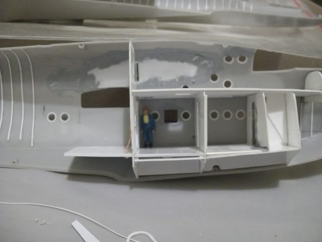

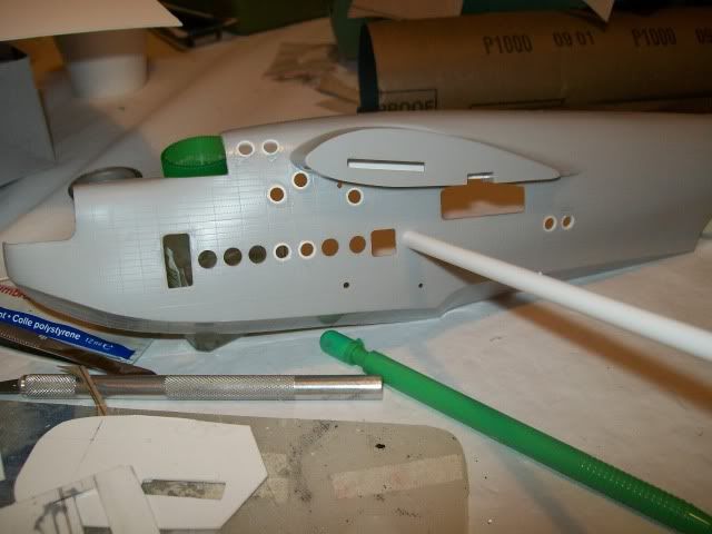

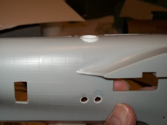

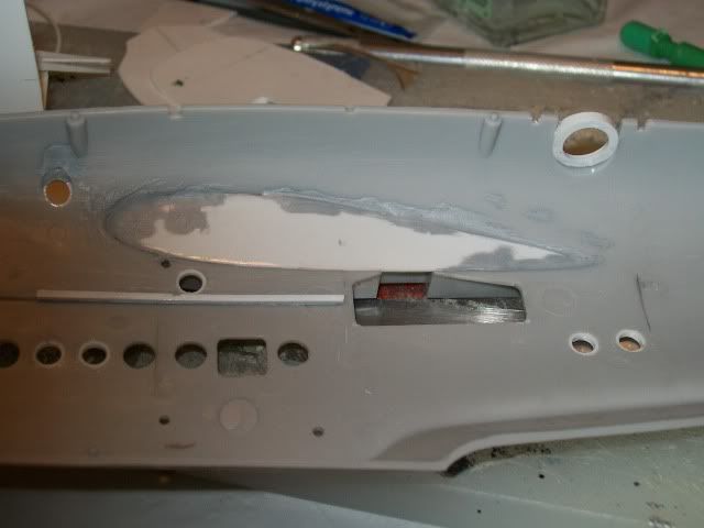

I started adding styrene tubing to the port holes to make them the right size
The tubing I'm using is Evergreen 5.5mm tubing picked up from local hobby store
The tube internal diameter is about 4.2mm which is what
you want. I simply cut a ring with a fine modelling saw, about 1.5mm thick, slid it (or squeezed) into the opening and ran some Tamiya extra thin
liquid cement around the edge. When dry trimmed off excess with knife. If there is saw cut excess in the opening , I used a 4mm drill rotated
by hand to slowly get rid of it

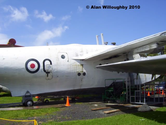

As you can see I have cut out the galley hatch (this is about 8mm) and the main forward entrance hatch (Airfix measurements
are about right) if you have scribing templates, these come in handy for this.

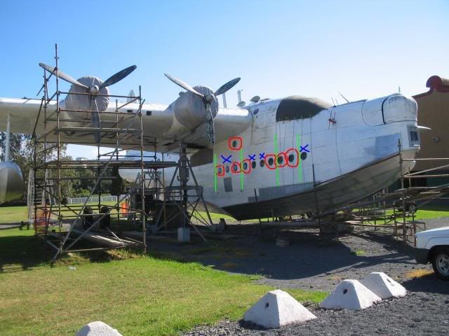

Now when building your Sunderland you may either want to leave the portholes closed or some open, the following two pictures
show the non opening and opening (non opening with X, opening with O)
Port side
Starboard
The green lines represent the Bulkheads for each area inside the lower fuselage

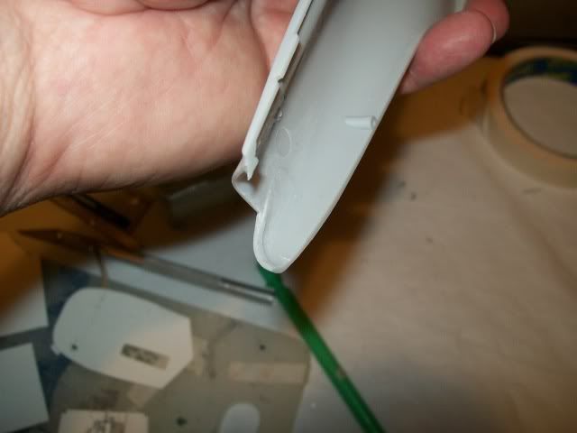

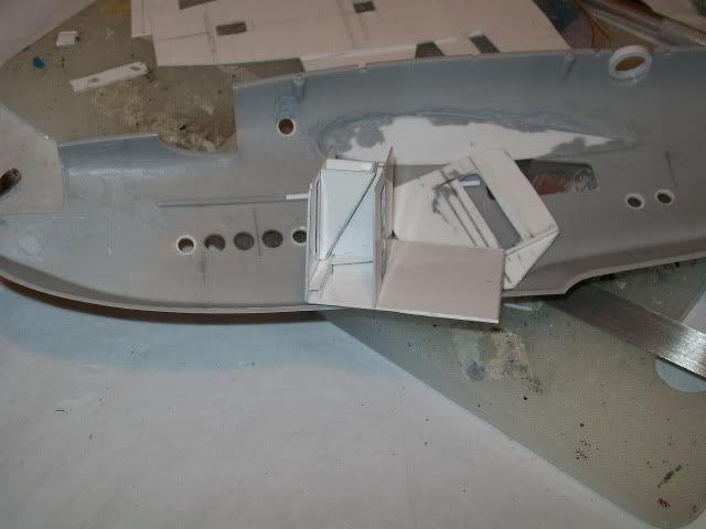

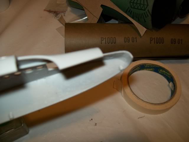

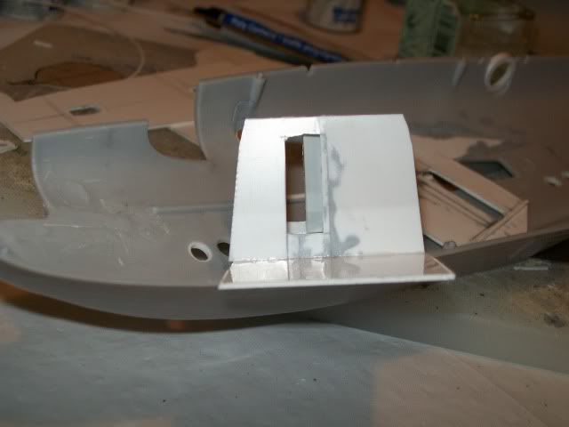

I have cleaned out the plastic in the bow and stern turret areas to allow me to build this up later.
The tail turret needs attention as the turret (lower) should look like this
Added a section of turret cut from a spare upper turret to start the area for the deleted turret
If building a Sunderland sans ventral turret, you will need to build up the area to look like this hump on the actual aircraft
I have added some styrene to cover the wing wells and notice the added styrene to act as upper deck support

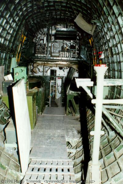

The Bomb bay is not totally accurate, in that the rear wall is too high.

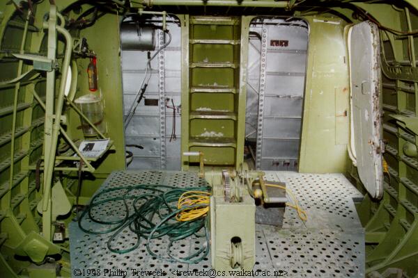

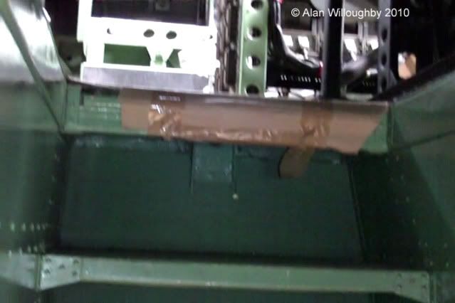

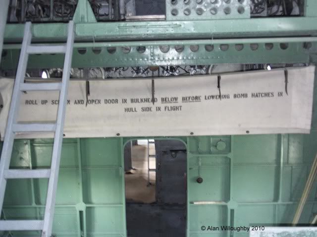

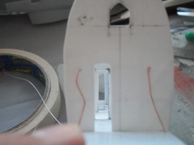

The wall with the "oven Door" (upper entry to flightdeck) is interesting, in that the instructions give the impression
that the wall bends at an angle. This is not correct as it is straight up and down.

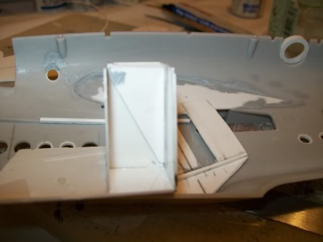

My build

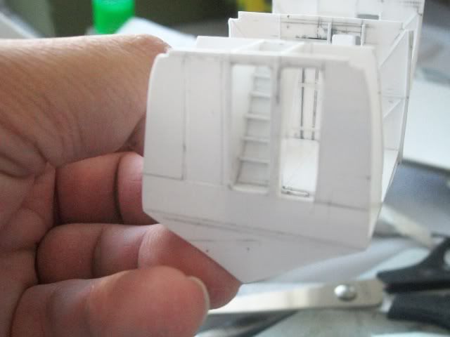

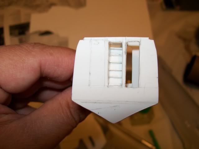

The forward main bulkhead
As you enter the main hatch
Upper main bulkhead

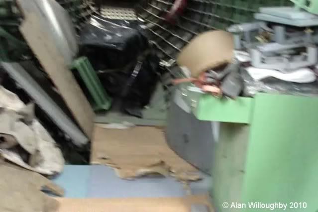

Interestingly enough I don't have a full shot (after all the video/photos I have taken!!!!) so i have borrowed one
http://www.kiwiaircraftimages.com/images/m...at/98SUND01.JPG
This is the Main bulkhead I have made- you can see the entry to the rest of the aircraft (port) steps to the flightdeck (middle)
and toilet/WC/Head on starboard side

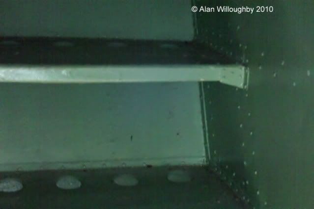

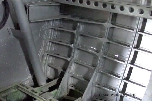

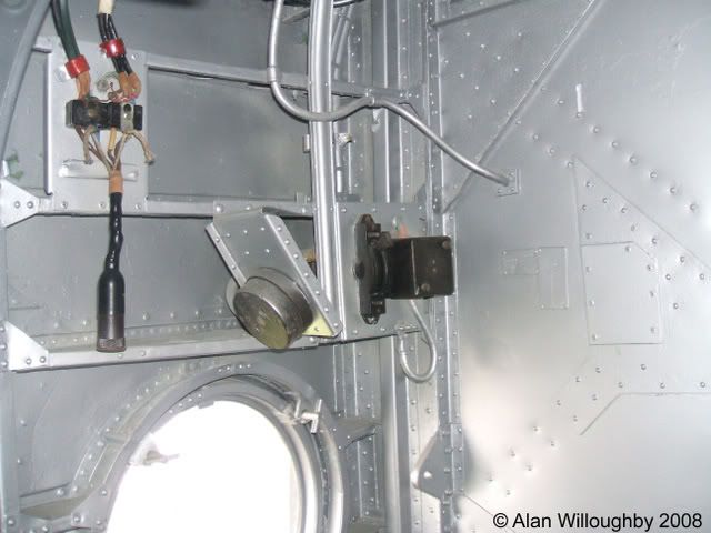

Steps: close up as you can see, just steps- I have been up and down those and it's a tight fit!!!!
Toilet
My build
Real thing

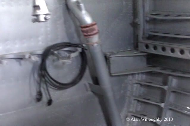

Entry into what is known as cloakroom, my build
Real thing
A place to hang your hat
Looking from the Officers ward room -my build
Real thing

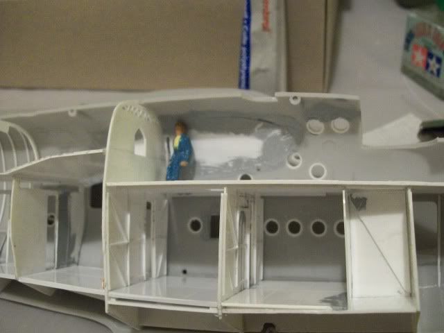

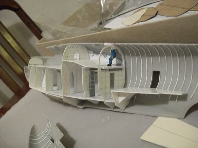

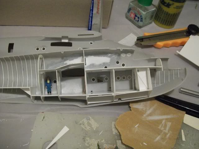

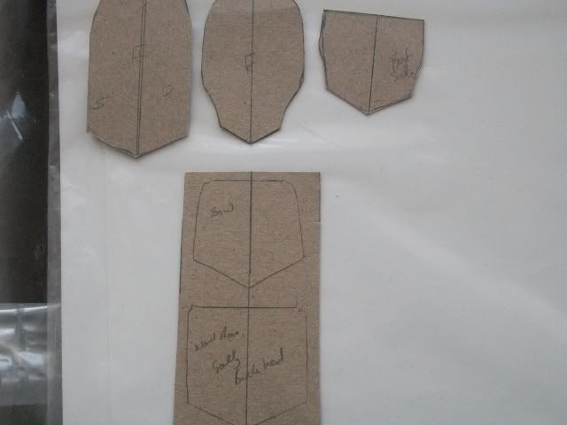

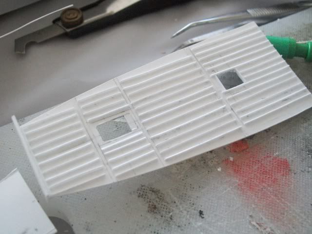

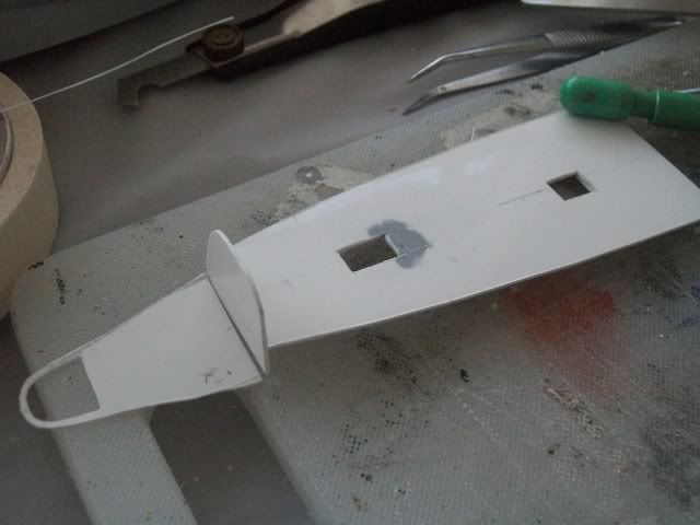

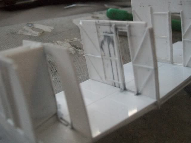

Before going on I have taken a picture of the templates I have made up, to give you an idea of how I have planned
to build the interior

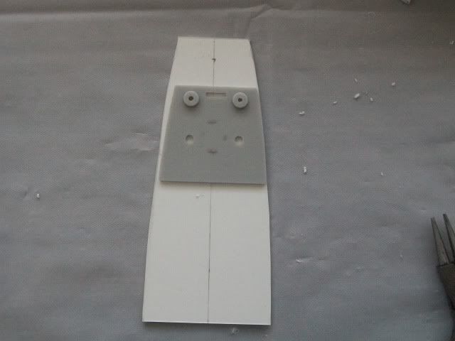

The flightdeck part in the kit is too narrow, so it pays to widen it (modellers litany: fit, sand and fit again until right :bristow: )
I also lengthened it to

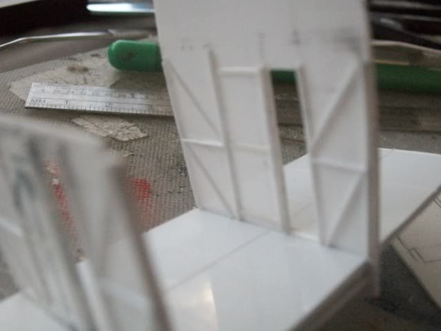

The lower deck partially done
Officers Wardroom
Galley
You can see I have added the Z framing found in both these sections
Edited by LDSModeller

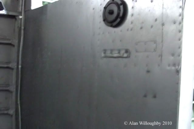

Rear part of the galley wall/front of Bomb bay bulkhead, as you can see I have added the fuel dump pipes which lead through
the floor to the step on the lower hull
Real thing

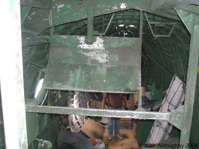

Important Note - Notice the wall in above photos, it's smooth as is the rear bombay bay bulkhead
They don't have the framing as shown on the WEM items

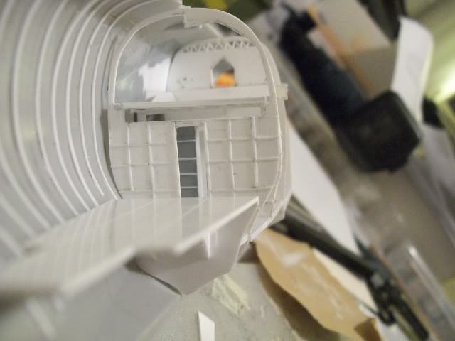

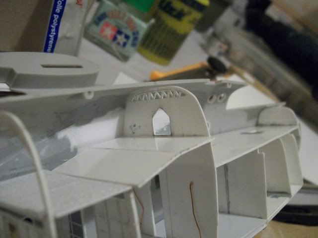

In the photo above of my build you will see the "oven door" in the upper wall/bulkhead
The real thing
Notice the wall/bulkhead it's straight up and down, this backs on to the rear spar also.
Looking from main spar to rear spar and oven door

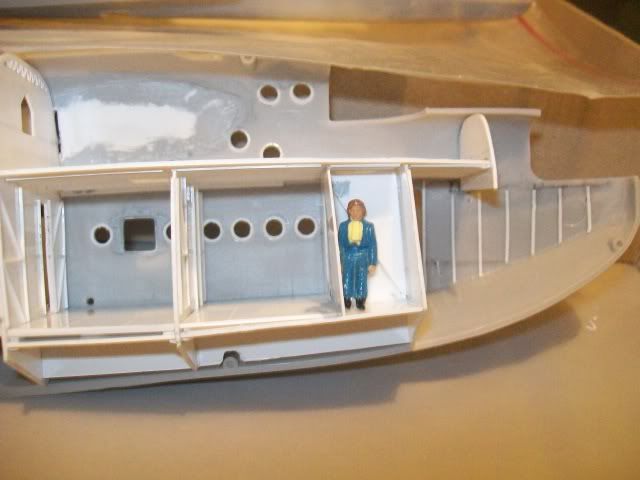

My build

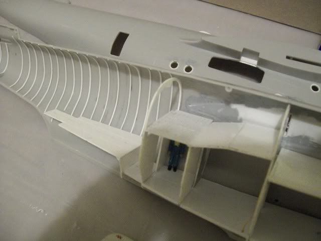

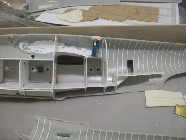

The flight deck upper, with forward minor bulkhead and the turret/bow ceiling (not attached yet)
This shot is the roof of the lower deck
The current build sitting in the fuselage
Notice the little crew member (lets call him Berty) to give some comparison of size (in 1:1 scale he would be around
5'10 or around 177-178cm roughly my height).
If you look at the oven door in the above photo of the interior in the fuselage you will see a lattice arrangemet above it,
part of the lightening structure as in this photo (after painting, this will be covered in "canvas"

Last time I went as far as the bombay
These next set of photos show the entire lower deck complete as well as the upper
sloping deck (which is not currently glued till it's painted) Berty my crewman is modelling for us again tonight.
In this photo you can see Berty standing near the "oven" door getting through that in real terms is a tight fit
In this photo you can see the sloping floor and how it runs to the bottom of the "Oven Door"door
The real thing
In this photo you can see the level upper floor leading to sloping floor, in this photo you might be able to make out
the holes in the floor (similar to bow flooring) this actually forms the roof over the crew ward room
Real thing
If you are wondering what the box like object is, it's a step for when the upper turret was in place. It still came in handy
on Mk V's (post WWII) for the crew to access the hatch above
In the last photo (model) showing the upper deck, you may notice on the upper bulkhead the strange shape in the upper
left, this is part of the reinforcing to strenghten the area for the upper turret
Real thing
The rather interesting object sitting in space, is the gunners foot rest when the upper turret was present
Looking forward toward the rear fuselage bulkheads, you can see the framing (my attempts at)
Real thing
In the last model photo you can see the rear main deck now in place, you can see the cut out at the rear of the deck.
real thing (apologies for the trashy photo things were being moved around/stored)
This link provides a clearer picture (I borrowed this one)
Sunderland rear deck
Couple of shots showing the decking in the Starboard side with Berty again modelling, showing the proximity
to hatch/upper turret
I still have to put in the stern bulkheads and some internal ribbing/stringers, as well as put in the flight deck fixtures,
and the bow flooring etc before I add paint, not far to go there. :hobbyhorse:
Please enjoy
Regards
Alan
