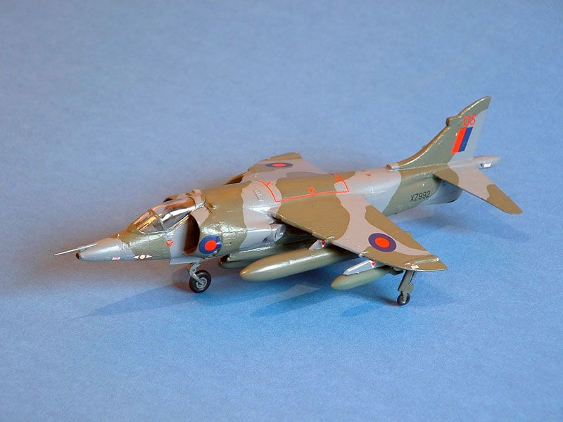

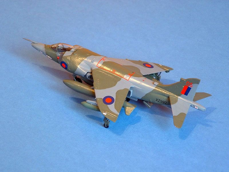

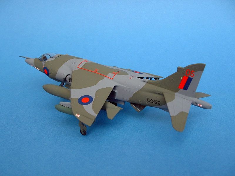

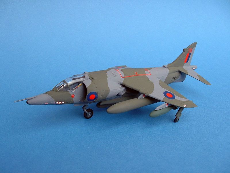

Deanflyer Posted April 10, 2010 Posted April 10, 2010 I've got to agree with the comment about it being the most matt finish I've ever seen. I used some on my Airfix Starter Set GB Harrier, as I didn't want to test it out on a serious project. Thinned only a little with water (thinned it too much the first time) and airbrushed on, it dried overnight quite happily. Before: After: Before: After: Possibly a little TOO matt for my taste - full size objects are rarely dead matt, but tend to have a slight sheen to them. I might try thinning it with Klear next time, instead of water. Maybe that'll work. Cheers, Dean
