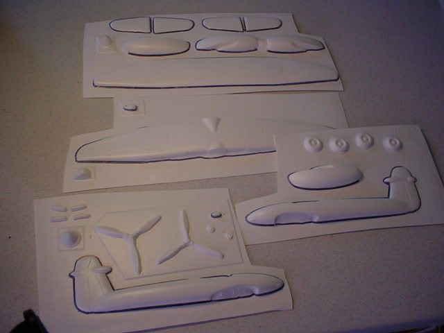

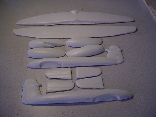

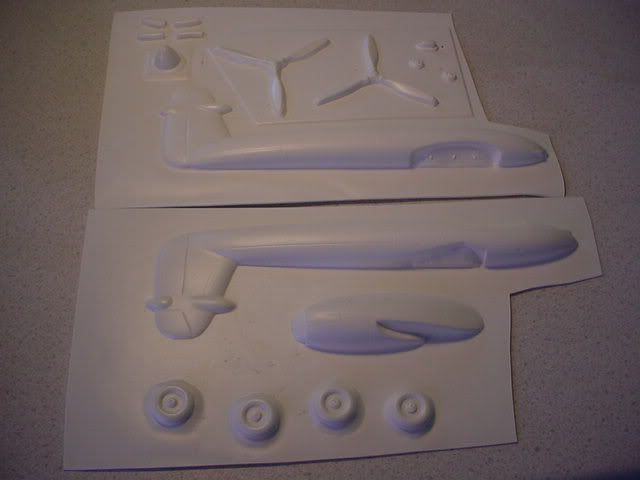

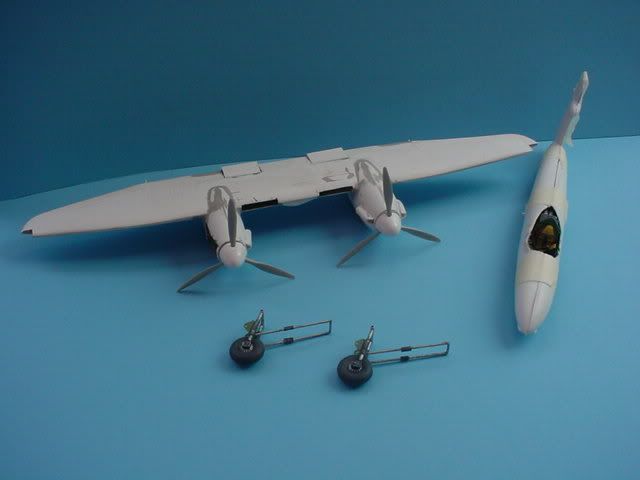

perry Posted May 2, 2009 Posted May 2, 2009 Hi guys n gals! This is another 1st for me, my first GroupBuild. Since finishing my Swordfish, I've been itching to get started on this! Here's my attempt, a Combat Models (I think) 1/32 Westland Whirlwind. Makes a bit of a change from the 'stringbags' I've built lately. Anyways, here's where I started Quite impressed with this, the first time I've seen a 1/32 with panel detail... all marked and ready .......... and .......................... ..... main parts cut out. Smaller parts I'll be using, I've left on the carrier so they dont get lost. Now then, lots of sanding to do.

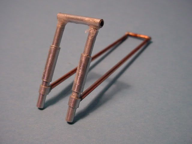

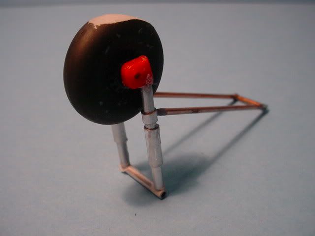

Mike Posted May 4, 2009 Posted May 4, 2009 Pezza... what're the red bits on the landing gear made of? Also, are there any kit parts in that assembly, or is it all scratched? Don't keep us in suspenders man!
perry Posted May 4, 2009 Author Posted May 4, 2009 Mike, the wheels are from a 1/72 Lancaster, exactly the right size according to my plans, The rest is scratchbuilt. The red are just odd bits of plastic from i dont know what, cut off , sanded, shaped and drilled. Hope your suspenders are comfy now
Mike Posted May 4, 2009 Posted May 4, 2009 Mike, the wheels are from a 1/72 Lancaster, exactly the right size according to my plans, The rest is scratchbuilt. The red are just odd bits of plastic from i dont know what, cut off , sanded, shaped and drilled.Hope your suspenders are comfy now They are... we can learn more when you explain stuff

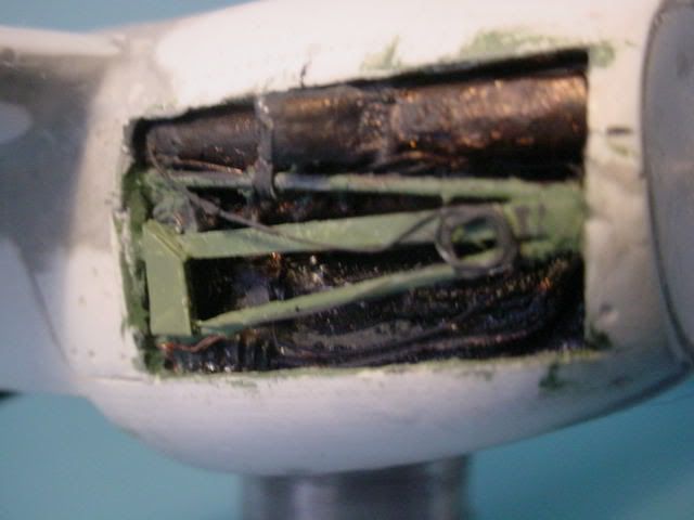

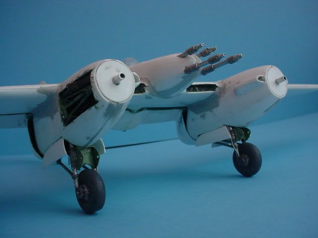

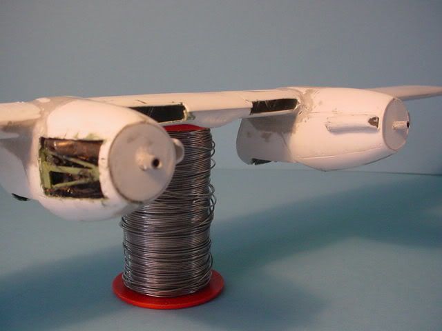

perry Posted May 4, 2009 Author Posted May 4, 2009 Bit more work done, detailing the wheel wells, lots more to do yet. The oil tanks were made from balsa, sanded to shape and a piece of hollow tube for the filler. The strap was made from a piece of thick foil. Decided to have the Fowler flaps dropped, so that meant cutting off the rear of the engine nacelles, made myself more work but, I hope the result will be worth it. Sorry about the pictures, its raining and very dark here crash formed a couple of spinners . Had a spinner from a Spit, wasnt entirely happy with the shape so, snaded the tip down and then crash formed 2 new ones. Thanks for looking, all comments welcome as usual
Mike Posted May 4, 2009 Posted May 4, 2009 Looks good Perry... have you soaked the balsa in CA to allow you to sand it smooth? Stops that hairy look when you slap the paint on
perry Posted May 4, 2009 Author Posted May 4, 2009 Thats a good idea Boss, why didnt I think of that... errm, ......... no used micromesh on it, seems to have a good surface finish and I think it'll be passable

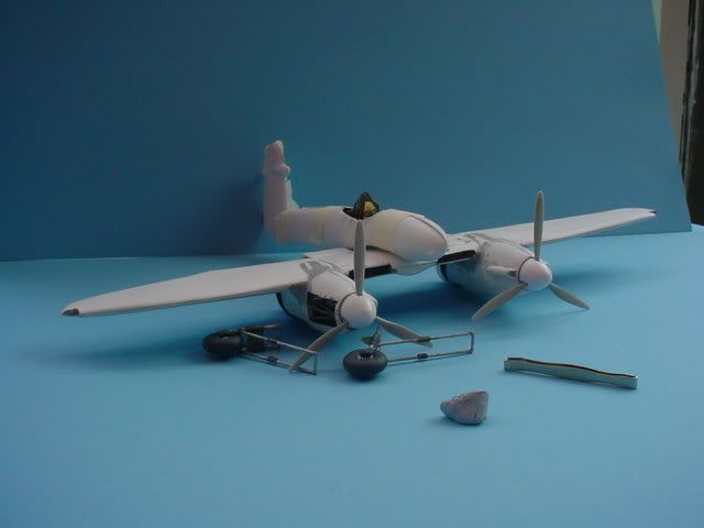

perry Posted June 17, 2009 Author Posted June 17, 2009 A little update. As per usual, whenever I start a project, either modelling or DIY, work always seems to go mad and get in the way. However, I've not been idle in the very little spare time I've had and, there has been progress allbeit, slow and not very much. Here's where I'm up to now. I'm building with one engine panel off showing one half of the pesky engine, its almost finished, plumbing and wiring complete, just a few minor details to finish it off. Used a Merlin from a Revell Spitfire, cut it down to make it fit, scratched the exhausts and manifolds. Scribed and rivetted the wings and engine nacelles using Radu's rivetting wheel (highly recommended) landing lights were drilled out and then lenses were crashed. I used a piece of thin dowel, sanded the end round and then crashed a piece of clear plastic to get a dome shaped piece, then glued to the insides of the bottom wings. The Fowler flap is cut. had to make a master and crash form a couple of new engine nacelle rear ends. They're attached to the Fowler flap and work is still in progress on them. These are being a real PITA at the moment! And as you can see, work has begun on the IP, using a piece of beer can drilled out and a piece of clear plastic crashed through the drilled out holes. MDC instrument dial decals were then applied on another piece of beer can and this was then glued to the back of the square panel. Its shown here blue tacked for test fitting. More instrument have yet to be added. Thanks for looking

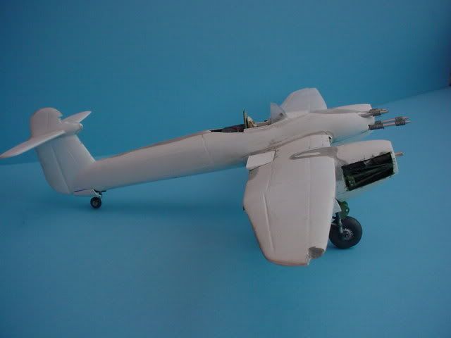

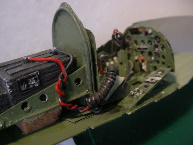

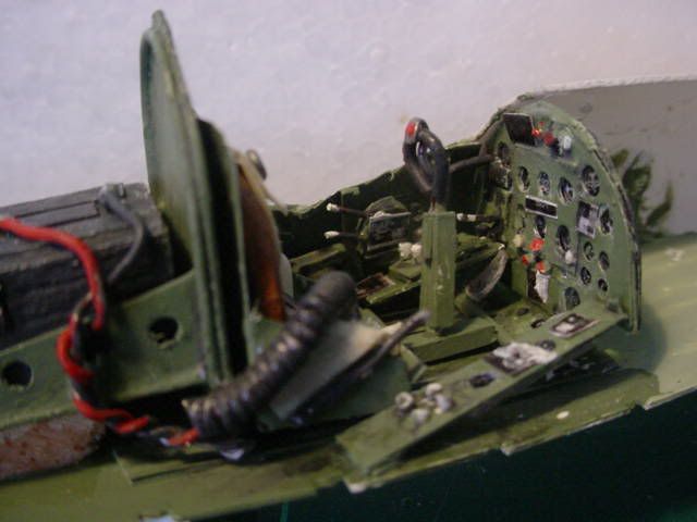

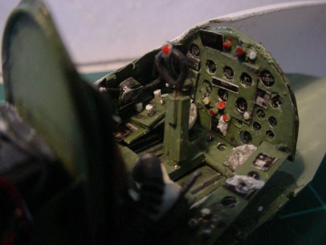

perry Posted July 11, 2009 Author Posted July 11, 2009 Hi everyone, been a little quiet with my build but, here's a little updat. The cockpit is all but finished, not 100% accurate but, all scratchbuilt and, I'm fairly happy with the results at the moment (no doubt there'll be something I'll change, usually is!) The seat harness will need repainting, not happy with that, (its not really yellow, the light is doing that) to me the rest will do. I'll try to get some better picture of the cockpit interior in the next couple of days. the main components just about finished.... .........and dry fitted, almost starting to look like a Whirlwind! Thanks for looking, all comments welcome Pez

perry Posted July 12, 2009 Author Posted July 12, 2009 Hiya boys n girls! here's the Whirlwind cockpit almost finished, hope these pics turn out better than the last ones! All comments welcome Thanks for looking Pez

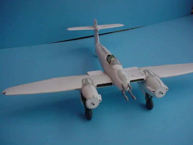

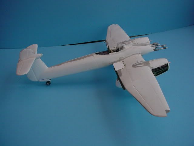

perry Posted August 24, 2009 Author Posted August 24, 2009 Hiya guys n gals, another little update. Progress is at my usual snailpace due to other commitments but, at least there is some progress. Thanks for looking
