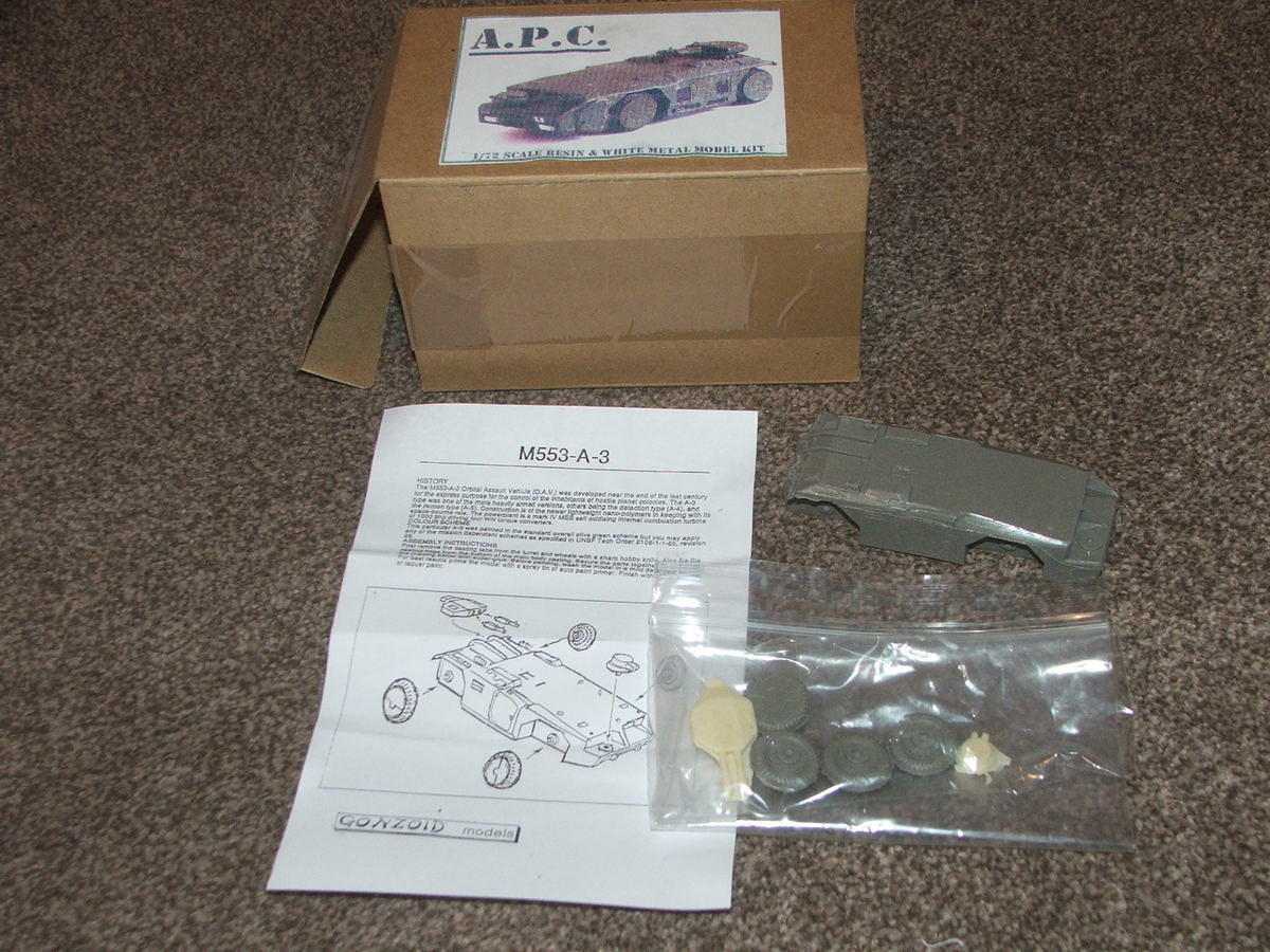

I present the legendary Aliens Dropship by Halcyon. I'm teaming this up with a resin APC by Gonzoid Models, sourced from Comet Miniatures. I'd love to get my hands on the Halcyon APC but its the wrong scale to work with the Dropship. My intention is to build a diorama of the "deploy and dust off" moment in the movie. The closes you get to see of this is screencapped here:
as the action switches from the dropship flying in over the complex to a close up of the ramp touching down and the APC deploying before switching back into the two shot shown above.

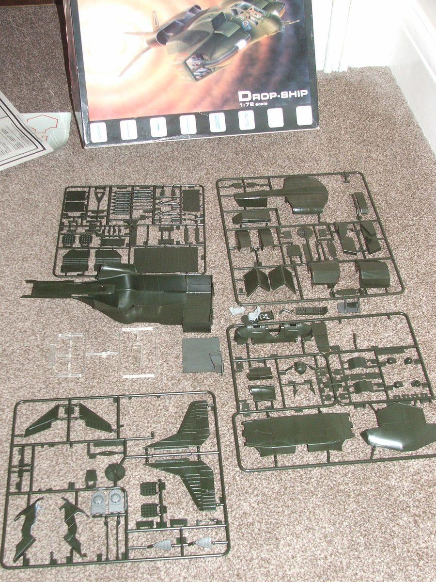

So here is the box and sprue shots in preparation for the build starting at the weekend:
I can't wait to begin - I may have to build this one before my Hawker Hunter Miss Demeanour for the Hunter GB!!

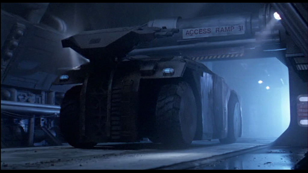

In that screencap you can also see how inaccurate the main gun is. I'm alrady planning to replace the barrels on the front cannon as the mouldings on these were essentially just blobs. you can see how they are supposed to look here:

Wow excellent resources, thank you. Some great photos there which shows even more how unrealistic the wheels are on this resin kit.

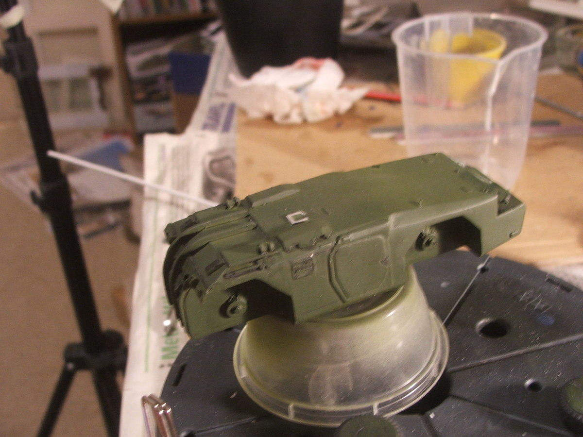

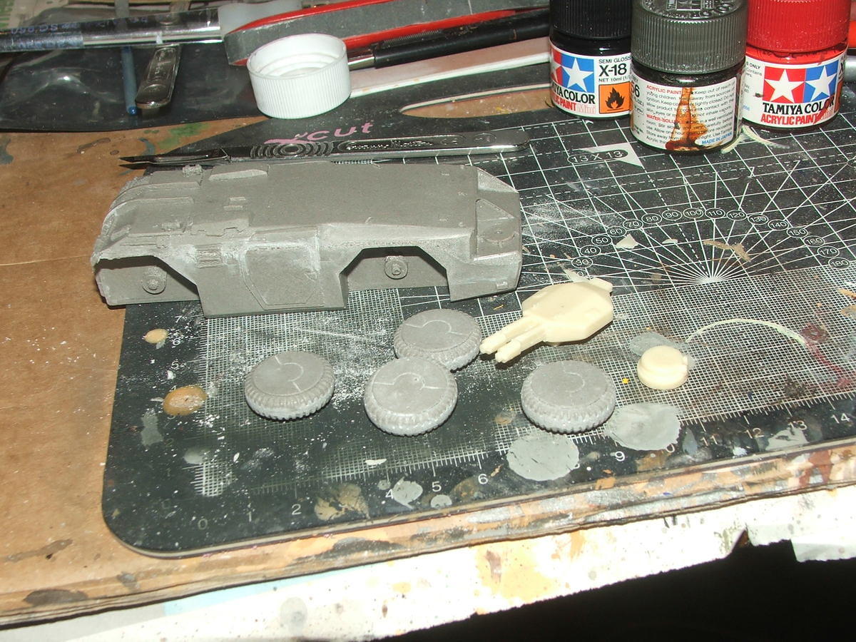

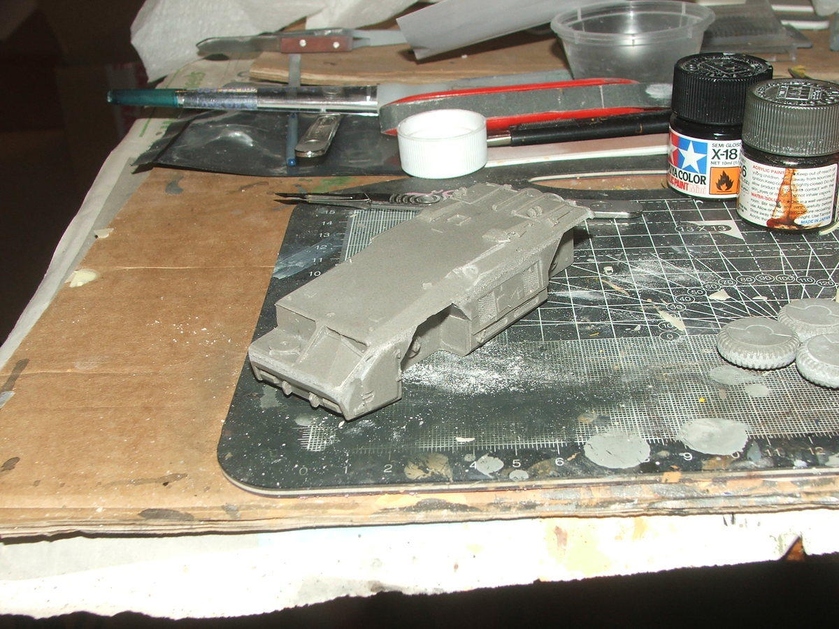

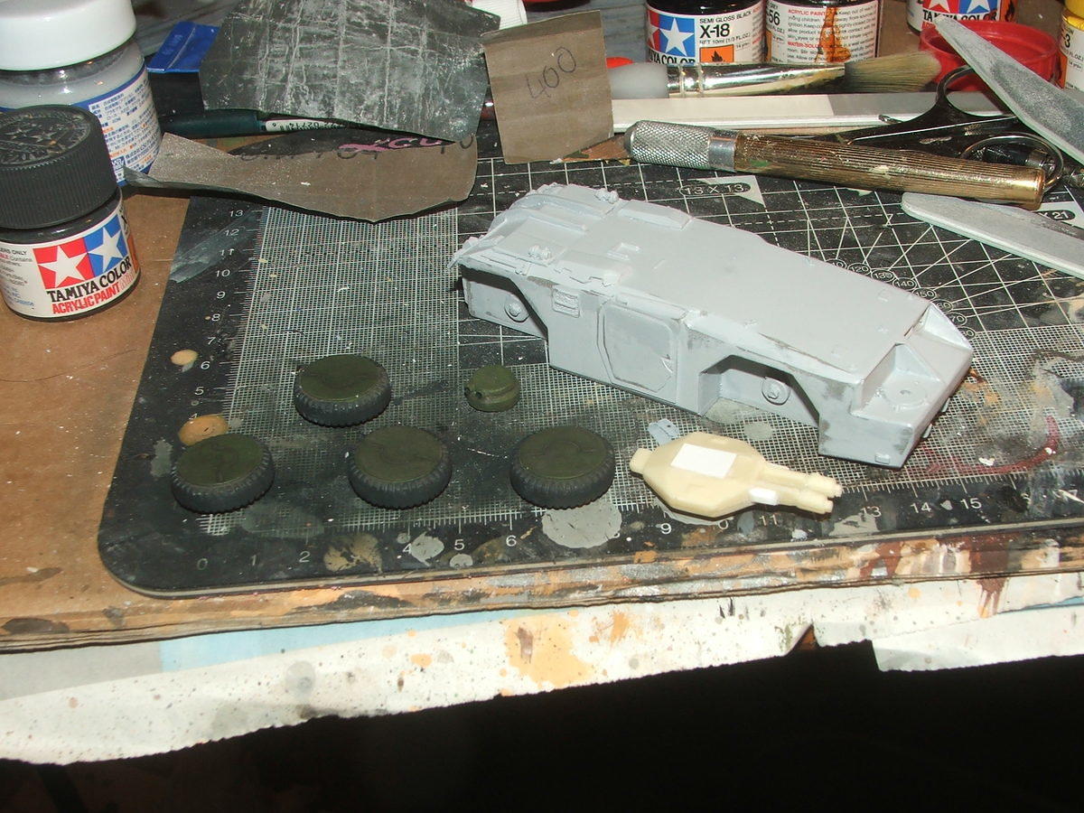

I hate it when I can smell resin while sanding! Its not a good sign coz it means your mask is leaking and you could be breathing in that nasty shi**! This block of resin has needed a lot of sanding to get rid of the truly awful moulding lines. Its now been primed, filled and sanded a bit more.
There were several "gaps" and pits that needed filling - some of them appeared to be seams on the original master that didn't fit well.
The wheels got a good sanding as well. They are now much flatter than they were which makes them look more like the originals, but they are still too skinny by far. However I'm just going to live with that as I don't feel up to scratch building something this small. They've been painted up as you can see and look fine to me.
I've also painted the front turret and drilled out the cannon nozzles. As you can see from the previous pictures, these cannon seems to have some sort of star-like fitting in the muzzle, however at this scale I don't think I've got anything that can reproduce that look so it stays as it. I've added some bits to the main cannons to bulk out the barrel and add the plate on the upper surface that is visible, particularly this one which is of the RC model used in the movie
I'm about ready to give the main body its coat of Nato Green, stay tuned...

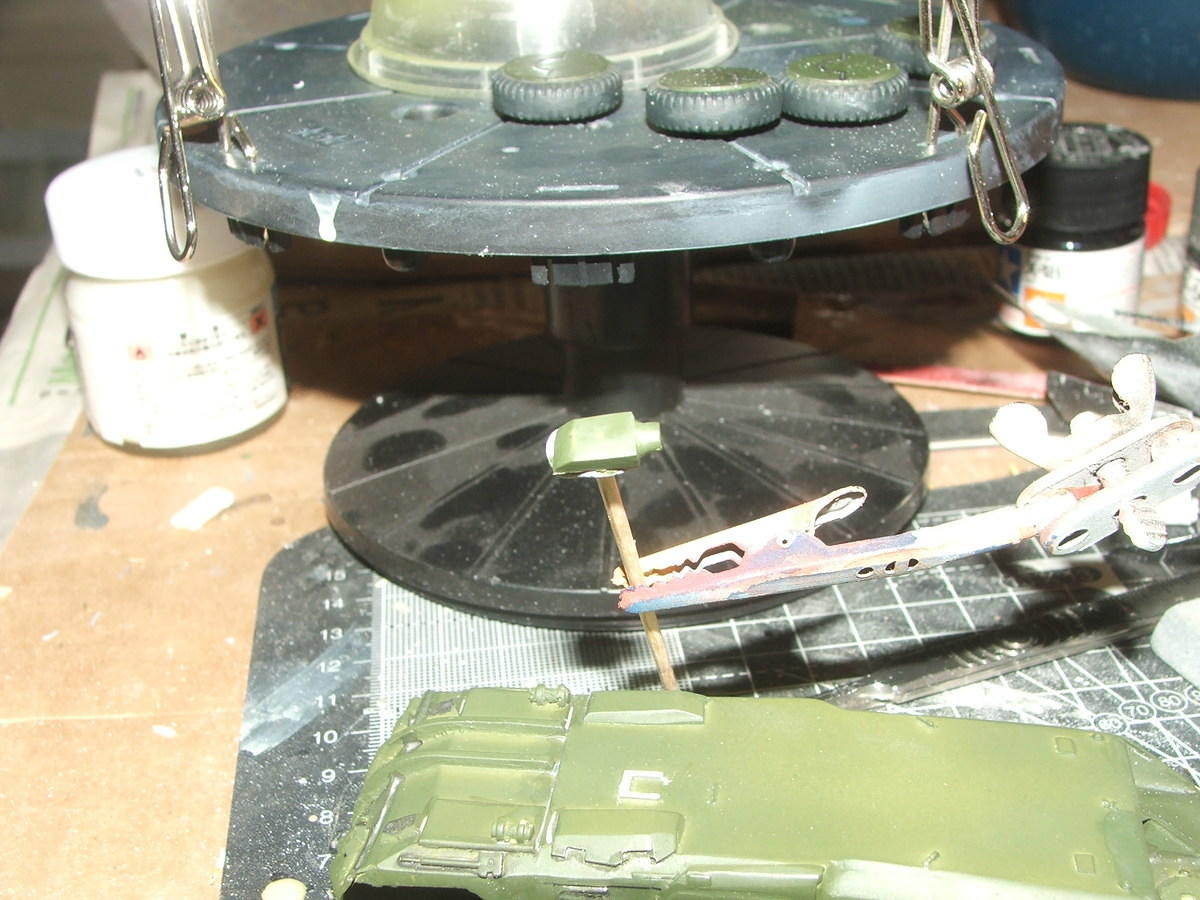

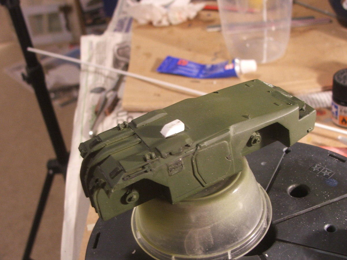

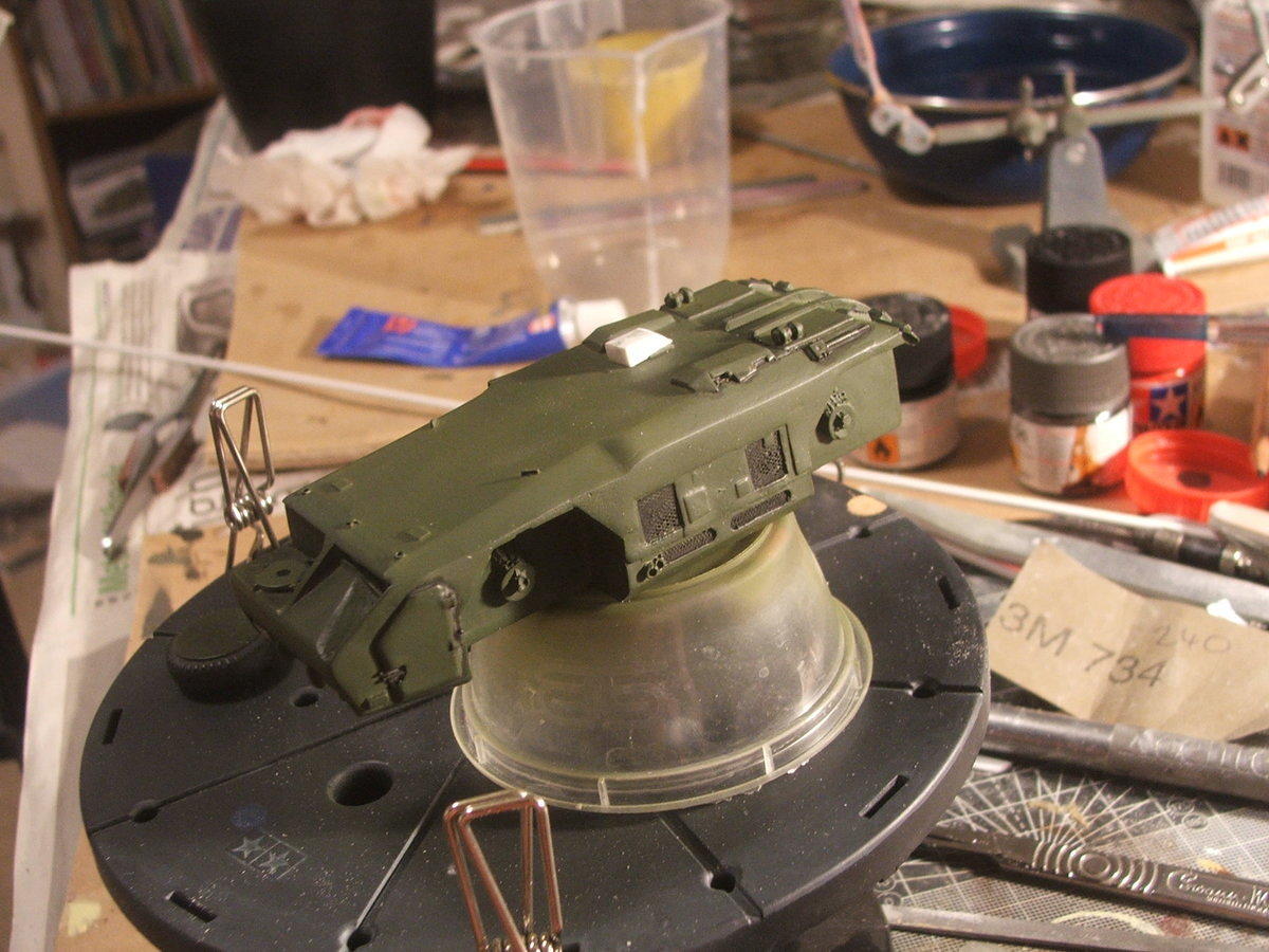

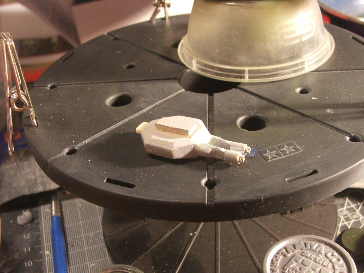

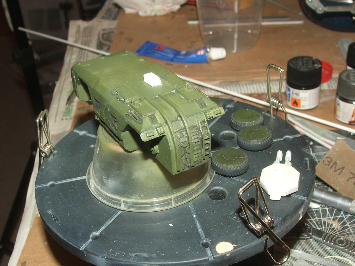

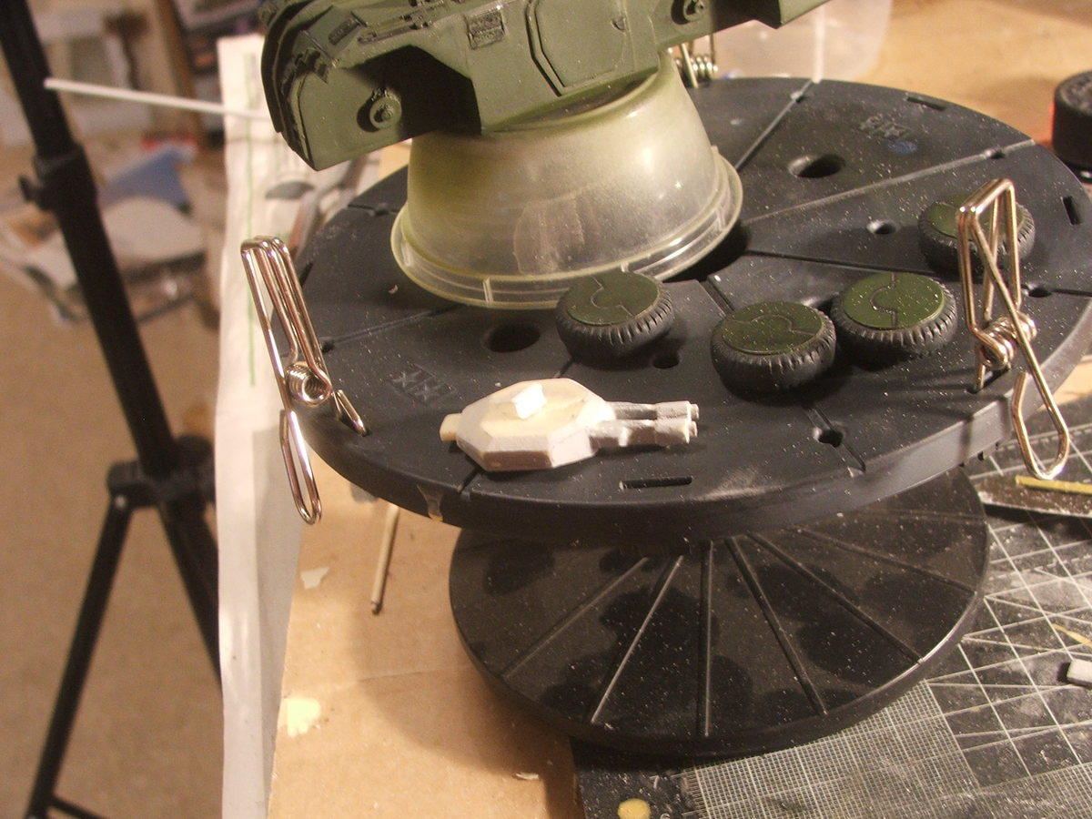

More done yesterday: First off lets look at the main gun. I've added a couple of small plastic card shims to the outer sides of the barrels to give them more a more accurate shape. Plus that large block to attach it to the APC has to go!
So its beem removed and replace by a short strip of I beam girder that will sit nicely between the two rails cast intot he main body. It will also allow the gun to have a more "dynamic" angle.
Next, there is a funny "U" shaped casting on the top of the APC, visible here where its been sanded down a little
This appears to be a fitting for something but nothing was included in the kit. Looking at my research I discover that its a spotlight fitting which has a wire guard in front of it. This is visible here:

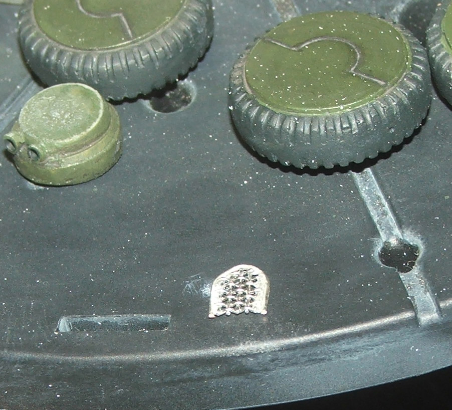

So lets start by scratch building the spotlight. Its little more than a rectangular block with a curved back edge with a light stuck in the front a bit like this:
and when painted up:

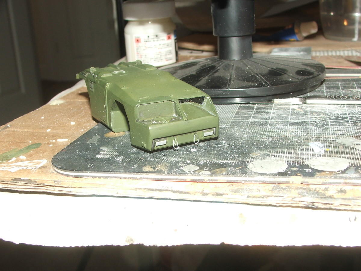

This shows the rear of the APC after its had a black wash
So for the wire guard to go over the front I've used some steel mesh I've got in the Meccano spares box along with some 10A fuse wire for the out frame to create this:
So also noticable in the vidcap above is the shackles on the front of the APC, so these were added with some fine wire:
So thats where I got to as of this morning. This afternoon, I'm applying a wash to the overall APC body, the main gun will get painted and the spotlight and guard will also be attached. If this goes well, the wheels may go on as well!
And so dear reader, we come to the end of Act 1: The APC.

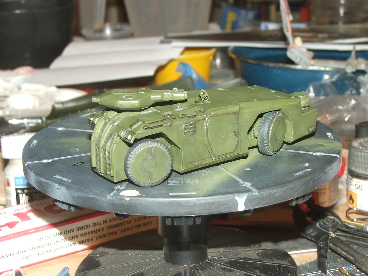

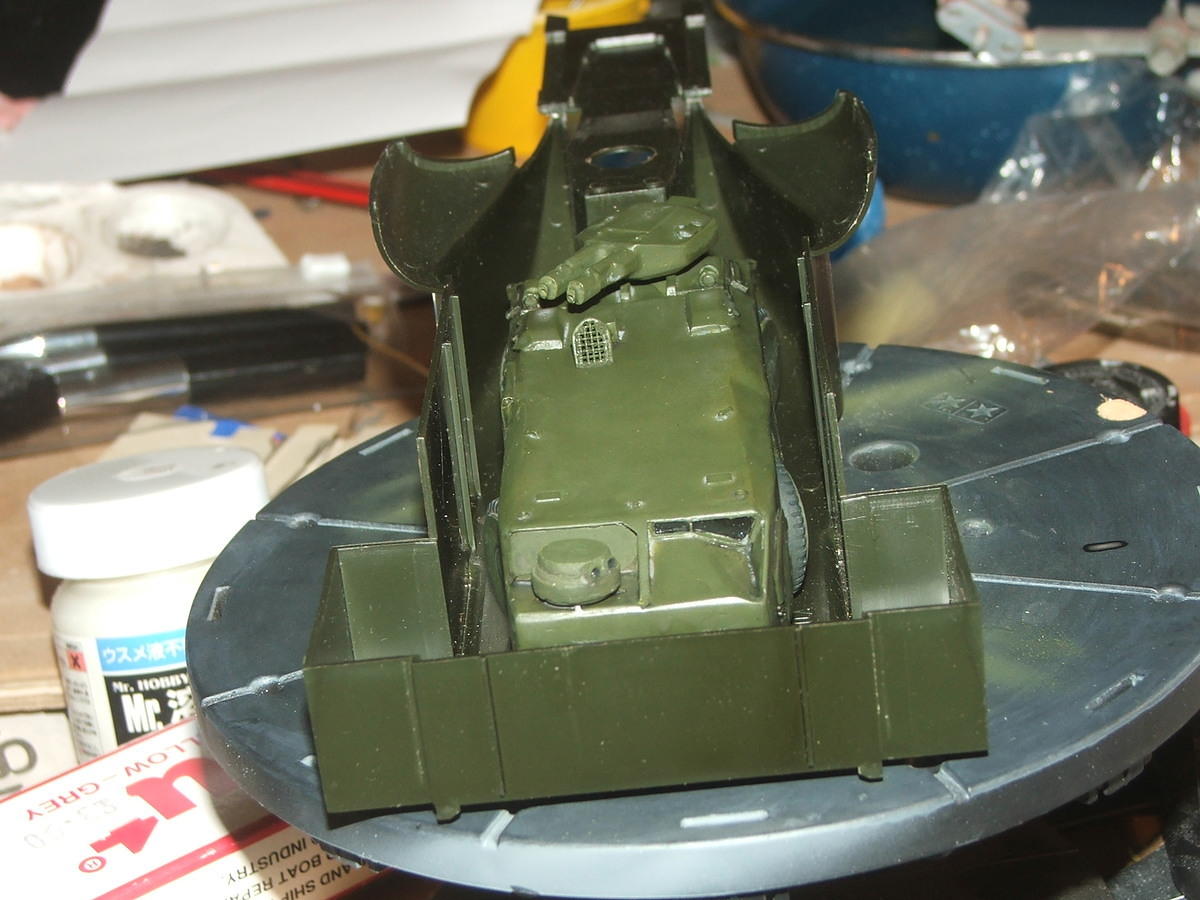

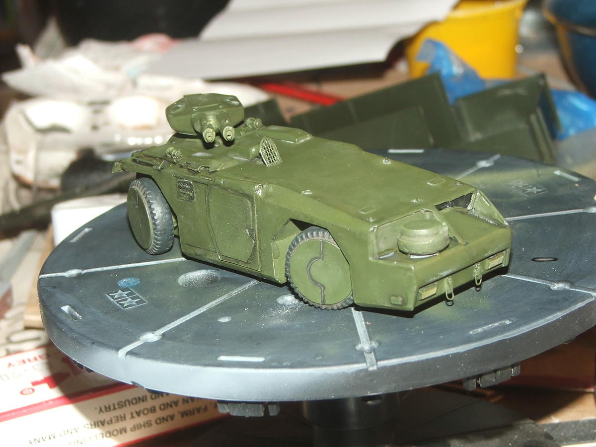

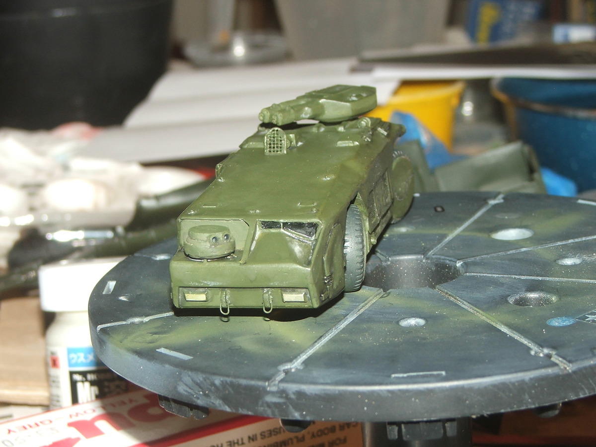

Wheels on and set turning. This vehicle is 4 wheel steering, so I've set both sets of wheels in a turn. These are packed with milliput to give support to the axle joints.
You can see the spotlight and guard on the top of the APC - turned out quite well I'm pleased to say.
Its been given a black wash, but no further weathering for now. There will need to be more later, but I'll hold off until I can see it in context with the rest of the diorama before getting heavy on the weathering.
Well thats the easy bit done. Next: the Dropship. First task is goign to be opening up the bottom of the fuselage to create the bay for the APC. In the first picture above you can see the landing ramp behind the APC. I'm going to use this to mark up the hole that needs cutting.

Mmm....that's very tasty. Wheels turning look great.
You've now got me looking at my 1/35 built-when-I-was-a-kid APC thinking I might strip it down and rebuild it!
Cheers,
Dermot
Its amazing how much life can be added to a model if you just steer the wheels!

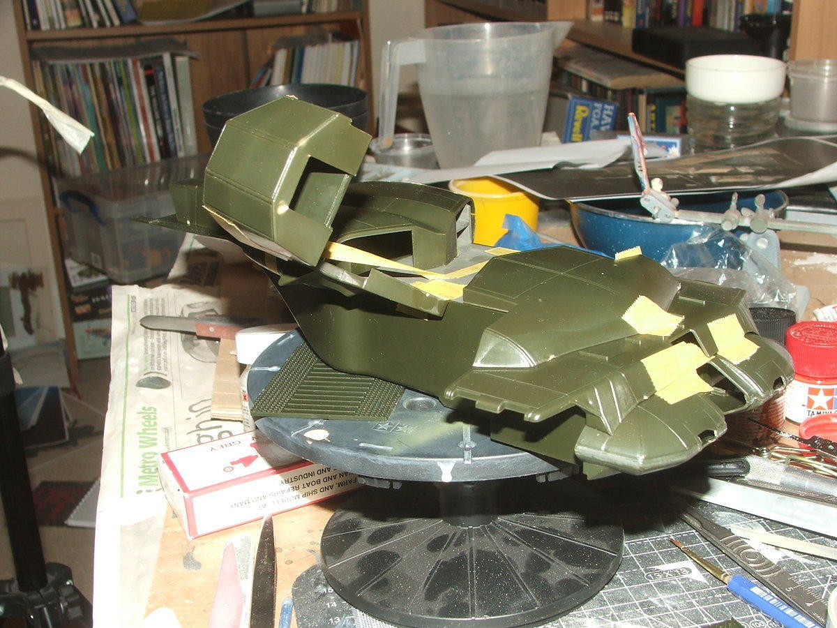

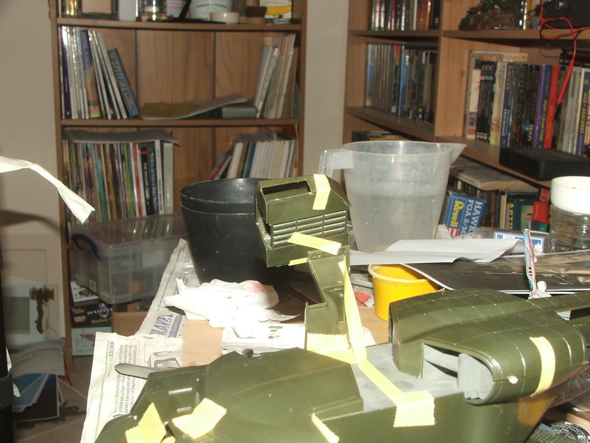

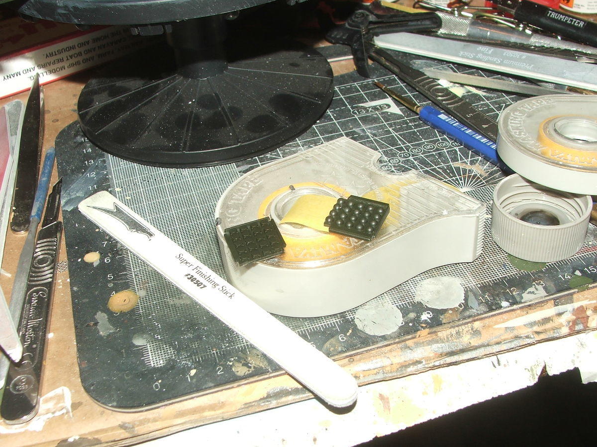

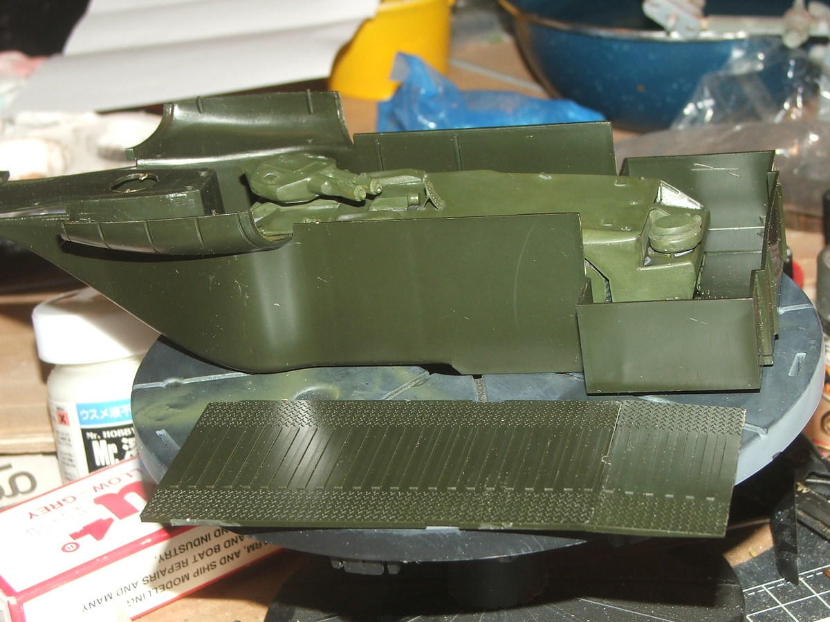

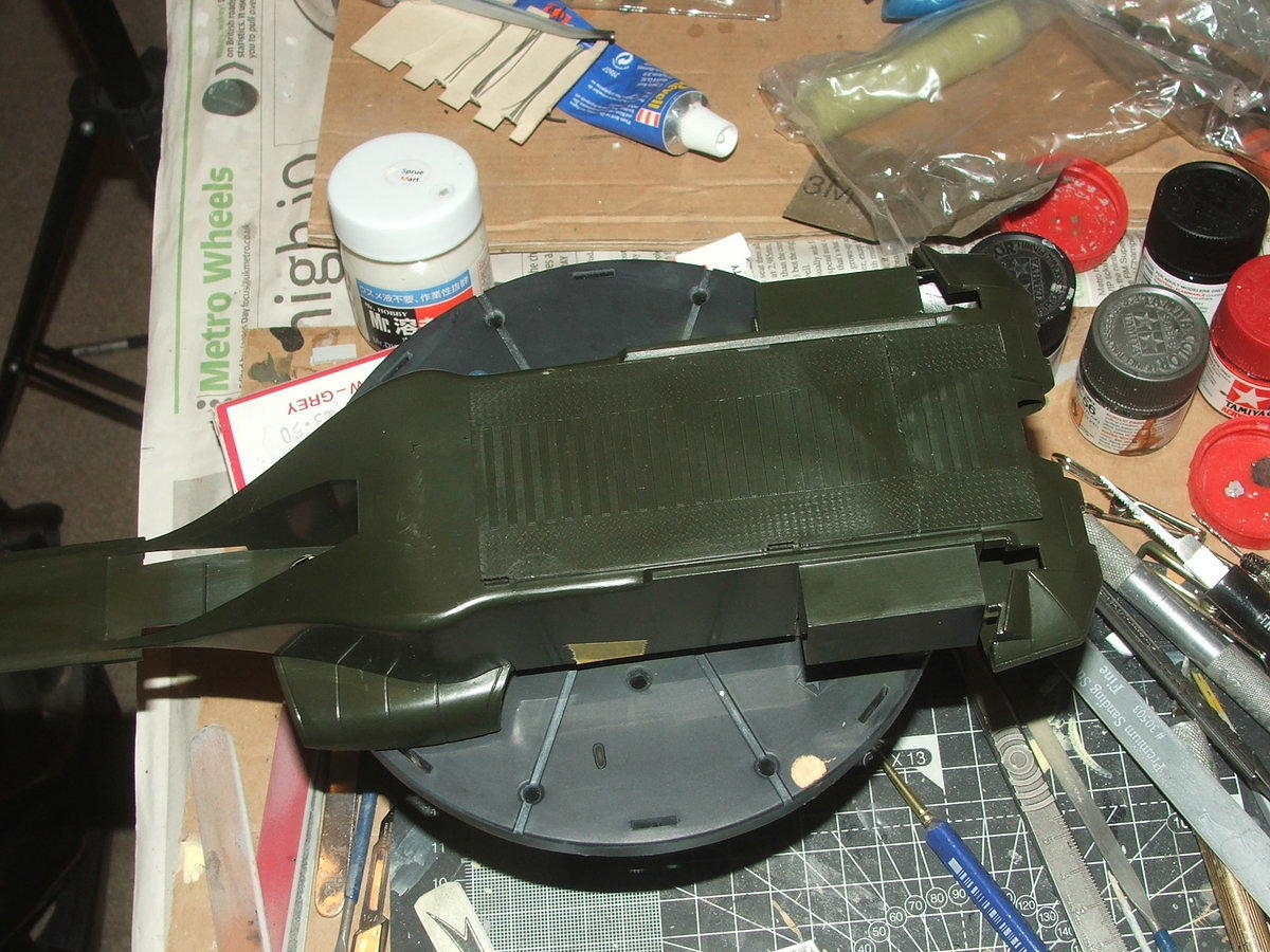

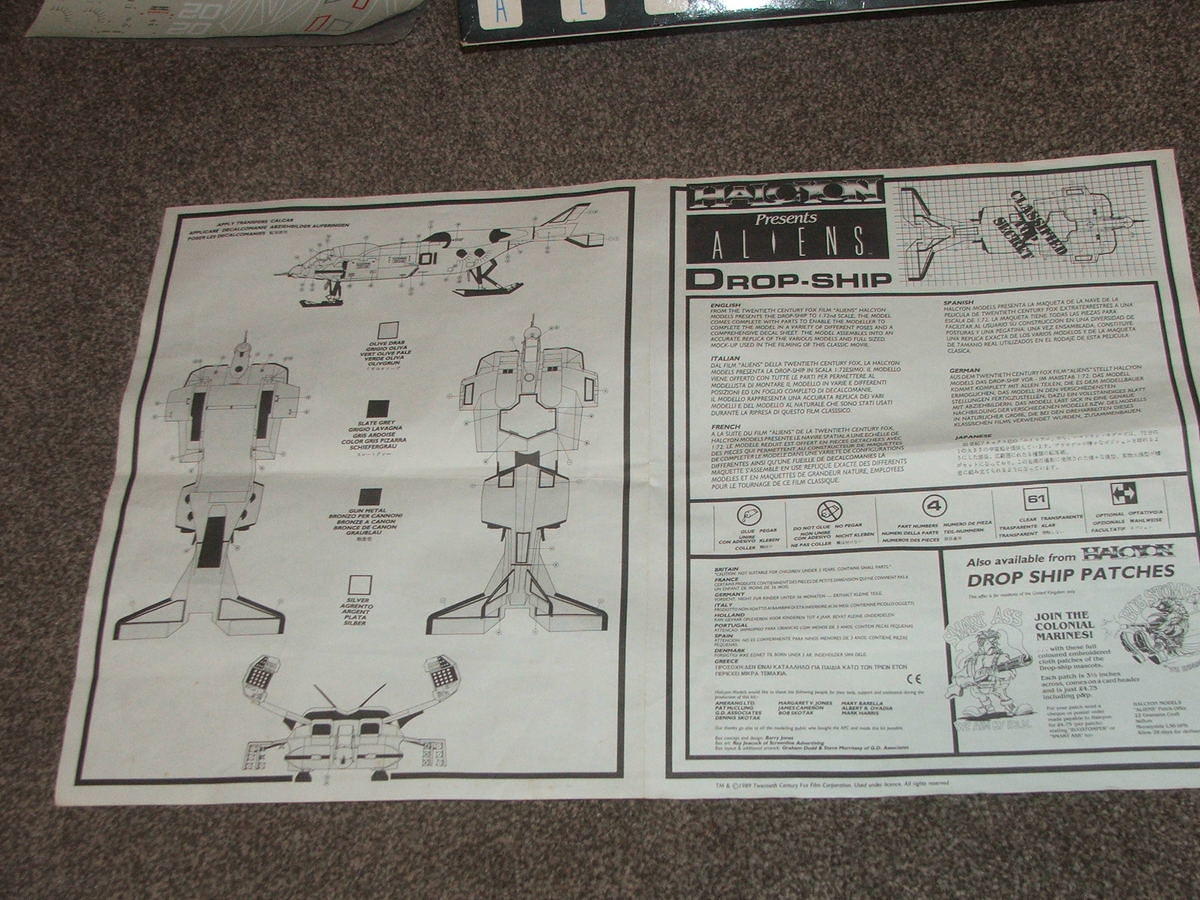

After a couple of days away from the modelling table as a break, I'm back with the dropship. Just as an experiment, I tried a btt of a dry fitting to see how things went together. Its an odd shape and I didn't fully understand where the main component went until I did this:
and here is the missile pylon
and the inserts that are supposed to represent the tip and tail of the missiles
In comparison this is what its supposed to look like:
One of the first things that is immediately obvious is the number of missiles is wrong. In the movie, it 4x4 but the inserts have 5x4!

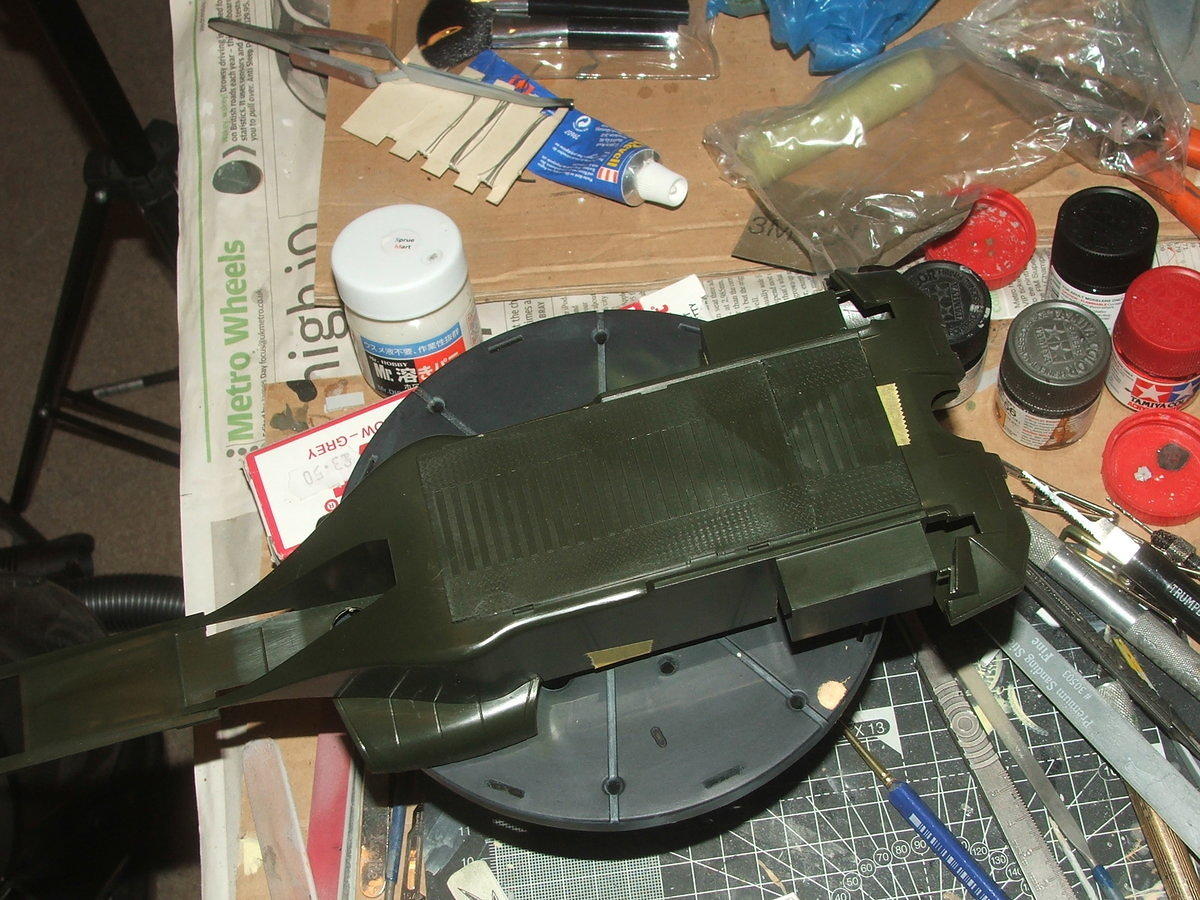

For the APC bay, as you've already seen in previous photos, the base of the dropship is solid, even though there is a ramp, there is no opening to the bay. So we are going to have to cut a hole and build a bay! Here we see the ramp placed against the base of the dropship where it would have folded up.
As you can see its too long and will overlap the front part, so we move it backwards a bit and it will fit:
I'll have to scratch build and interior of the bay but fortunately, there are a couple of shots in the movie that give you an idea of whats inside:
So its going to be out with the plasticard and some scratch building!.

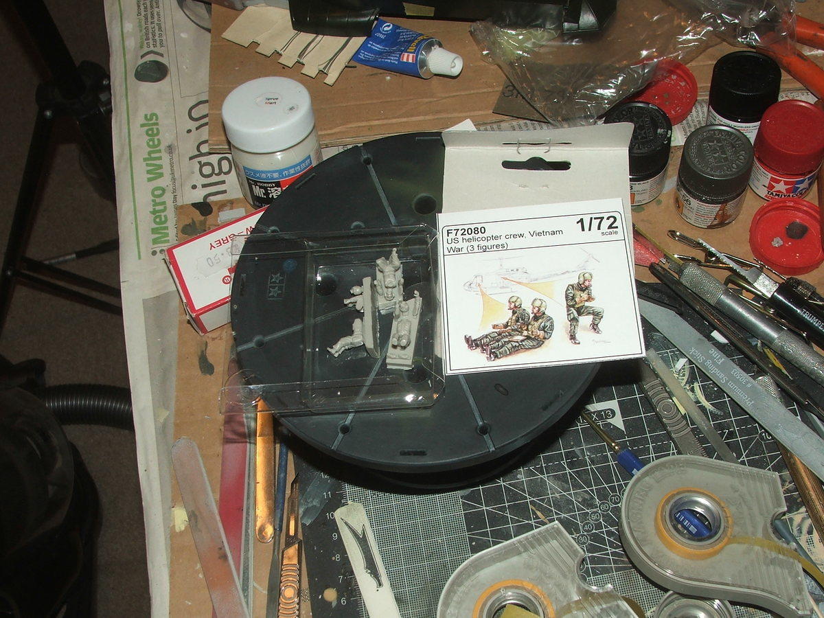

For the cockpit, I have some US chopper pilots from CMK I can use and to detail the cockpit (which OOB is empty apart from a couple of bucket seats, I've got an order in for some cheap resin ejector seats and some PE consoles. I basically chose the cheapest sets I could find from Hannants! I think the resin seats are Aries seats for a Tomcat and the PE is for a Phantom. Here are the pilots:
Sadly one is not female so Cpl. Ferro may need some surgery! Pvt. Spunkmeyer will be okay as is I think!
