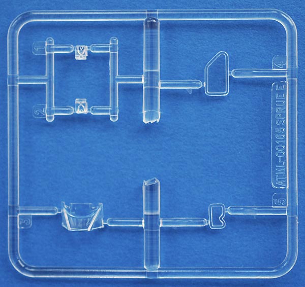

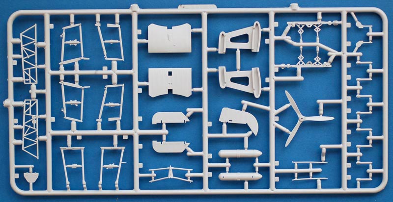

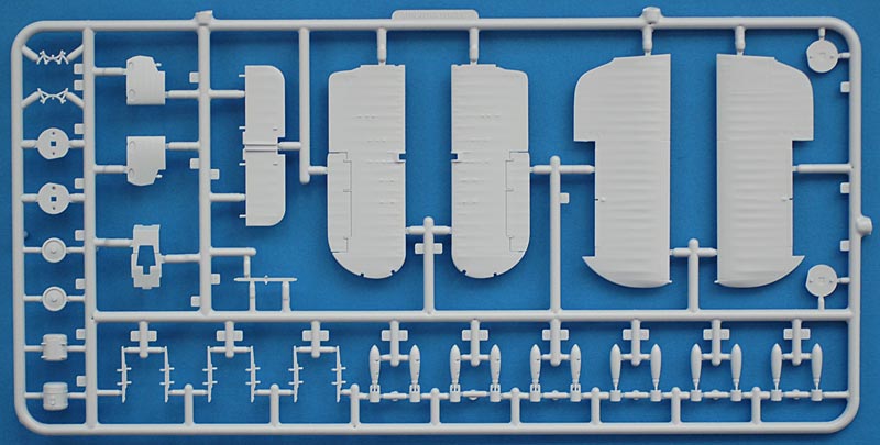

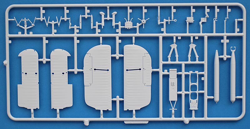

Paul A H Posted December 28, 2011 Posted December 28, 2011 Fairey Swordfish Mk.I 1:72 Airfix Of the hundreds of types that saw service during World War II, the Fairey Swordfish was one of the handful of aircraft that can be said to have passed from history into legend. The ungainly fabric-covered biplane flew in for the first time in 1934 and entered squadron service with the Fleet Air Arm in 1936. Designed as a torpedo bomber and spotter-reconnaissance aircraft, the Swordfish was also used for other roles such as anti-submarine warfare. Despite its antiquated appearance, it was still in squadron service at the time of Germany’s capitulation in May 1945. Nicknamed the ‘Stringbag’ because of the wide range of loads it could carry, the list of key actions the Swordfish was involved in is the stuff of legend. It took part in the attack on Taranto Harbour and played a key role in the destruction of the German battleship Bismarck. Engagements such as these demonstrated not only the tough, dependable qualities of the Swordfish, but also the professionalism and bravery of the crews that flew them, often in the face of heavy losses. Packed into the surprisingly large top-opening box are four sprues of grey plastic and a single, small clear sprue. Together they hold a total of 125 parts. The sprues are cleanly moulded with reasonably fine attachment points. A quick examination of the sprues reveals that the level of detail Airfix have achieved with this kit, both in terms of moulding and engineering, is outstanding. The panel lines, few that they are on a Swordfish, are reasonably subtle. Airfix have also taken great care to achieve a realistic stretched fabric texture on the flying surfaces and fuselage, and they have done so very successfully. It’s clear that Airfix have pushed the boat out with this kit and it looks as though it has been designed with the enthusiast in mind. The interior is made up of no fewer than eighteen parts including the internal framework structure, crew positions, a beautifully detailed radio, a moveable Lewis gun for the aft cockpit (along with spare magazines) and the forward-firing Vickers gun. The only slight downside is that the instrument panel detail is represented by a decal. This is an odd choice as the radio set features some lovely moulded detail, but that aside this is one of the best cockpits I’ve seen in a 1:72 scale model. The detail-fest doesn’t end once the fuselage halves and floor have been fixed together. The oil cooler that is a prominent feature of the starboard front fuselage is superbly detailed, as is the engine and cowling. The cowling itself is made up of a four parts. This may seem a little over-engineered to some, but as mentioned above this kit seems to have been designed for enthusiasts and so fewer shortcuts have been made at the expense of detail. Moving onto the flying surfaces, it is clear that Airfix haven’t made any compromises here either. The elevators and the rudder are all fully poseable and feature nice hinge detail. The tailplane strut is moulded in one piece for ease of assembly, although this has left it with a small sink mark on the underside, albeit in a very easy place to fill). The kit can be finished with wings extended or folded. This is where Airfix’s clever design really comes into its own. The interplane struts are joined at the bottom so that the parts form a square ‘U’ shape. The horizontal part that helps align the vertical struts is then partly hidden between the upper and lower halves of the upper wing. This method of construction ensures that everything joins up at the correct angles and the finished model should have more strength as a result. If you decide to build your Swordfish with the wings unfolded, a separate spar must be inserted in the centre wing section. If you want to build your Swordfish with wings folded, this spar is omitted and the two jigs that can be seen on the sprue above are used to align the wing sections while they are glued together. This makes a complex stage of construction as simple as possible for all those biplane phobics out there (and I count myself amongst them). Plenty of choice is provided when it comes to ordnance, including bombs, a flare, an auxiliary fuel tank (as carried on the Taranto raid) and an air-launched torpedo. Airfix have even included a ground handling trolley/jack for the torpedo. Two options are included on the decal sheet: • K8393/E5A as flown by Captain Oliver Patch RN and Lieutenant David G. Goodwin RN, No.824 Naval Air Squadron, Fleet Air Arm, HMS Eagle, Operation Judgement against the Italian fleet at Taranto, Italy on the night of the 11th/12th November 1940. This is the aircraft featured on the box artwork; or • K8499, No. 820 Naval Air Squadron, HMS Courageous, March 1939. This aircraft is finished in the pre-war scheme of natural metal/silver dope. The decals, printed by Cartograf, look excellent. Conclusion Airfix’s final release of 2011 sees them end the year with a real bang. This feature-rich kit should please even the most detail hungry modeller, although the inclusion of jigs and other clever tricks to aid alignment of the wings help ensure that the kit doesn’t alienate the casual modeller either. This is a superb kit of which Airfix can justifiably be proud. I can’t wait to see what they come up with in 2012. Review sample courtesy of
