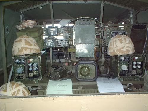

Dads203 Posted April 19, 2008 Posted April 19, 2008 (edited) Hi Richard, I suspect that the WMIK's have a clip in kit rather than a FFR fit, As an ex signaller myself most of the infantry land rovers were fitted with a clansman clip in kit, this allowed the crew to dismount the radio and use it as a manpack. We used Land Rovers with a dedicated radio fit (Land Rover FFR) These were hard wired with all the misc equipment such as 12V batteries, TUAAM boxes on the front fenders and normally a bracket for a Racal PU 8 mast on the side. The radios I used were the VRC 321 (HF) and the VRC 353 (VHF) and the PRC344 with a clip in kit (UHF) ground to air comms The clip in kits I have used can be fitted to a Landrover GS in about 30 minutes and they take the standard PRC range of radios (PRC =Manpack) Clansman Twin VHF VRC353Z fit on the botton, cypher units were fitted in the back, a VRC 321 HF set is on the top left with the SURF unit on the right. Fitted in an AFV436 ( my old wagon) Twin VRC353 fit with a PRC 344 ( manpack) using a clip in kit in the center Hope that helps mate Dan Edited April 19, 2008 by Dads203
