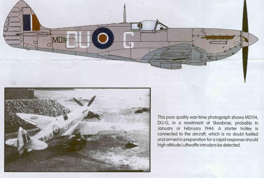

sanguin Posted July 21, 2010 Share Posted July 21, 2010 Philippe,Personally I would go for Sky, as you say not white, only leaves Sky as a paint they would have to easily have to hand...... Colin Philippe, The Kopro 1/72nd Spitfire VII kit sheet has codes in Sky for 602 Squadron (MD114 DU-G) when in the Orkneys (note this, Colin!) Feb 1944 when it shot down a Bf109 recce fighter, Sky for MD188 PB with no other code from Culmhead Wing June 1944, Sky for ON-W, no serial visible, of 124 Squadron, Bradwell Bay June 1944 and Sky with thin black outline NX-O MD120 of 131 Squadron, Colerne March 1944. The last one is 'named' Spirit Of Kent in white on the fuselage ahead of the cockpit port side. All are Medium Sea Grey over PRU blue. DU-G has r/w/b fin flash and fuselage roundel, the others have just r/b fin and fuselage roundels; all have r/b upper wing roundels and no lower wing roundels at all. PB and ON-W have full w/b/w/b/w invasion stripes above and below the wings with full fuselage stripes as well. I have no other references for their markings, just the kit itself so I cannot give any honest credibility to the Kopro choice of colours or even overall schemes, but it ooes seem to follow the trend that others have suggested. Perhaps they followed the same logical path that everybody else has followed. It may not be correct, but it is the most reasonable choice! Best Wishes, John Link to comment Share on other sites More sharing options...

Ed Russell Posted August 1, 2010 Share Posted August 1, 2010 The Kopro 1/72nd Spitfire VII kit sheet has codes in Sky for 602 Squadron (MD114 DU-G) when in the Orkneys (note this, Colin!) Feb 1944 when it shot down a Bf109 recce fighter For what it's worth, the Red Roo team looked at this photo and went for white codes for MD114. (It was actually assigned to the Skeabrae station flight rather than a squadron). I doubt there will be a definitive conclusion to this question but it's all interesting! Link to comment Share on other sites More sharing options...
Seahawk Posted August 1, 2010 Share Posted August 1, 2010 The Kopro 1/72nd Spitfire VII kit sheet has codes in Sky for 602 Squadron (MD114 DU-G) when in the Orkneys (note this, Colin!) Feb 1944 when it shot down a Bf109 recce fighter For what it's worth, the Red Roo team looked at this photo and went for white codes for MD114. (It was actually assigned to the Skeabrae station flight rather than a squadron). I doubt there will be a definitive conclusion to this question but it's all interesting! That photo, together with another of the same aircraft, appears on p.80 of "Spitfire At War 3". With better reproduction there's a pretty clear tonal variation between the white of the roundel and the code letters, so again my favoured non-white suggestion is sky. NB the black area on the wingroot: would be interested in thoughts on whether this is a painted walkway area or maybe a rubber mat. Nick Link to comment Share on other sites More sharing options...
GrouchoMark2 Posted August 1, 2010 Share Posted August 1, 2010 Hmmm -not sure about that Kopro drawing. Appears to have a mark VI nose grafted onto a MkVIII body:- 3 outlet exhaust , gun heater tube, high rear canopy and no rails, voltage reg behind seat. Very misleading Groucho Link to comment Share on other sites More sharing options...

Colin S-K Posted August 1, 2010 Share Posted August 1, 2010 (edited) Dear All, Codes for NX-Q are not white.......! Albeit it is tempting to go for that. Look at photo in start of thread, it has white in 'D' Day stripes, codes are plainly not white! They have to be MSG or Sky......Sky being my bet... DU-G, same again look at the white in the roundels.... Sky I feel, a colour readily available. Colin Edited August 1, 2010 by Colin S-K Link to comment Share on other sites More sharing options...
